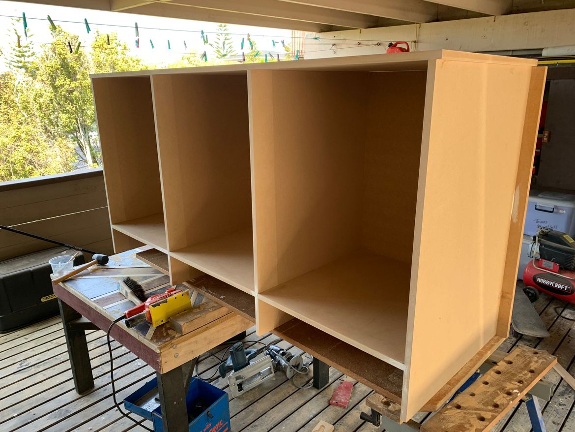

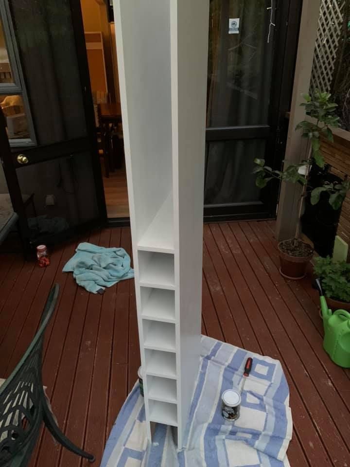

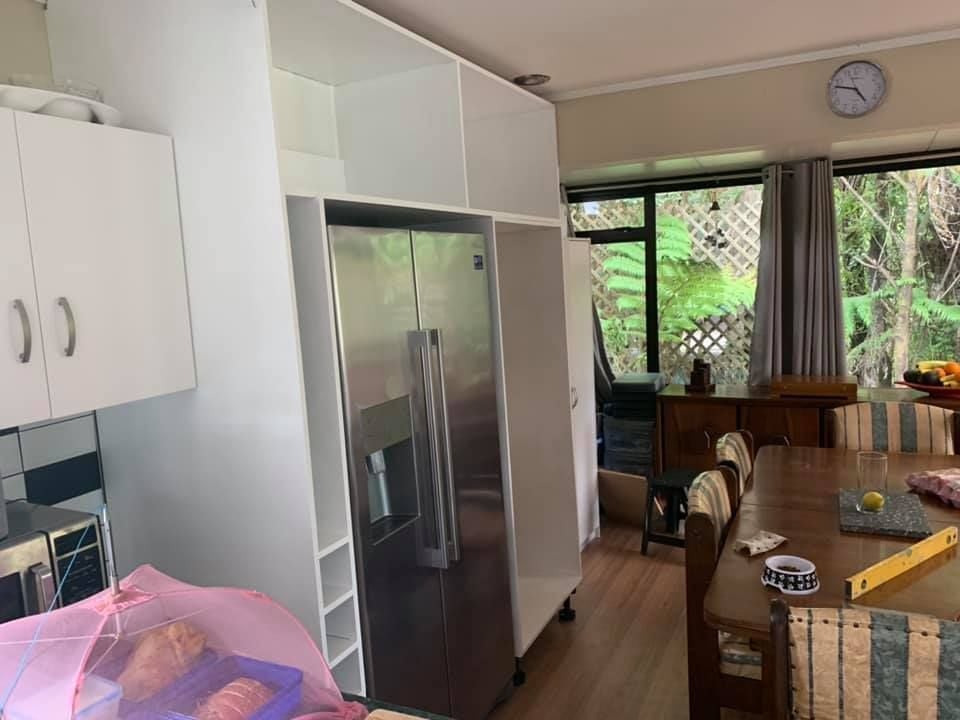

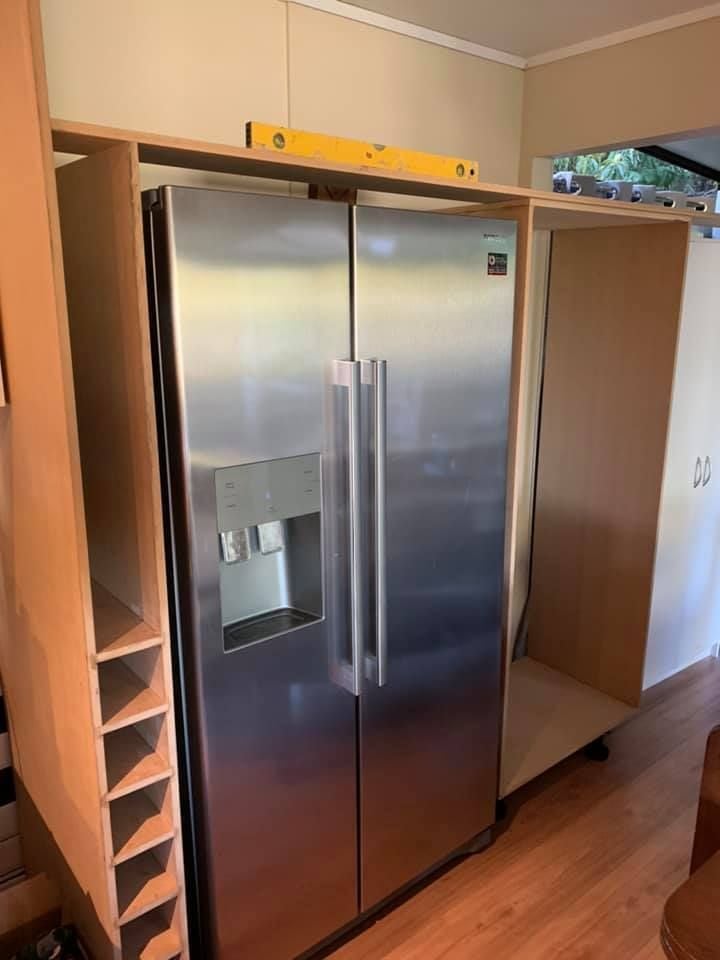

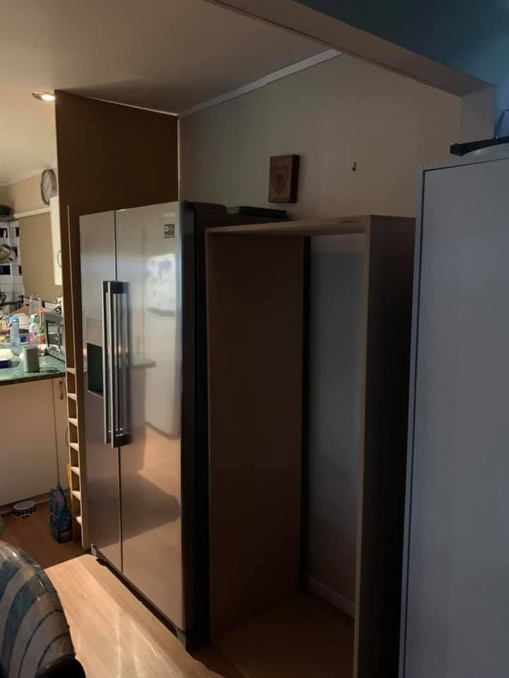

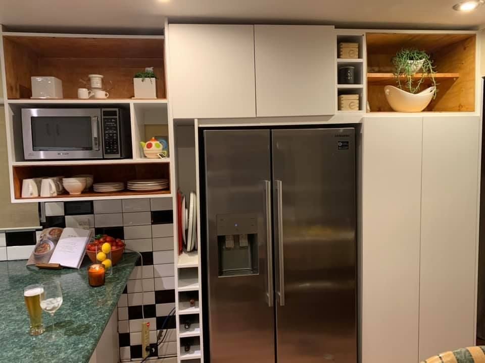

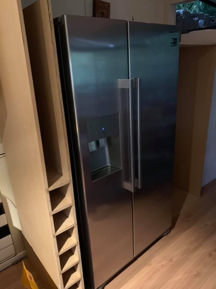

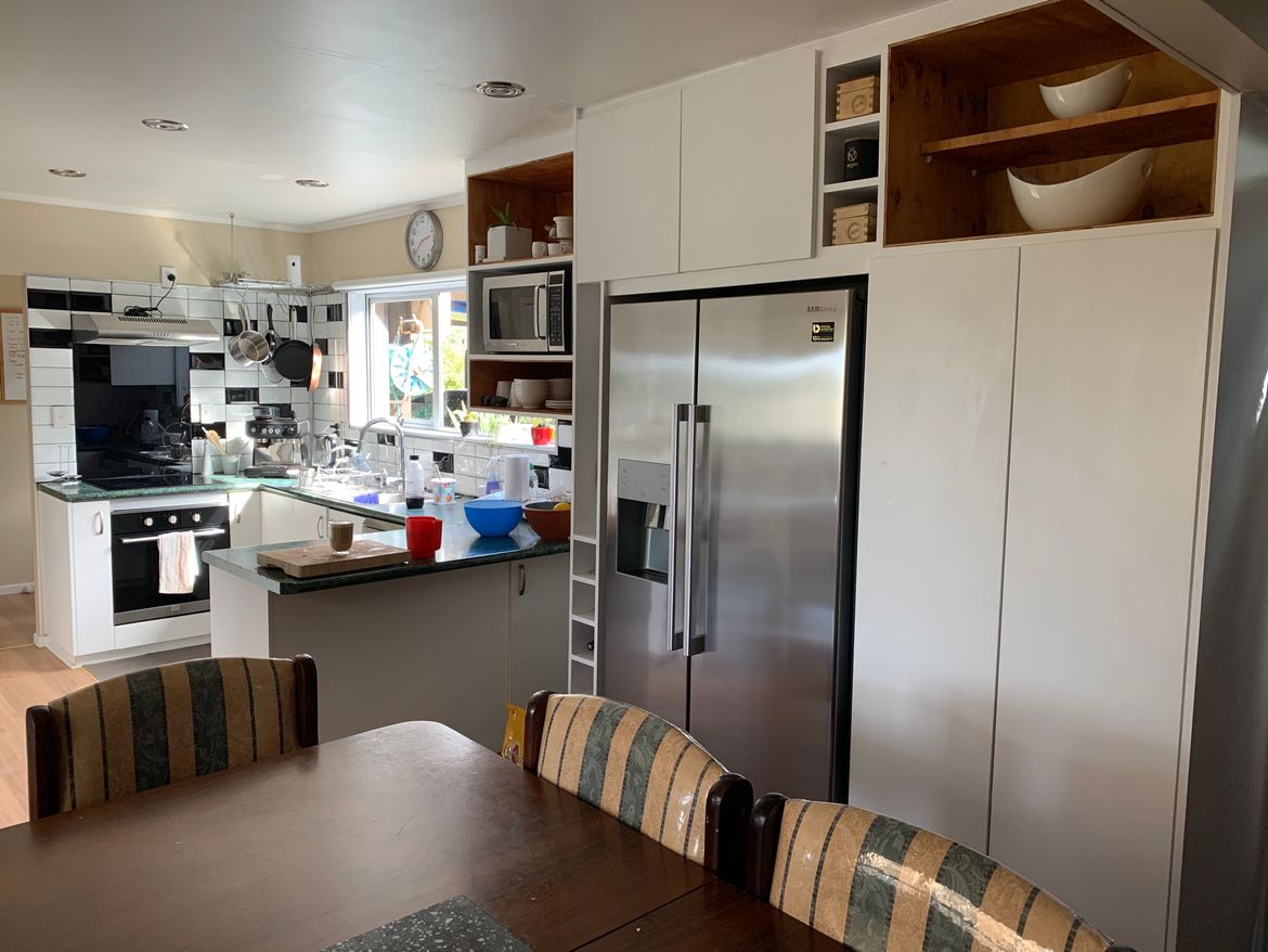

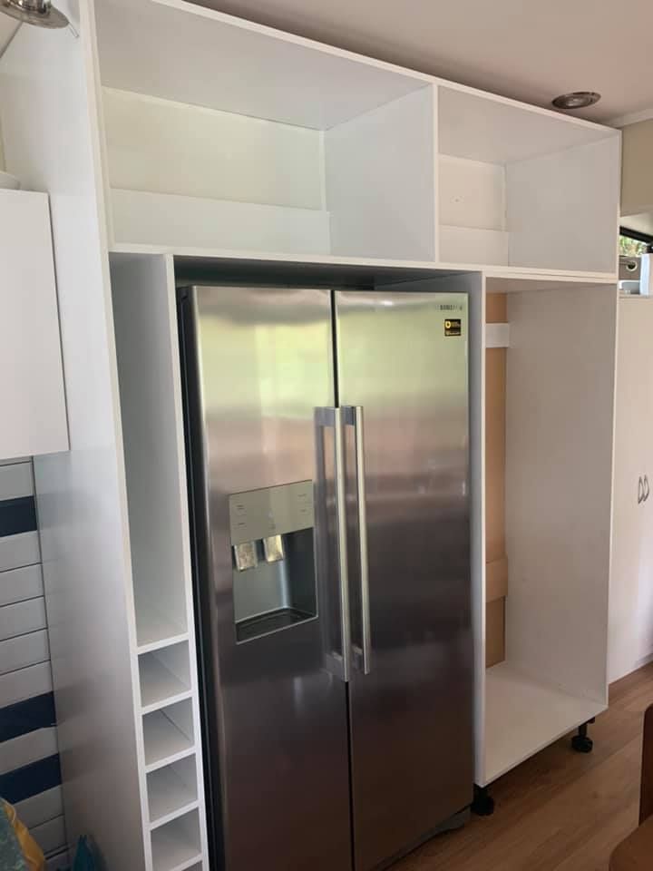

Fridge cabinet
The first job was to build the cabinet to house the fridge, incorporating a wine rack on the side.
The carcasses are all glued and biscuit jointed. The wine rack was made using routered grooves in the side panels.

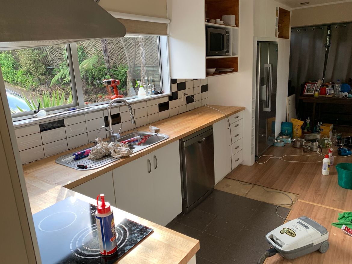

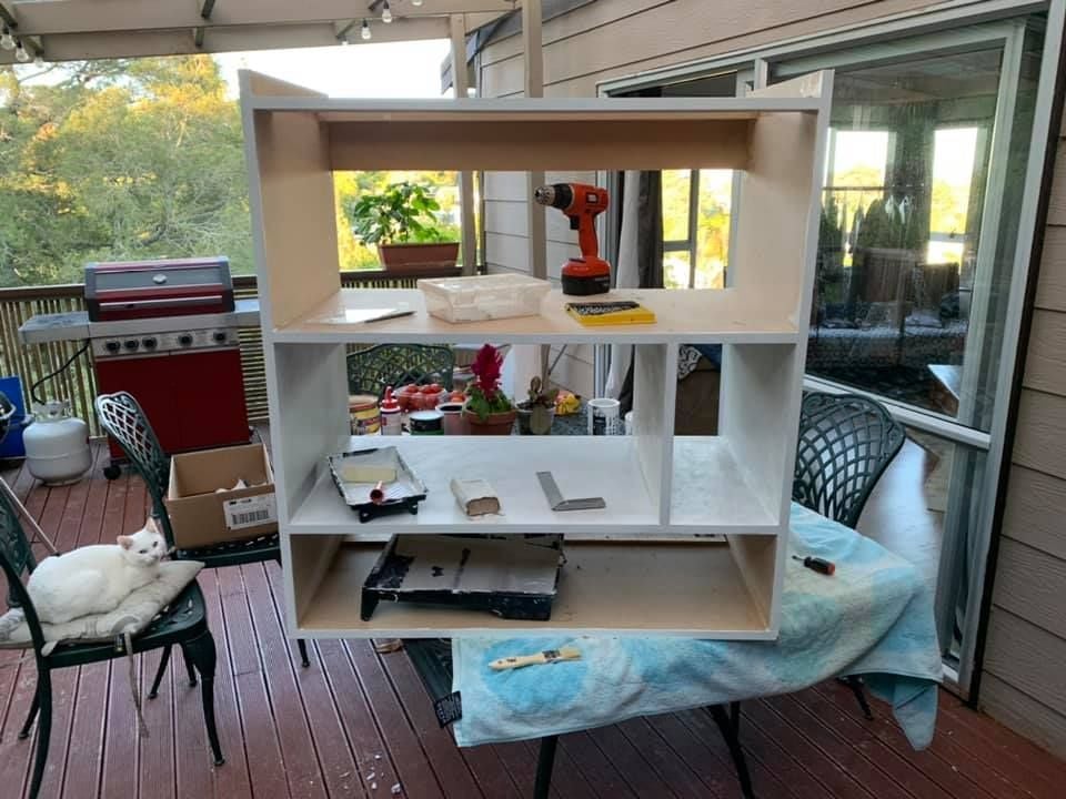

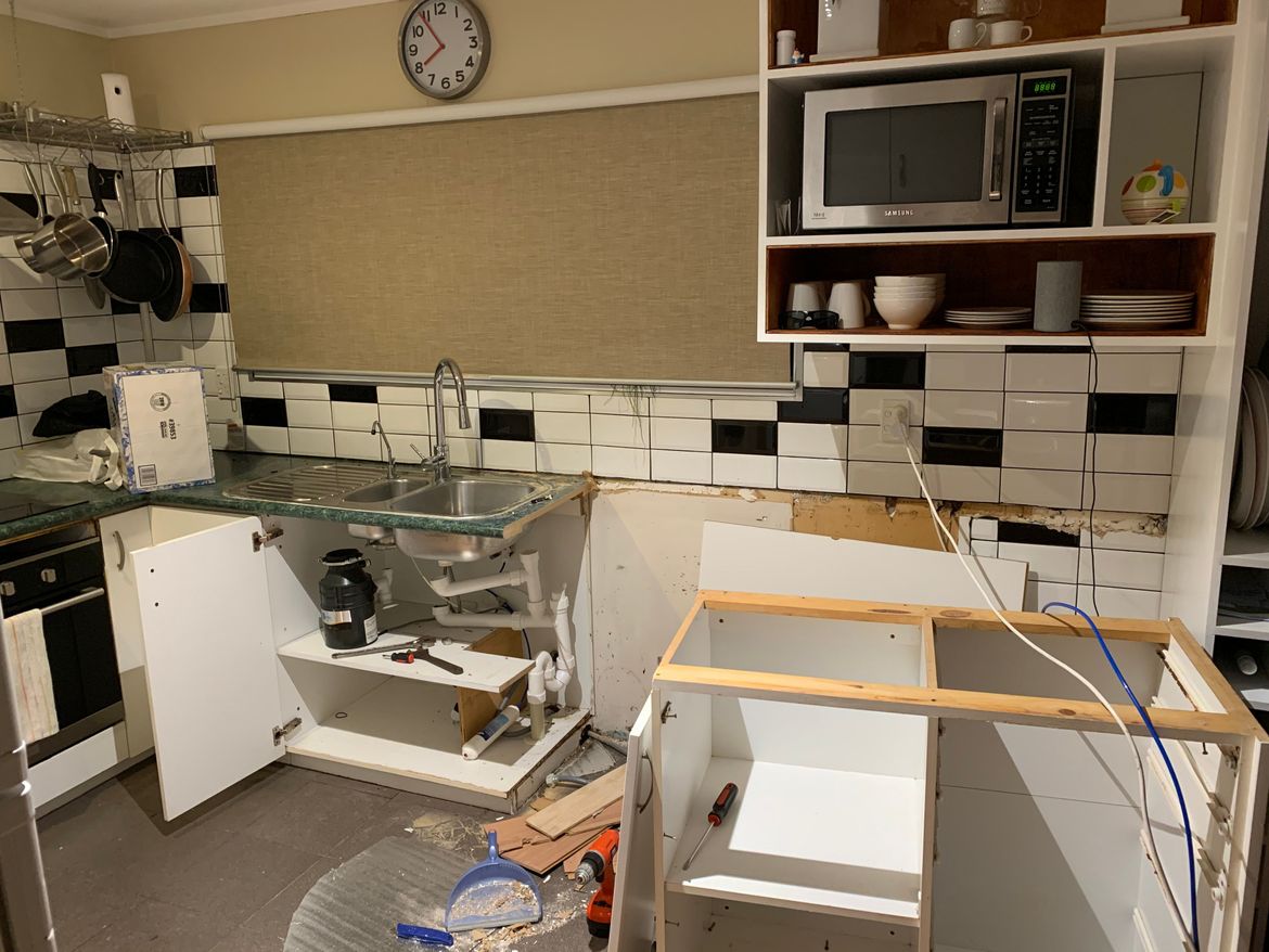

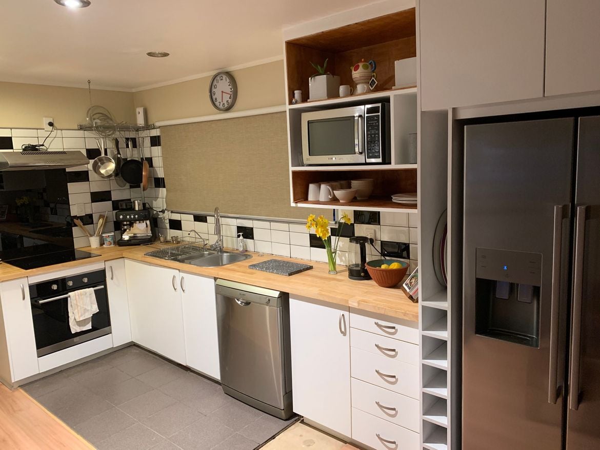

Microwave cupboard

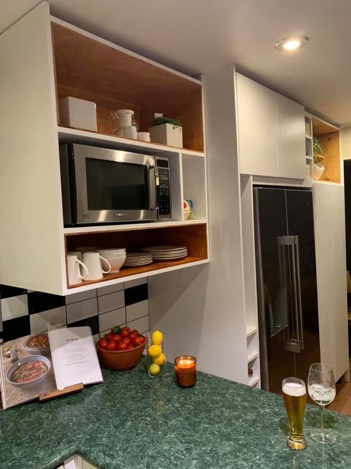

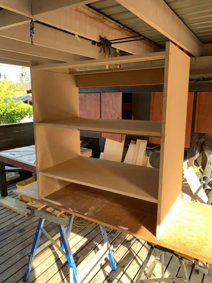

I also wanted a cupboard to get the microwave off the countertop and save some bench and cupboard space.
Again I did the frame with biscuit joints and glue. The shelves in the middle were fixed using routered grooves and glue.
I lined the open cupboards with some plywood sheets and varnished them to try to break up the white a bit.

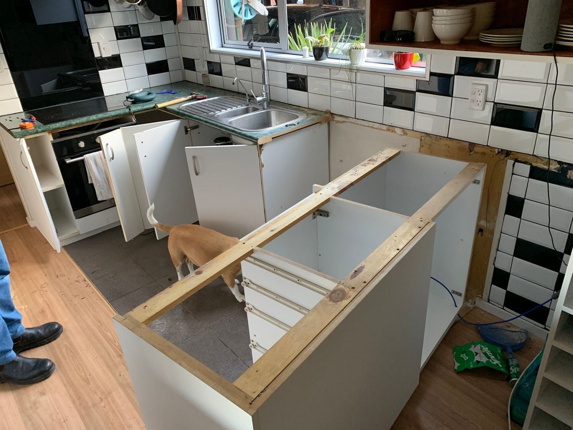

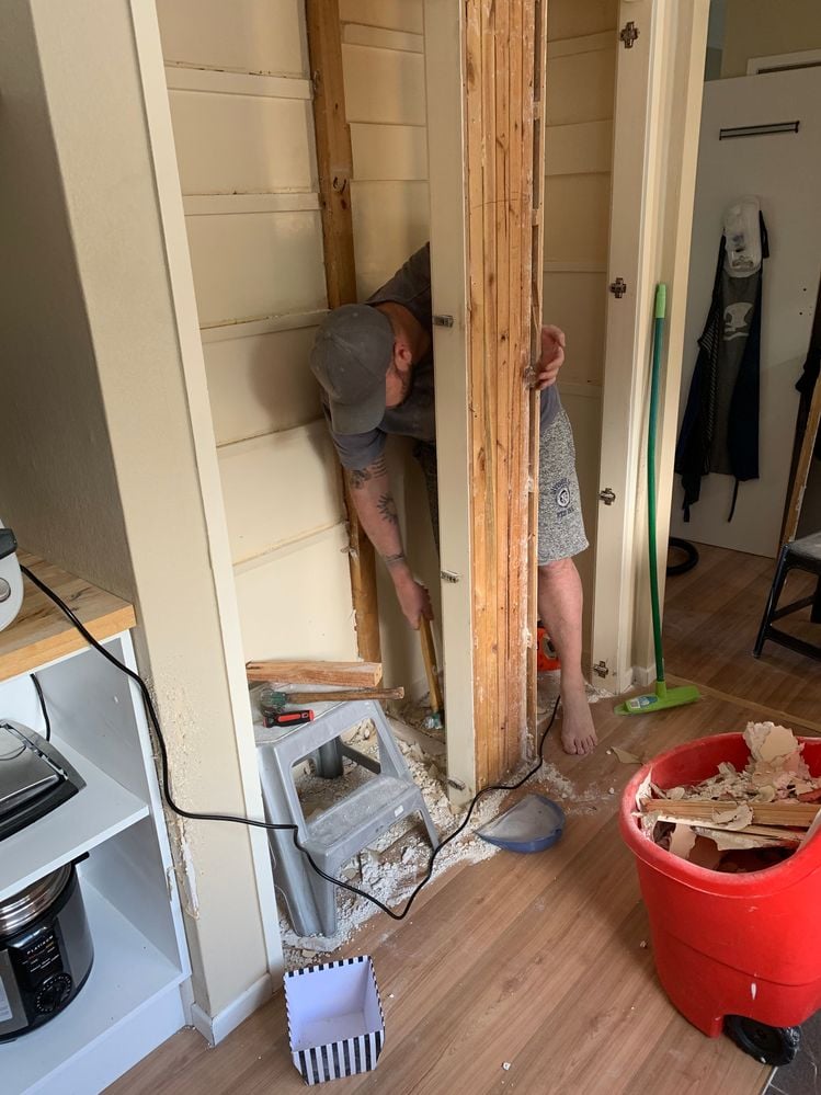

I still didn't like the fridge being outside the kitchen, so we decided that the green bench would need to be removed and the island taken out so it flows better.
New benchtops

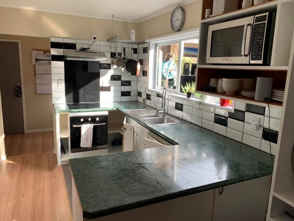

Here is the old bench with the island. The cupboards and drawers under the island I moved around into the gap next to the wine rack. It all fit quite nicely so that worked out well.

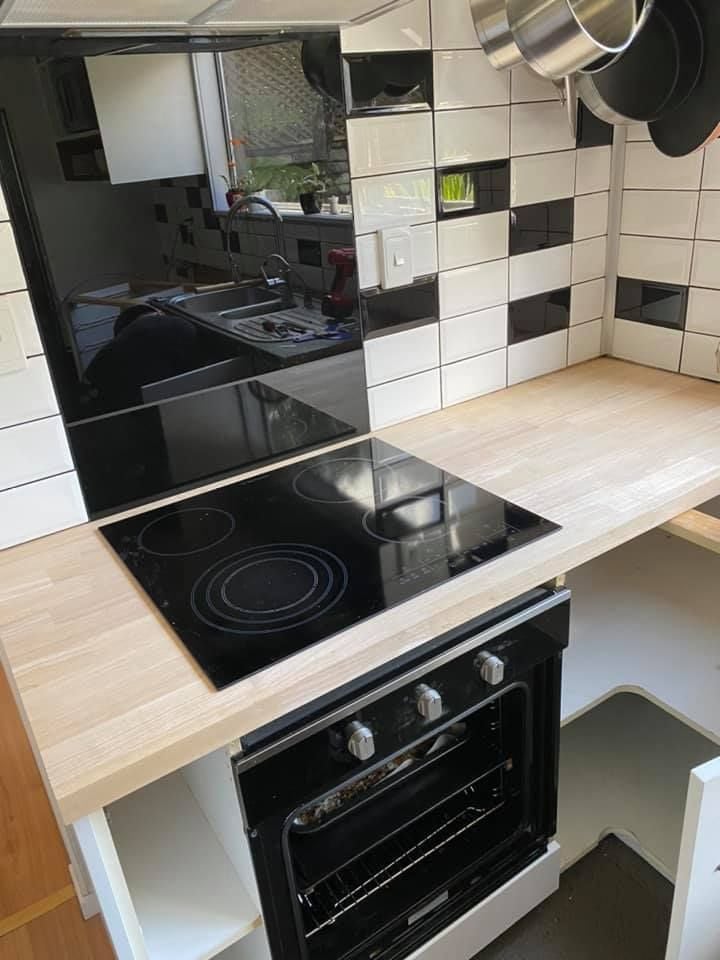

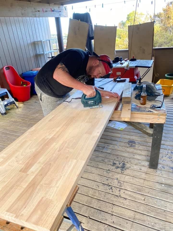

We put in new Kaboodle Hevea benchtops from Bunnings. Here is me cutting out the hole for the sink.
The wood makes the stove stand out quite nicely. This was before treating it with Danish oil.

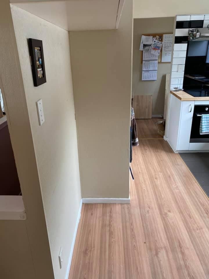

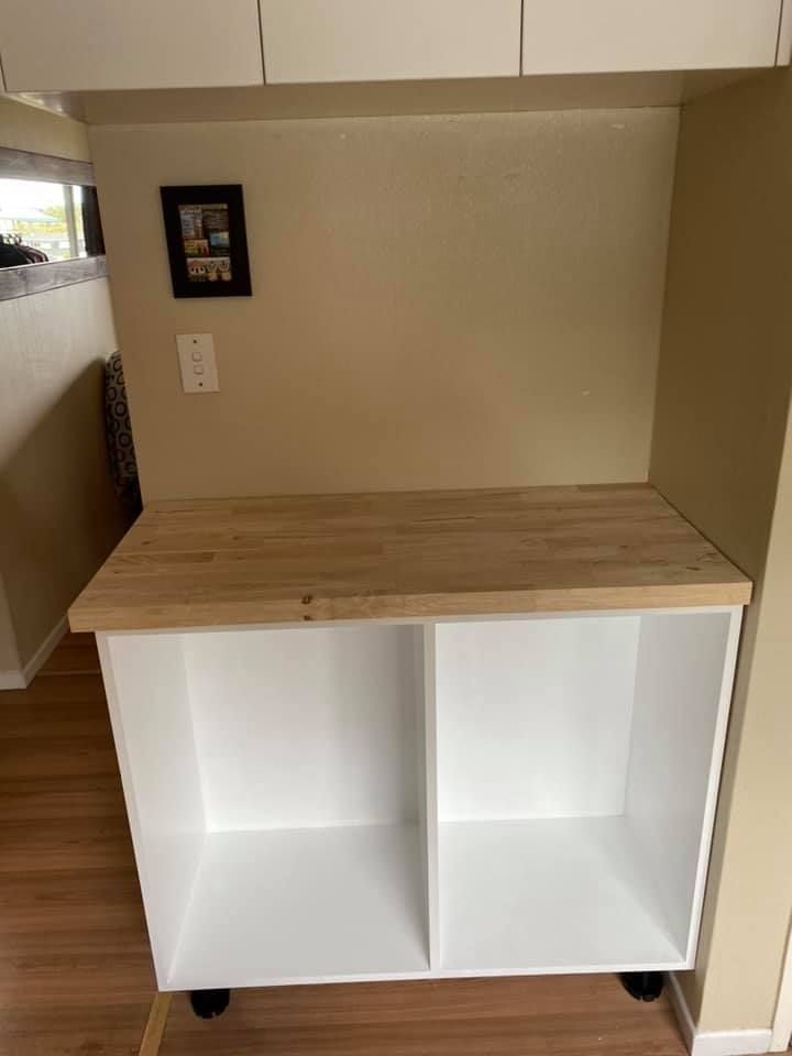

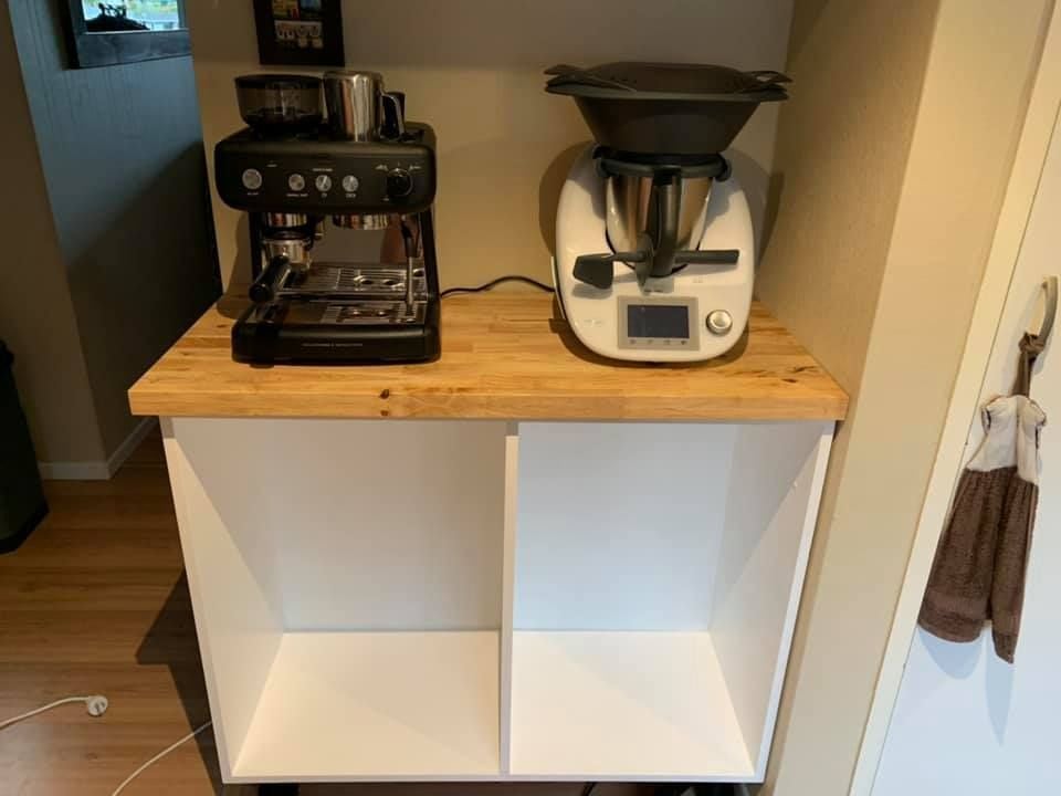

Appliance bench

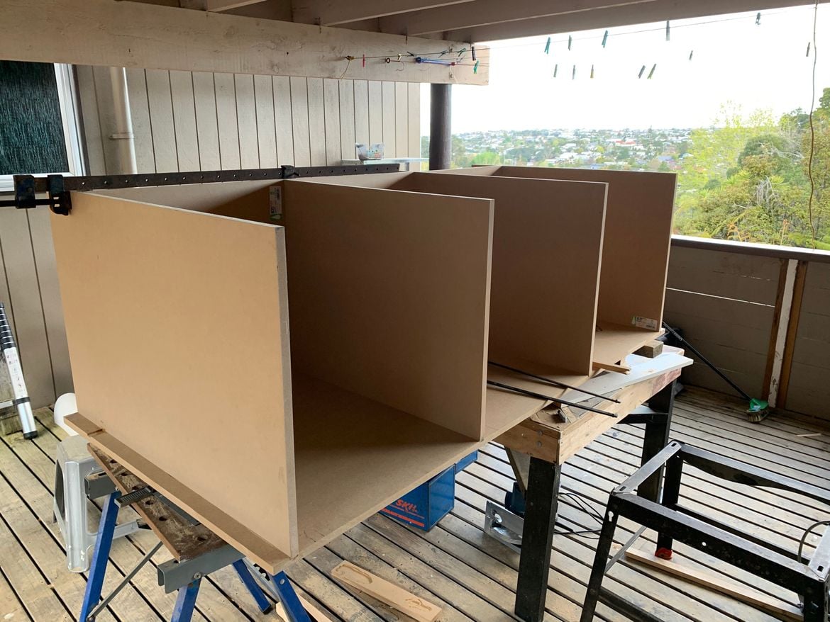

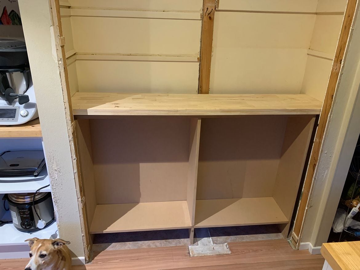

The next part was adding another cupboard and benchtop where the small fridge used to be.
Once again this carcass is biscuit jointed and glued together (using 18mm MDF).
The tops are also Hevea, but I got 18mm boards, not 36mm like the other benchtop.
I wanted to try double up the edges of the top to make it seem like 36mm tops like the other ones. I cut strips out of the Hevea board and glued them to the underside; at the back I just doubled it up with 18mm MDF offcuts because nobody can see it there.
I did this as an experiment in preparation for the new island.
Once again, I think the wooden benchtops look really good with the appliances on them.

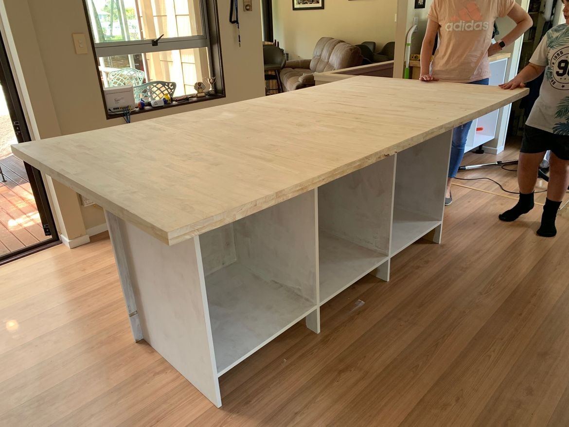

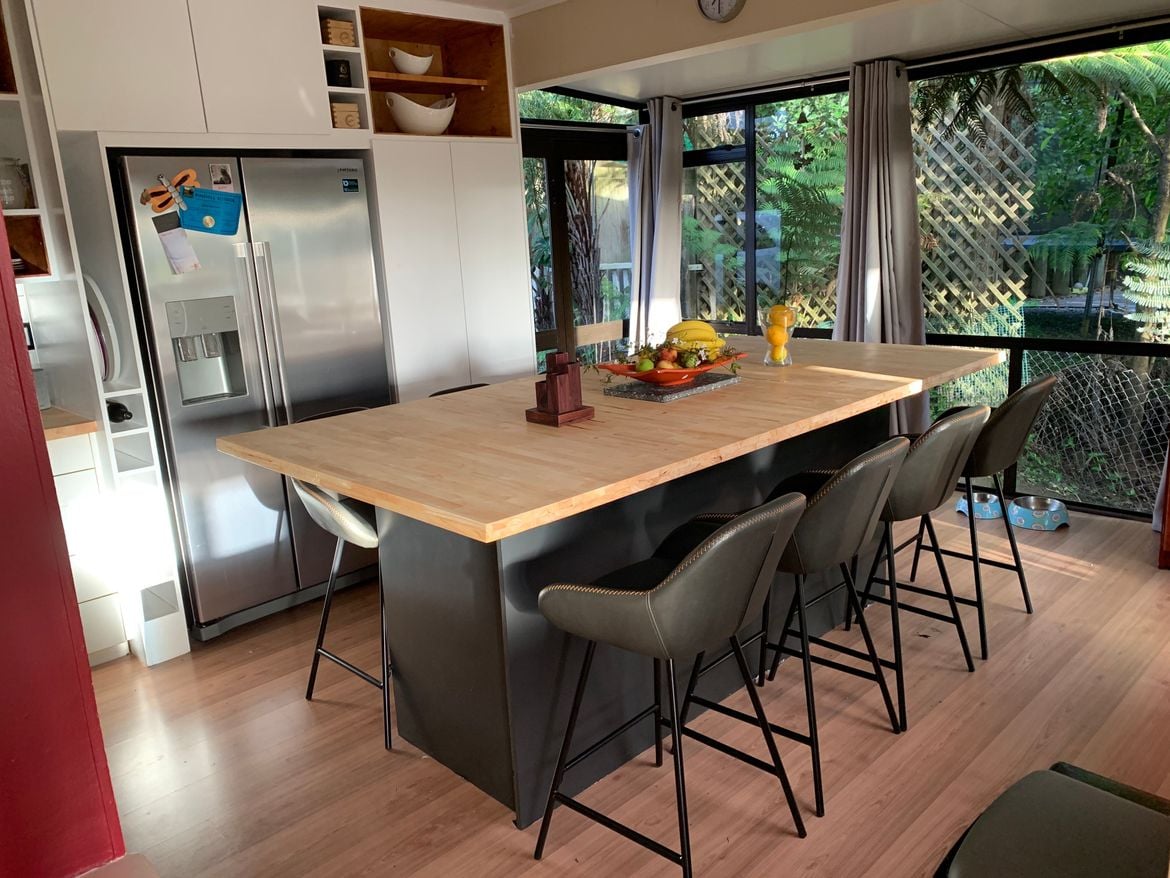

We decided on an oversized island to replace the dining room table and bring the kitchen and dining room together in a comfortable and inviting way.

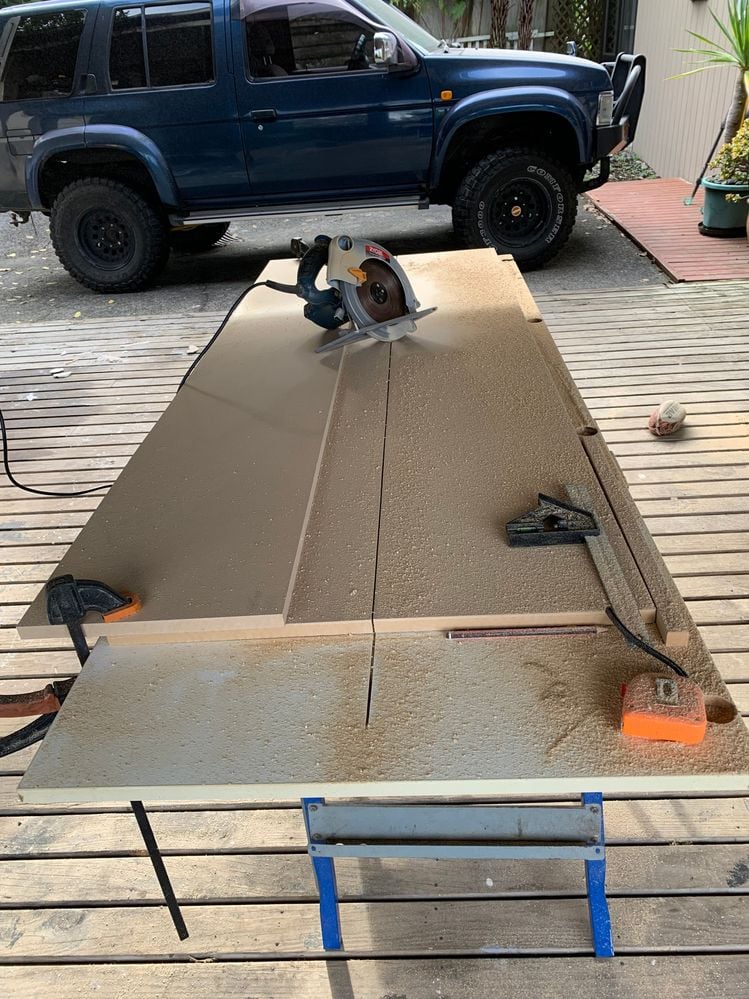

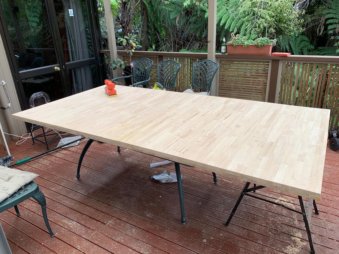

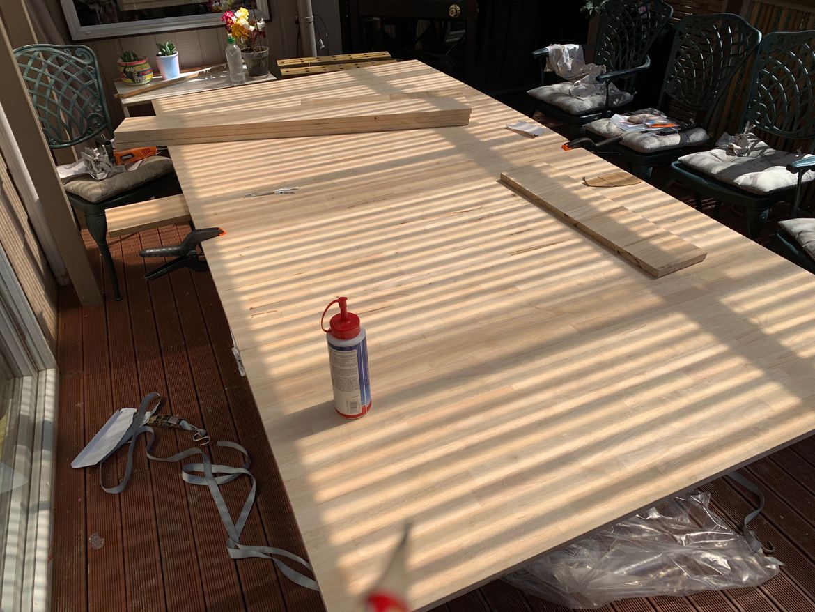

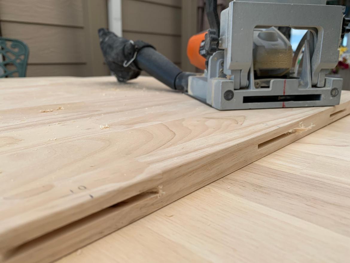

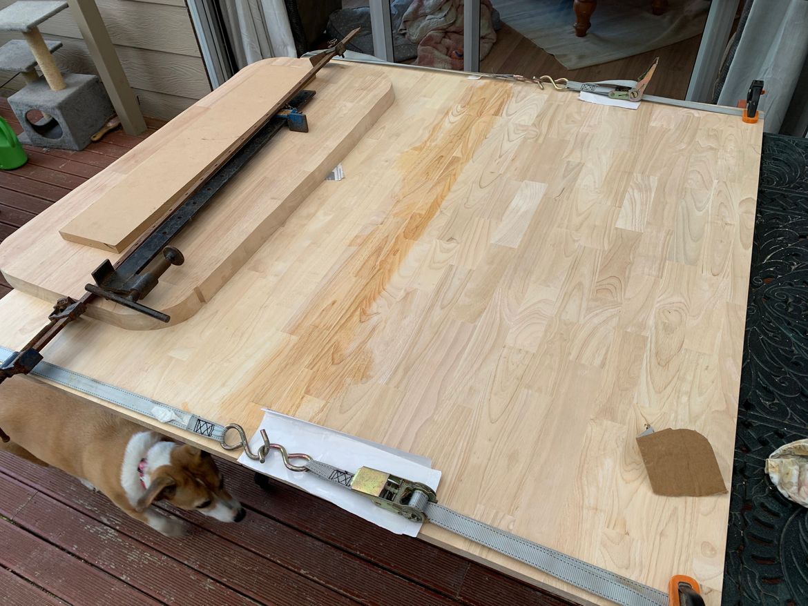

The island ended up being 2.4m x 1.2m. I bought some 1.2m x 600mm Hevea boards from Bunnings, got the biscuit joiner out and put four boards together.
The boards were only 18mm thick so I doubled them up on the edges. I also added some aluminum bracing underneath to prevent it from bending because there is a lot of play on boards this size.

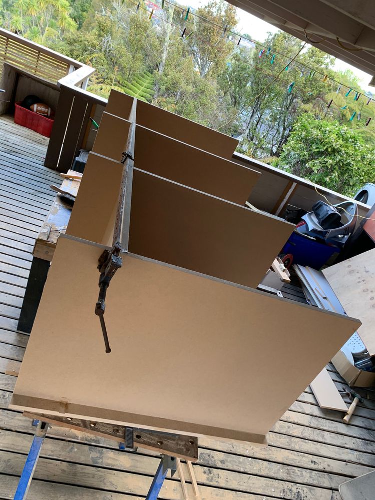

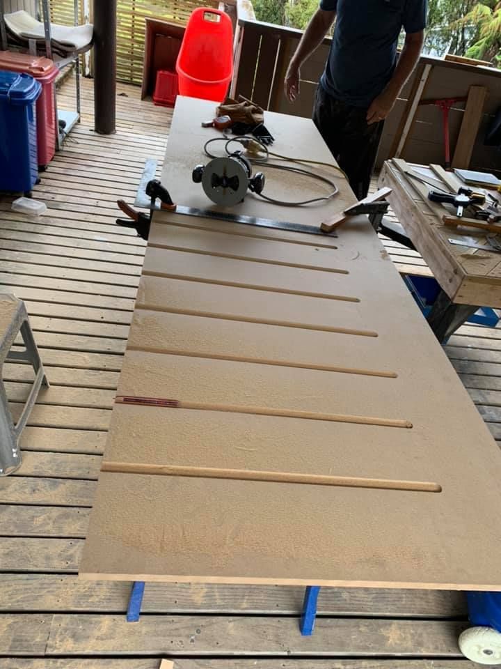

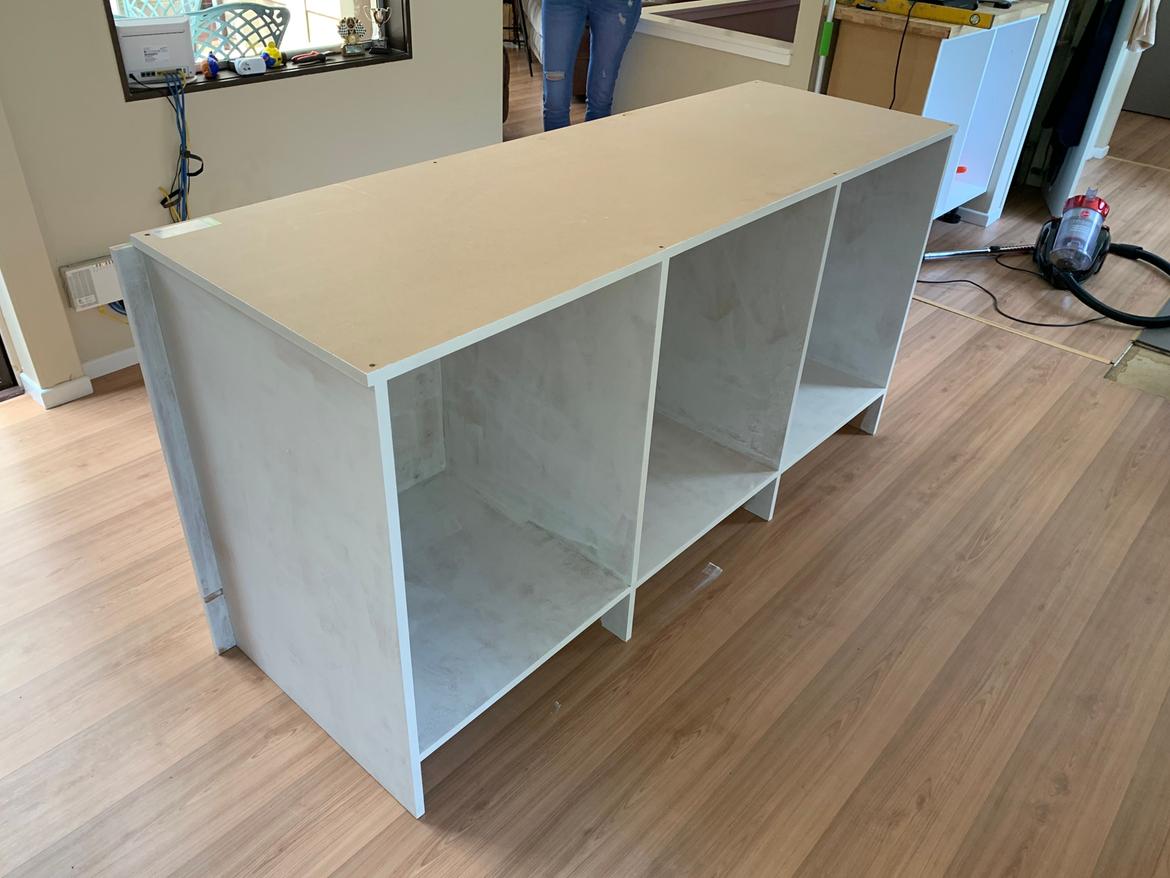

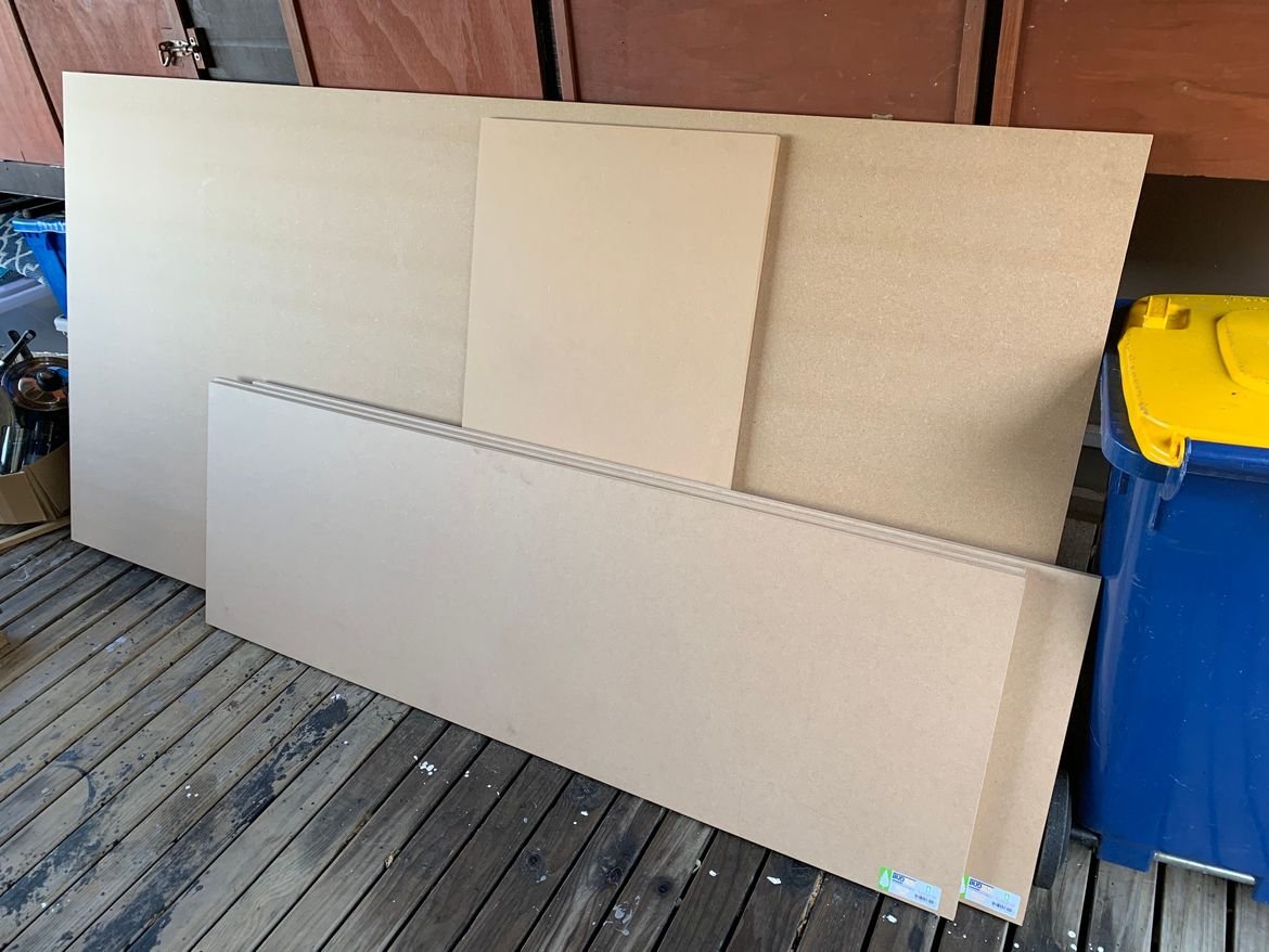

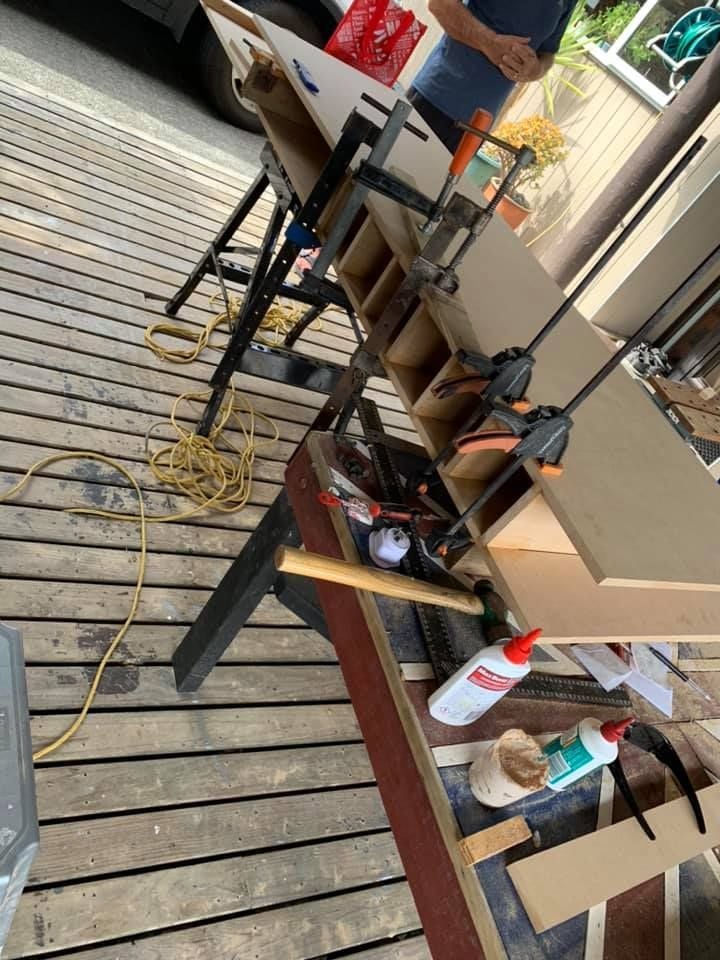

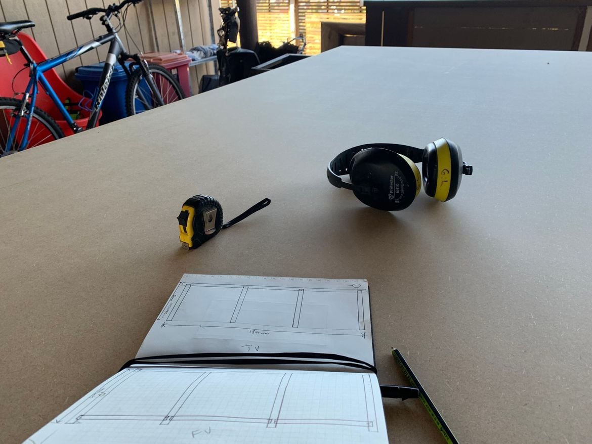

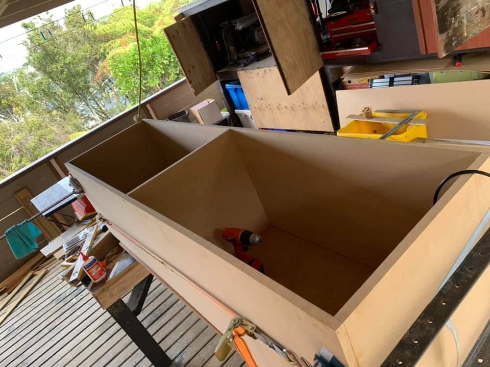

Then it was onto the carcass. I put the plans on paper and worked out how much MDF I needed, managing to cut correctly to use the offcuts too.

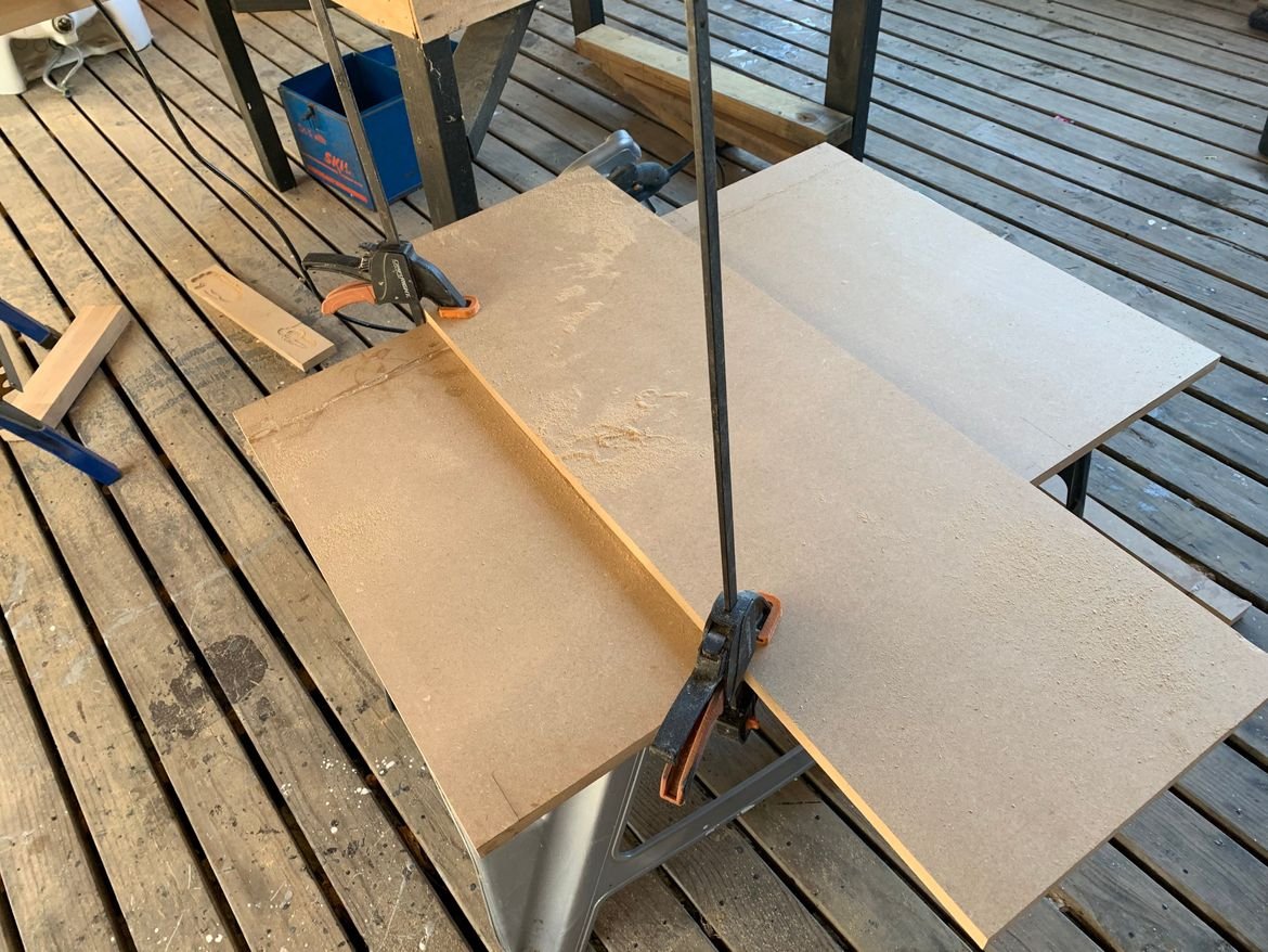

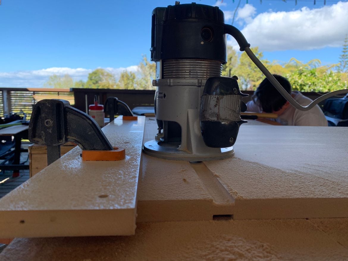

I decided to router the backing board and uprights so the whole thing comes together like a puzzle. Doing it this way really made it strong and required minimal clamping when it came to gluing.
The whole carcass is glued in the grooves I cut with the router. I didn't need to use any biscuits or screws, except for the top board, which I added for structural strength and to screw the Hevea top to.
Bringing the top in. I put screws in from underneath to fasten it.
It's amazing what you can do in a kitchen if you learn to make carcasses. It opened up a whole world of opportunity and saved me heaps of cash.

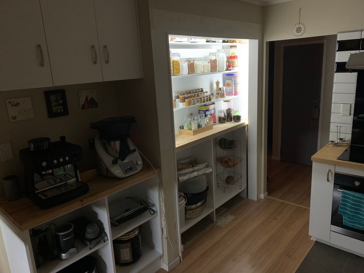

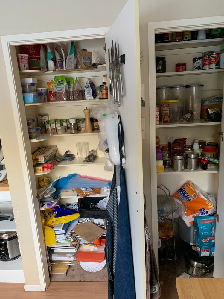

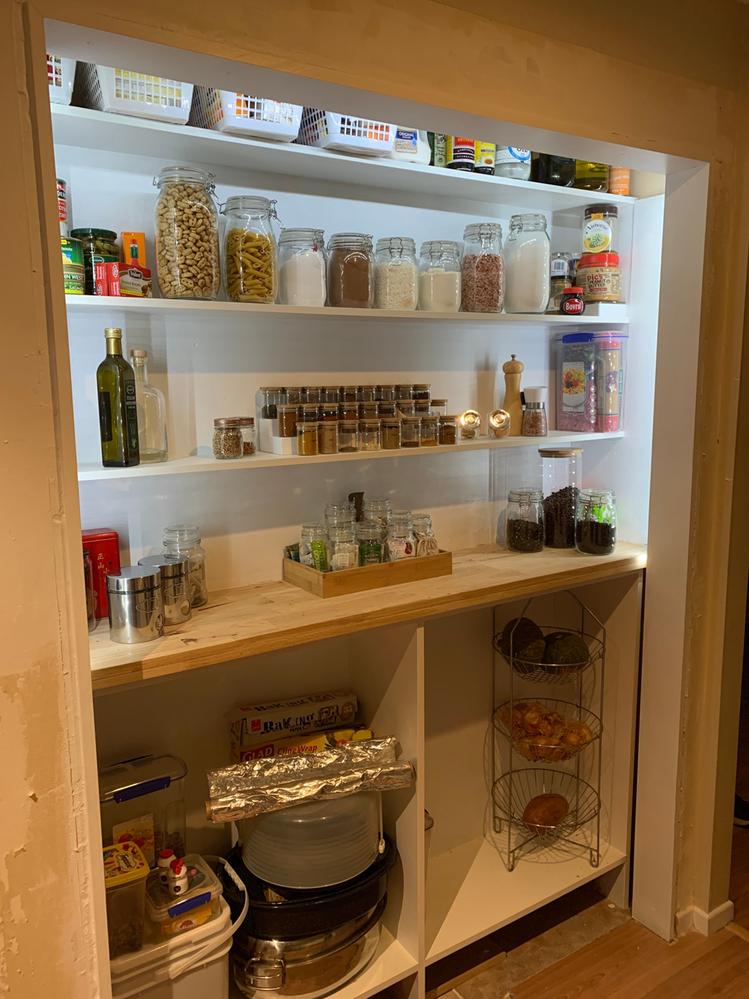

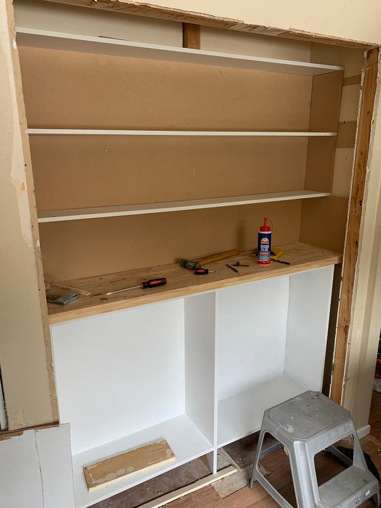

Pantry

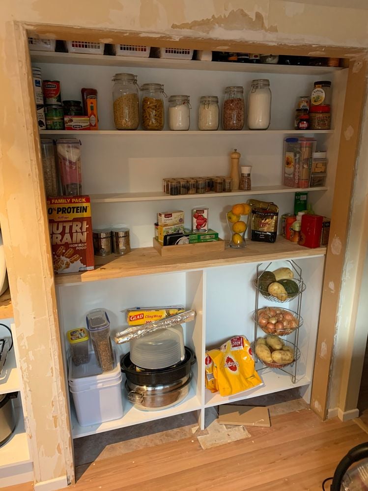

Next up was the pantry. Here it is before:
During.
More during.
When the pantry was finished I had some fun with battery-powered LED strips from Bunnings. I changed them to be powered and controlled by a Raspberry Pi computer for schedules, Wi-Fi and so on.
