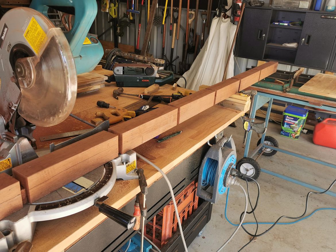

I used an old piece of Jarrah that I found lying in a backyard of a house we cleaned up. I ran the plane over it to tidy it up, then I bought some panels from Bunnings for the shelves.

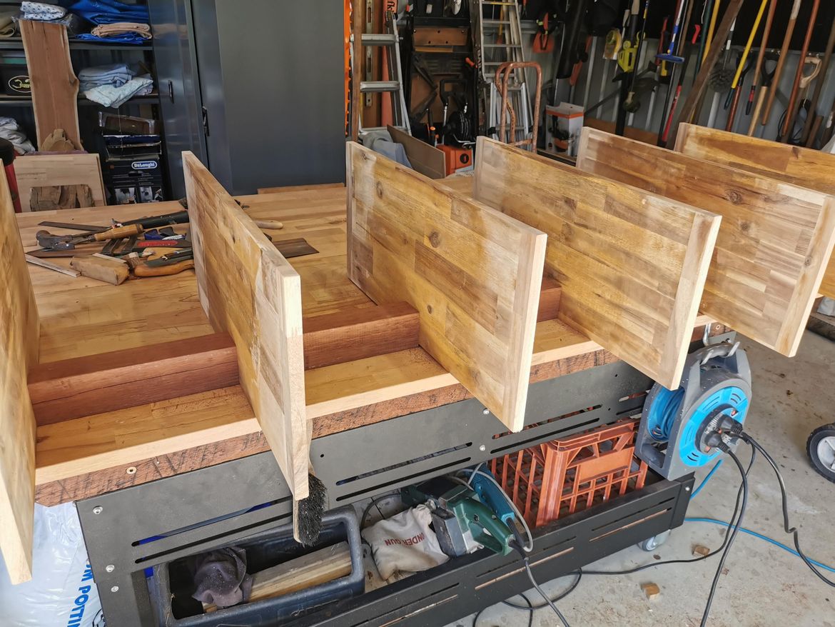

I used the drop saw to cut the trenches for the shelves – lots of small cuts then a chisel to tidy up. I did measure each cut against each shelf as the panels are not always the exact same thickness

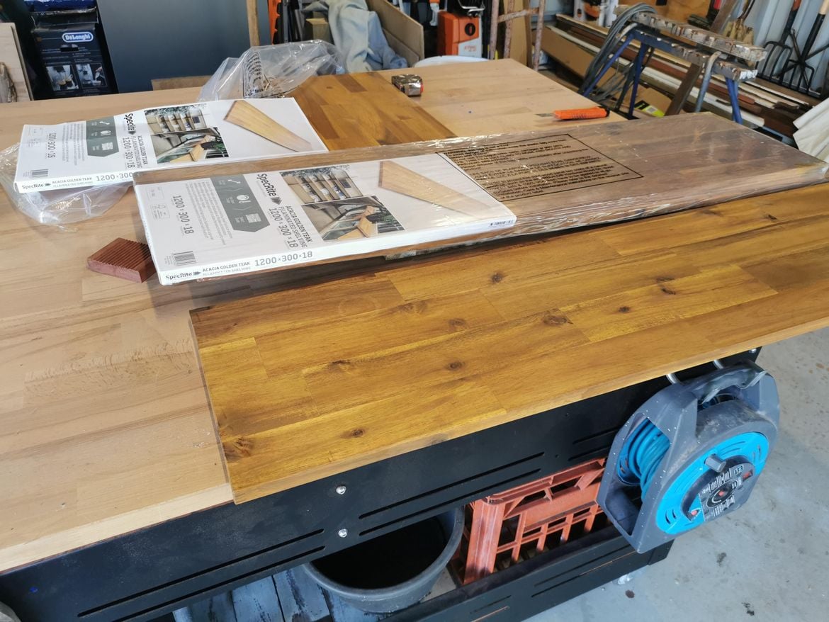

SpecRite Acacia Golden Teak panels from Bunnings.

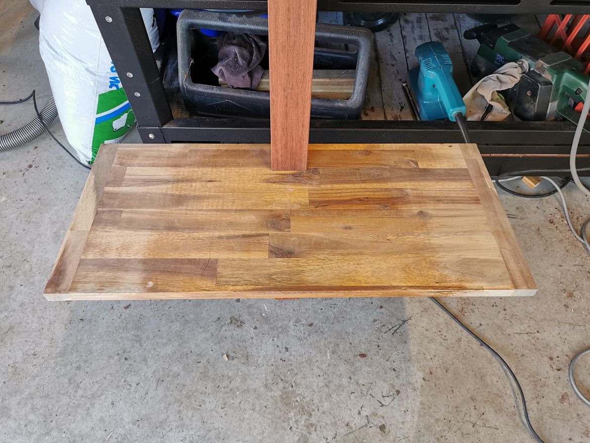

I cut some strips off and glued them to the ends with biscuits to keep them from bowing.

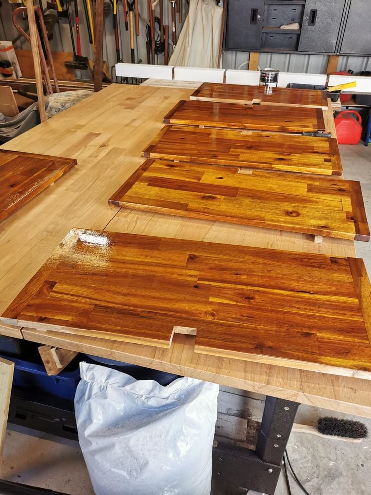

Teak finish applied.
Test fit.
Another test.

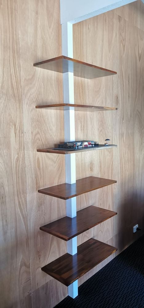

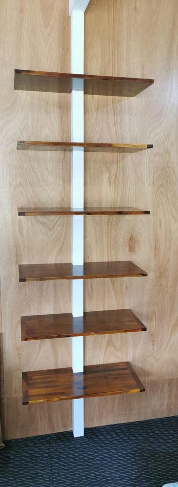

Finished product attached to the wall.
Required staging.
I did make a small mistake in not allowing for the thickness of the Teak finish of the shelves. The finish required removing with a very sharp blade so they would slide all the way in!
