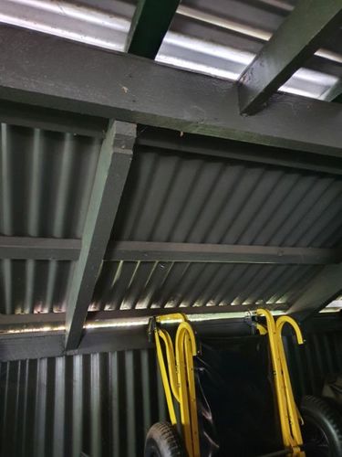

For me I'd use corrugated iron - well, I know I would, cause I did it. 😁

That's a very interesting topic Mike. When we bought our house there was a semi-dilapidated pergola out the back with wood members that stretched to the boundary fence. My assumption was if our solicitor OK'd the property - then everything was above board. Covering this was very ugly plastic shade 'cloth' over an equally ugly fern area.
Years later I ripped up the ferns and laid concrete. With that done my thoughts turned to removing the shade cloth and covering in the whole area.
So I discussed my thoughts with my neighbours and they were happy for me put corrugated iron over this section - so I did. Now a weatherproof storage area.
