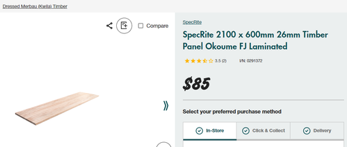

I purchased laminated timber from Bunnings
Specrite Laminated panel Okoume FJ Laminated

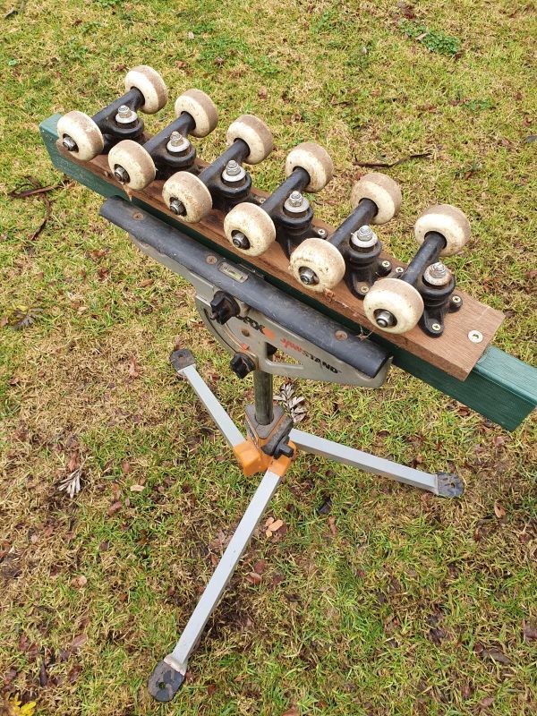

My 'problem' (I have many!) is I work outside and nothing is level. So I investigated many gigs and rigs that would accompany my table saw to support large pieces to cut. Probably the one that worked best (especially with the band saw) was this...
Roller-skate wheels that fitted into a support that can be raised/lowered and the best part - tilted. And almost friction-less...
Odd- but it does work!
