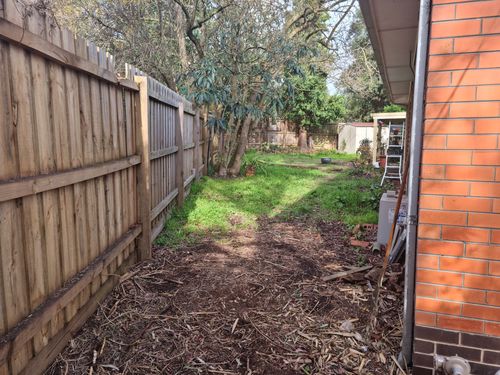

I'd like to build a side gate for my yard but I've no idea how to anchor the post on non compacted soil and keep it straight. I'm considering a picket gate, so it shouldn't be too heavy.
Is this an easy diy job or should I leave this to the experts?

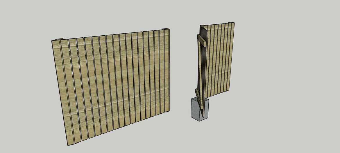

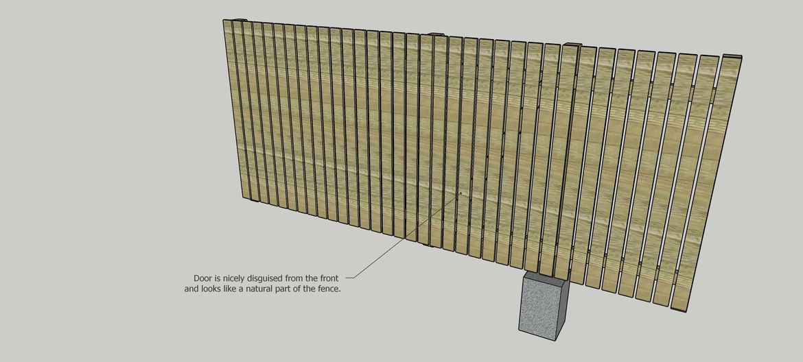

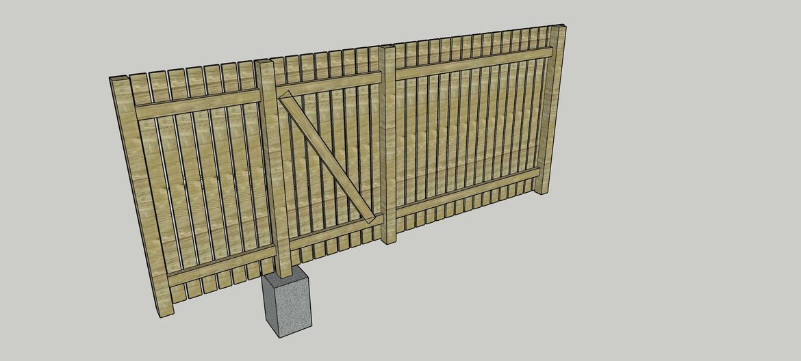

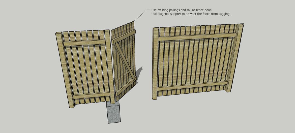

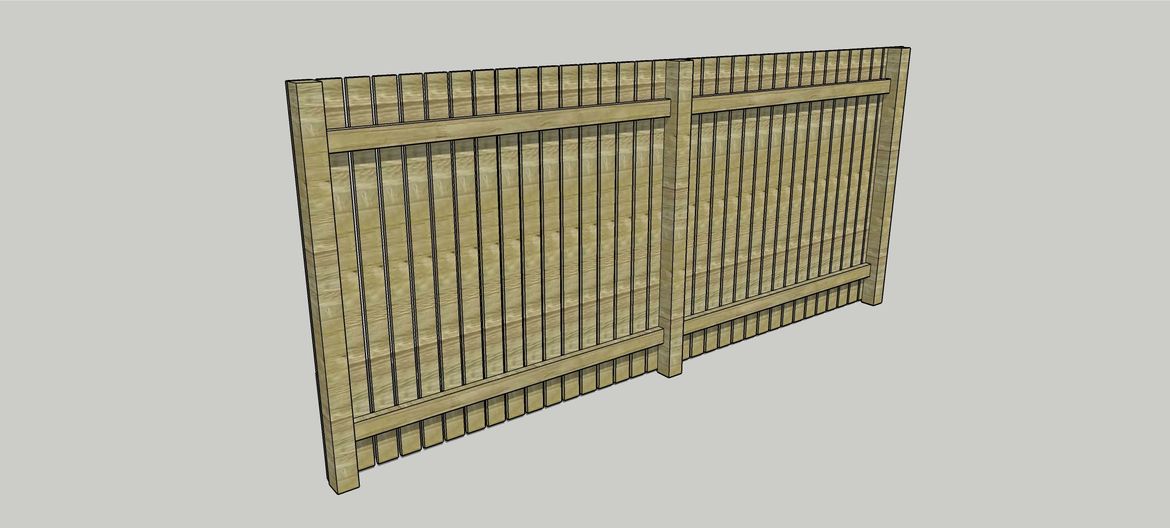

My apologies for the miscommunication, if you are going across from your gate to your house, I recommend mounting another post so that it is well supported and independent of the gate and your house wall. In this manner, no weight is applied to either side and preventing it from getting damaged. I've placed an image below to give you an idea of how you can go across with the same technique.
Please have a look at the sample sketch below and tell me what you think.

Thanks for the prompt reply Eric and the drawings as well. How can I fix the new fence to the existing fence and the side of my house?

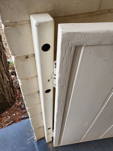

I'm a big fan of steel when it comes to versatility and durability so I would adopt Eric's thoughts but for me I'd mount a steel post to the brick wall for the hinged side of the gate. Small hole-saw openings for the bolts to attach to the brick and once in place it's an open canvas for ideas to attach the wooden gate.

@EricL 's solution is solid and should give you some consistency with your current fencing. Fixing the new fence to your current fence / house combined with either one (or two) concrete footings should give you a solid gate.
Thanks for sharing your question about putting a side gate in your fence. To give you a bird's eye view of the process, a fence hole needs to be dug out for the new fence post to be put in. The post is then placed into the hole and concrete is poured in to hold it in place. This new post is then connected to your existing fence line. The rails need to be cut and connected to the new post. The fence in between the posts will now serve as the gate for your fence.
