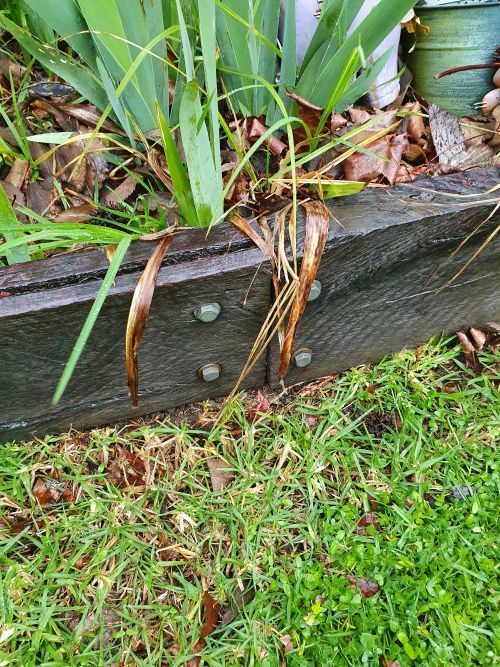

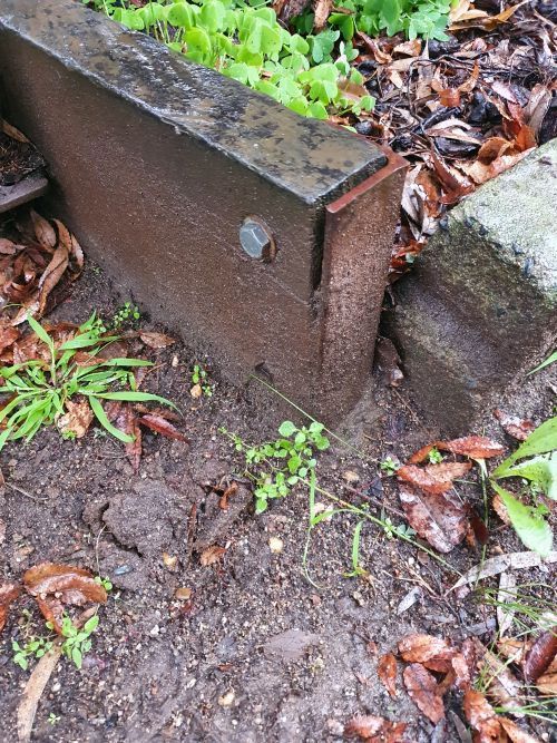

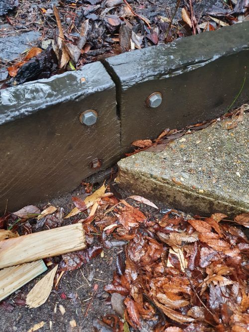

My sleeper garden walls I built 40 years ago are succumbing to dry rot despite all the Creosote and Copper Arsenic Paint that was applied at the time. After 40 years I guess I can't complain. I have investigated reconstituted limestone and concrete wall alternatives but, I guess due to the current high demand levels in the building industry, I couldn't get any contractor suppliers to respond to my requests for quotes. Therefore I have decided to just replace these sleeper walls with new sleepers (these https://www.bunnings.com.au/200-x-50mm-2-4m-treated-pine-sleeper-h4_p8032702 ) and use Whites Joiner Posts (these https://www.bunnings.com.au/50-x-1500mm-joiner-post-galvanised-steel-retain-it-sleeper-upright_p1101076 ) instead of the 100mm upright sleepers I used last time. I figure if they also last 40 years they'll probably outlive me and/or my residency here. The sleepers have already been delivered, I have the quick set concrete for the posts and i have bought the retaining posts so I thought I was all ready to go. However, while we were loading up my ute with the Whites Joiner Posts, a person claiming to be a tradie who installed garden walls in Perth hills areas, advised my wife while she was going through the Bunnings checkout that I should paint the galvanised posts and the end of the sleepers with bituminous paint to prevent the corrosion of the galvanised posts. The claim is that the copper arsenic used in the H4 treatment causes a galvanic reaction that corrodes the steel in spite of it being galvanised and if unprotected the foot of the posts will rust away within a few years,. Sources like: https://www.researchgate.net/publication/225782648_Corrosion_of_ferrous-_and_zinc-based_materials_in_CCA_ACQ_and_CuAz_timber_preservative_aqueous_solutions and https://www.google.com.au/url?sa=t&rct=j&q=&esrc=s&source=web&cd=&ved=2ahUKEwiSzdKIu4D6AhVh9zgGHZ3xAzsQFnoECHQQAQ&url=https%3A%2F%2Fwww.teampoly.com.au%2Fwp-content%2Fuploads%2F2018%2F05%2FCTB13March2008_Contact_with_Timber.pdf&usg=AOvVaw2Ehv54FnyTL2mOqvDDlDol and https://8pointshome.com/modern-pressure-treated-lumber-corrosive/ do suggest that CCA treated pine might cause corrosion and here http://www.bluescopesteel.com.au/howto/avoid-corrosion-caused-by-contact-with-timber Bluescope Steel advises:
