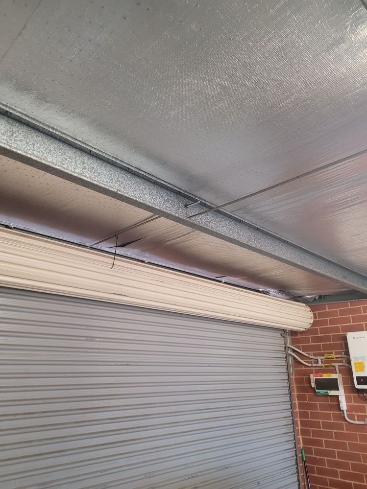

with the intention to hang it from one of the beams in the garage. I asked my neighbour (he built the house) and he said it would hold up easy.
My original plan was to hang a rope/chain/strap over the beam, but upon further inspection, there isn't actually space above the beam to loop anything over.

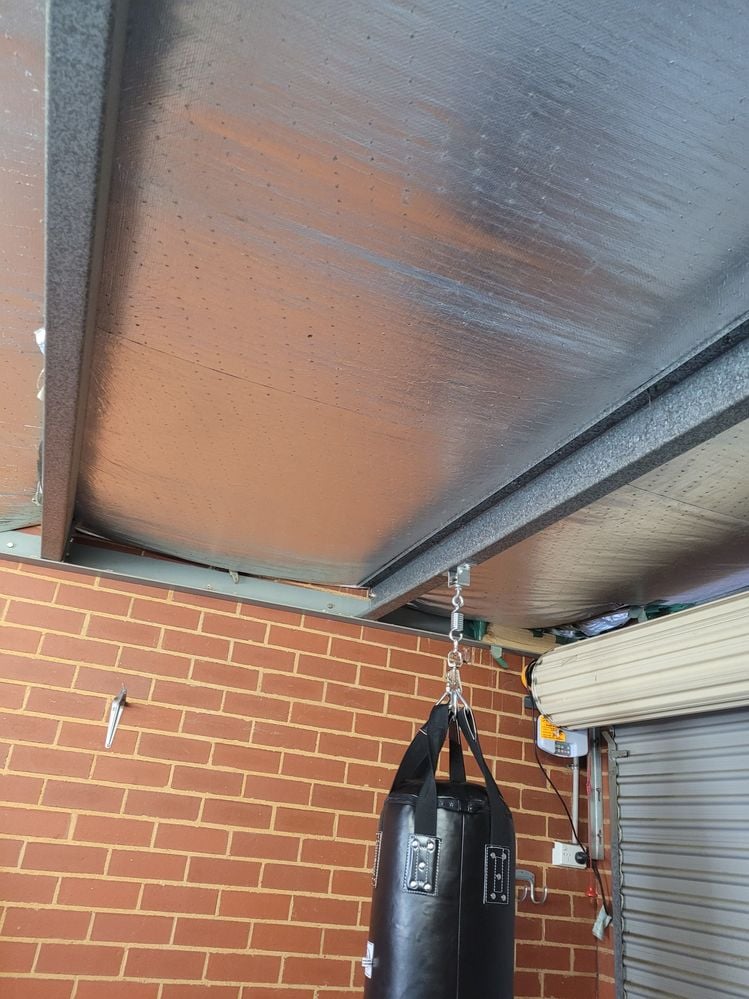

Since then I got a beam hook which has a spring, then a chain (the chain has actually been cut to only one link + hook/swivel to reach the desired height) which goes from the spring to the bag (pictures at bottom).
I believe they are these:
https://www.stingsports.com.au/products/heavy-duty-punch-bag-beam-hook?variant=39780180099236
https://www.stingsports.com.au/collections/hooks-chains/products/installation-chain-and-swivel?variant=39780180787364

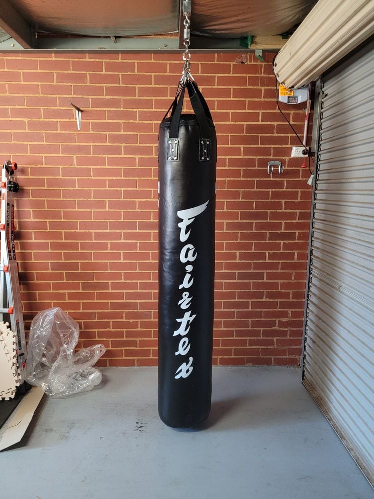

We had a tradie install the beam hook today and help hang the bag, but upon trying it out I'm a bit worried as the beam moves a bit (the bottom of the 'c' at least), even from moderate jabs. According to the website the bag is 60kg as I ordered it pre-filled but I have a feeling it might be lighter - I can weigh it if necessary. I'm only ~70kg so not a monster but I have some experience so can definitely put some power into the bag and jolt/swing it around a bit.
The tradie is coming back and I can ask him what he thinks as well but I wanted some more advice, basically will this be OK in the longterm? I obviously don't want to do any damage to my garage. If not, are there any alternative methods - this was probably the best spot in my house to hang it.
