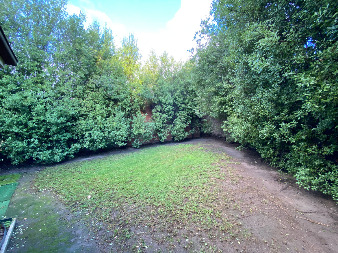

The back corner of the backyard was never used. It mostly grew weeds and was overgrown with tree branches. Then we decided to put in a putting green!

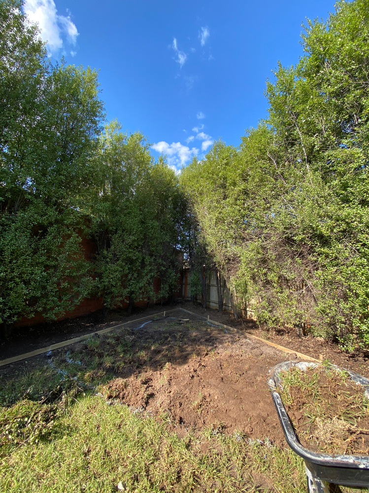

- Started by digging out all the soil and grass to get a level and clean soil surface
- Raked and levelled the ground

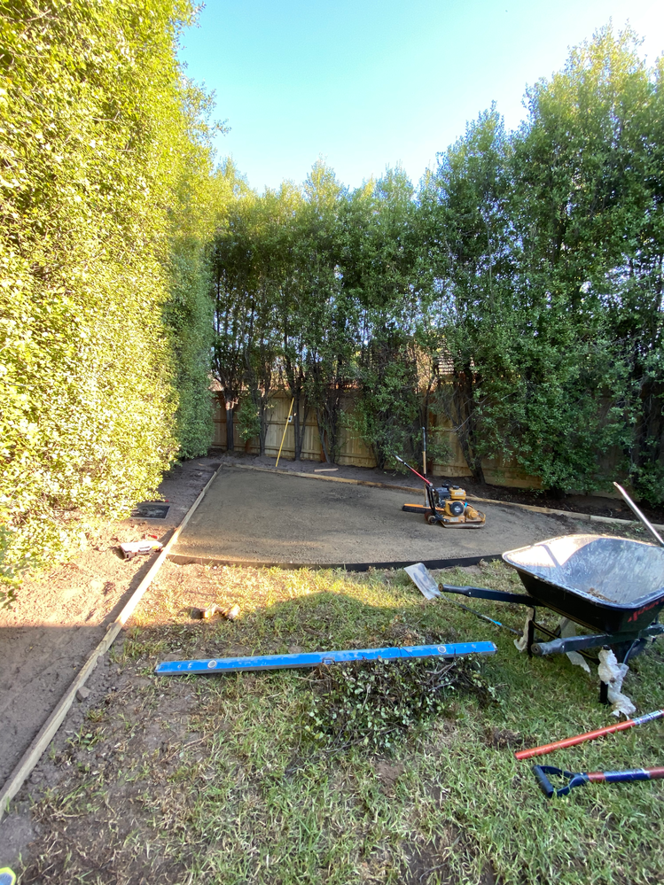

- Rented a compacter from Bunnings and compacted the soil
- Installed the corten steel edging for the area. The edging, purchased from a local steel fabricator, will naturally weather with a rusty look
- Wheelbarrowed in 3 tonnes of road base ordered from a local garden supplier. The two of us simultaneously shovelled each wheelbarrow load, raked and spread it. I think this was the most physically painful and tiring job of our whole house reno!
- Used the compactor to compact the road base. This involved four passes of the area and two hours of compacting to achieve a flat surface

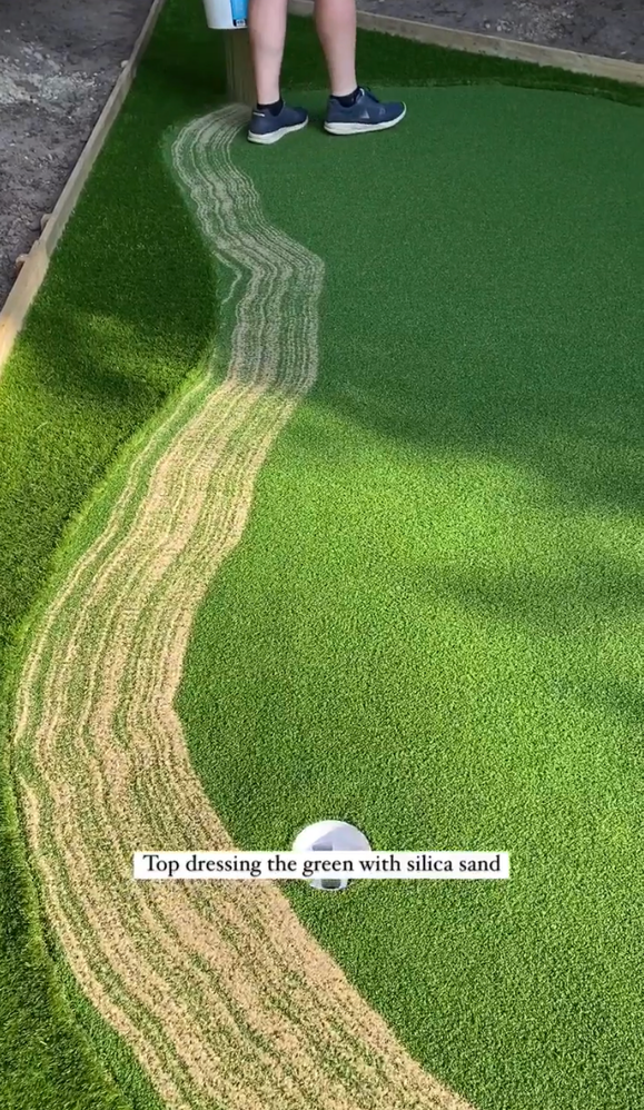

- Top dressed the putting green with silica sand

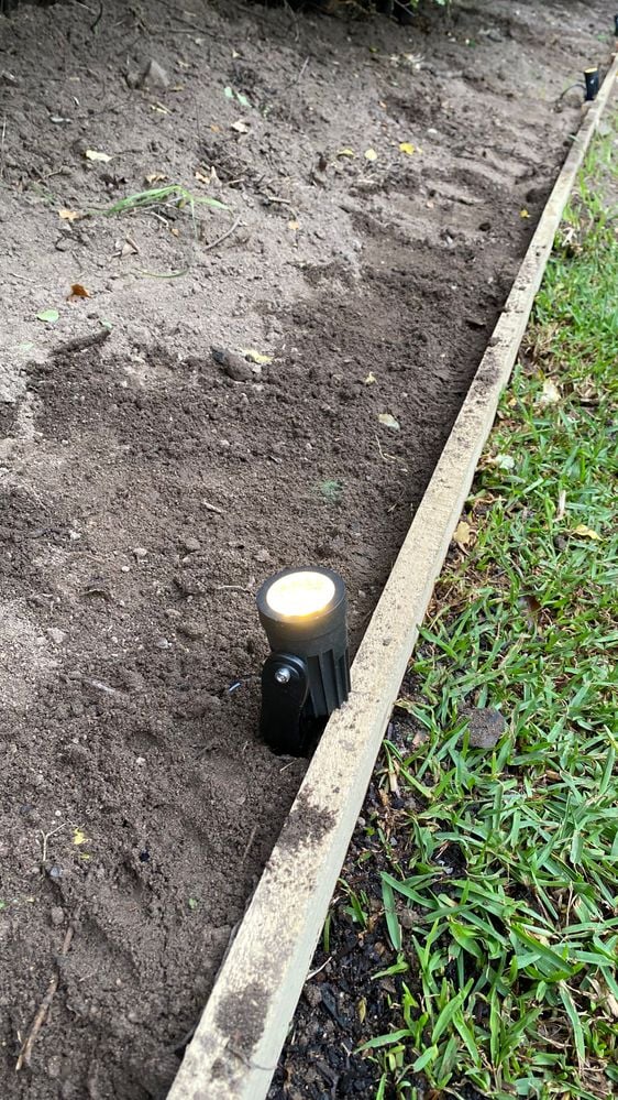

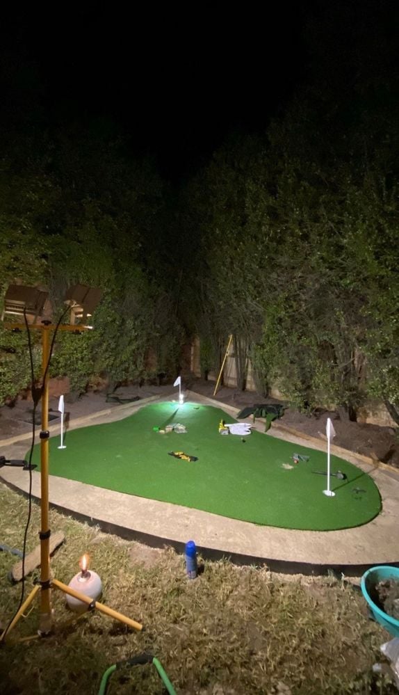

- Ran the wiring and installed eight Holman 43mm Warm White Spotlights from Bunnings around the edging under the Pittosporum trees.
The unused corner of the garden grew little grass and mostly weeds.
We dug out the soil and grass to level out the area.

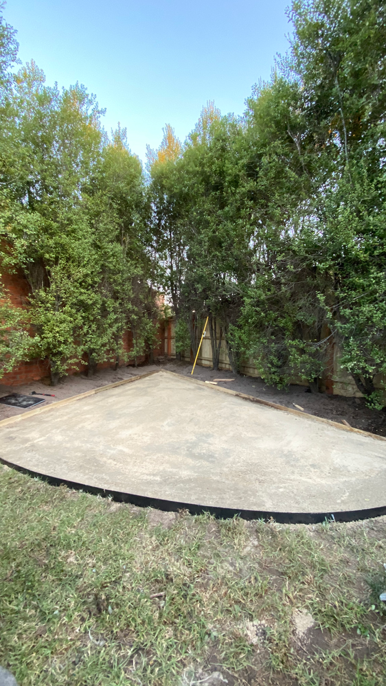

We prepped and raked the soil surface ready for compacting.

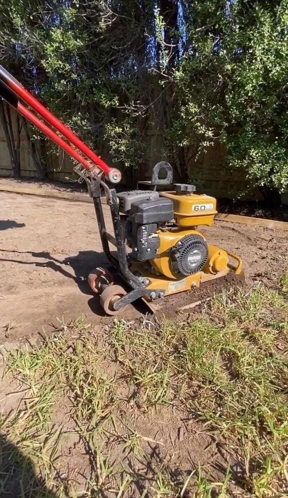

We hired a Bunnings compactor to compact the soil and provide a flat, solid bed for the road base.

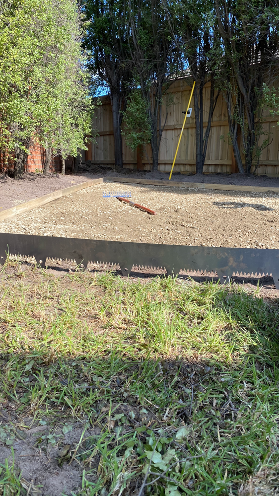

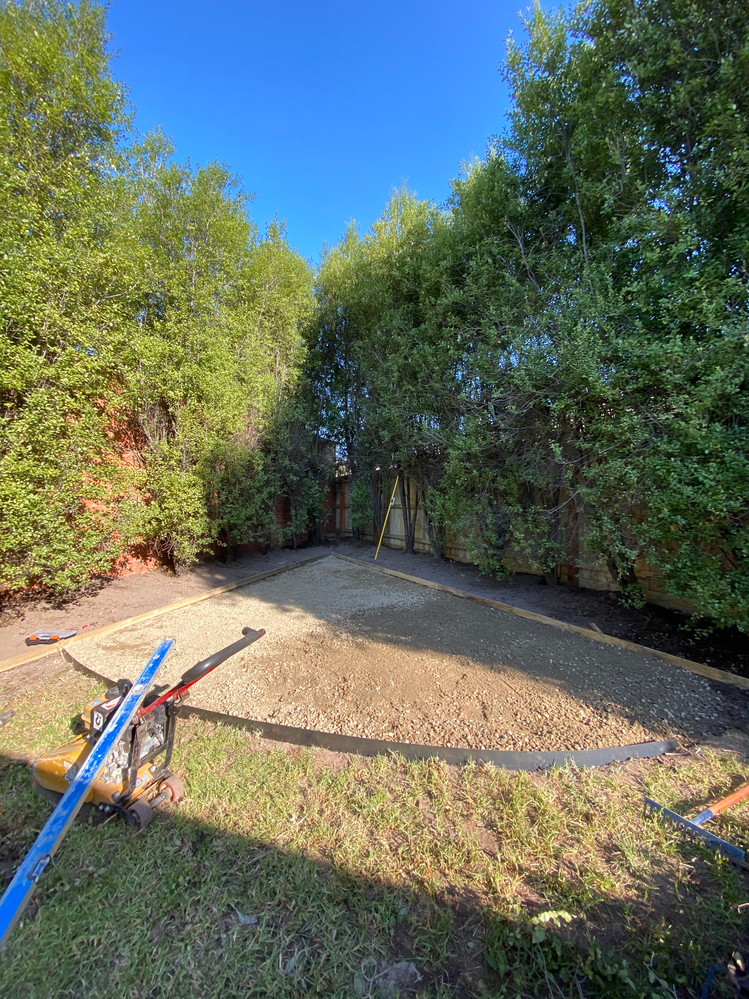

Installed the corten steel edging and filled in with road base.

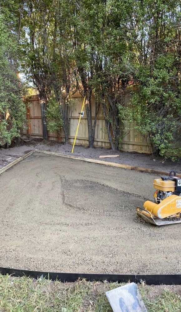

Compacted the road base – four passes over the whole area, two hours of compacting.

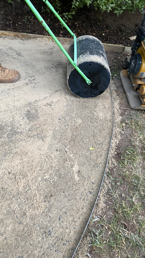

Spread sand across the whole surface to level out any bumps, low spots or divots.
Rolled the sand with a turf roller.

Used a broom to brush silica sand into the turf pile.
Installed wired-in garden lights around the perimeter of the area.

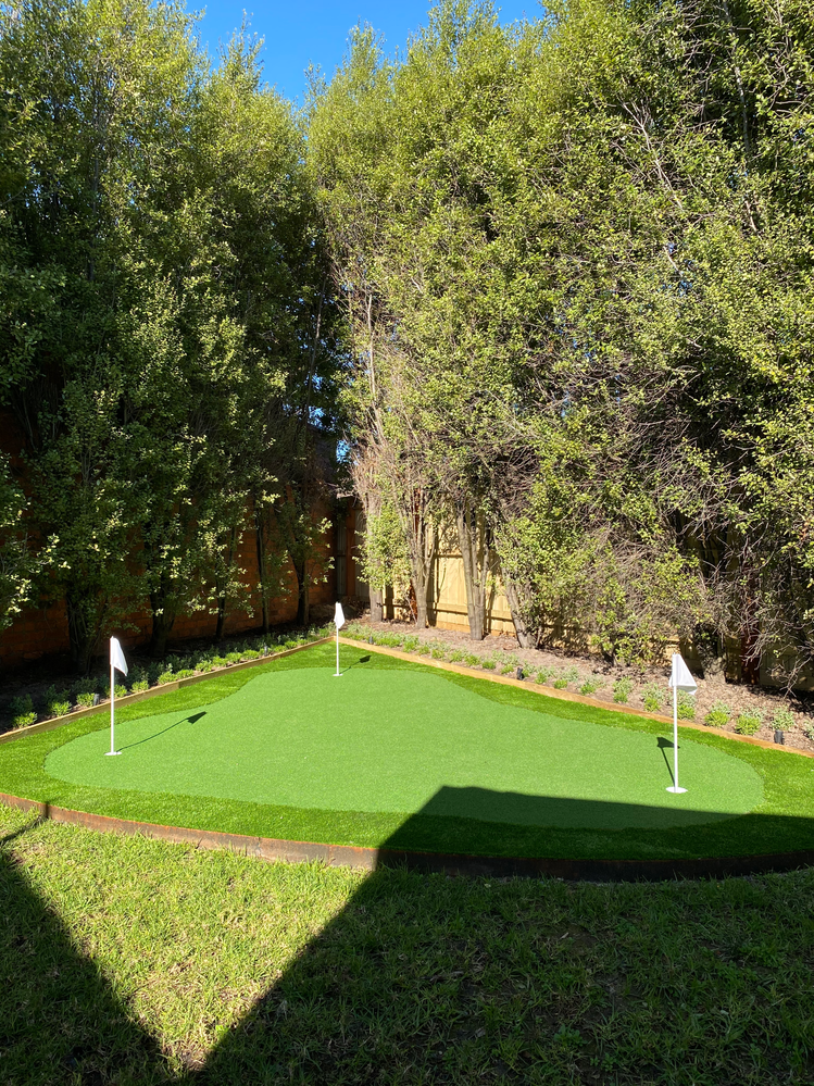

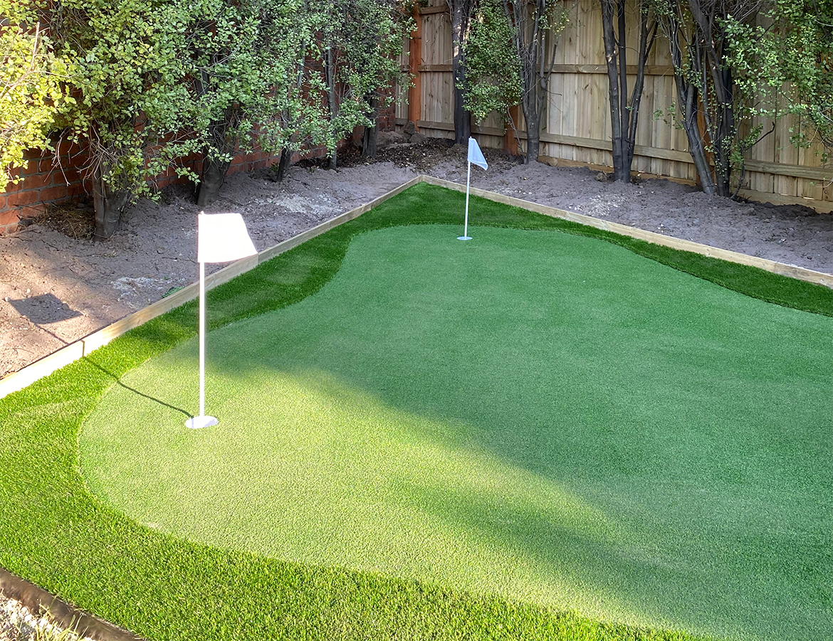

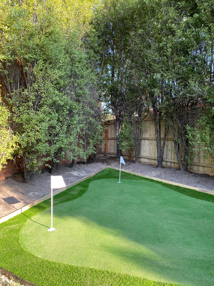

The finished project.

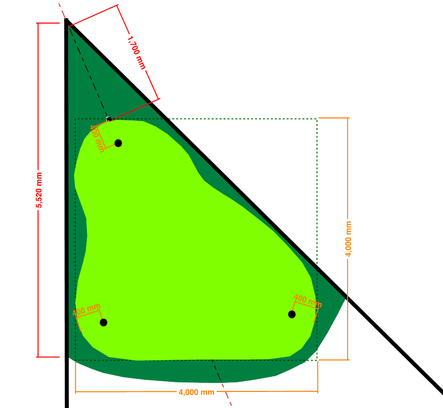

We budgeted $1500. Here's a diagram of the dimensions.

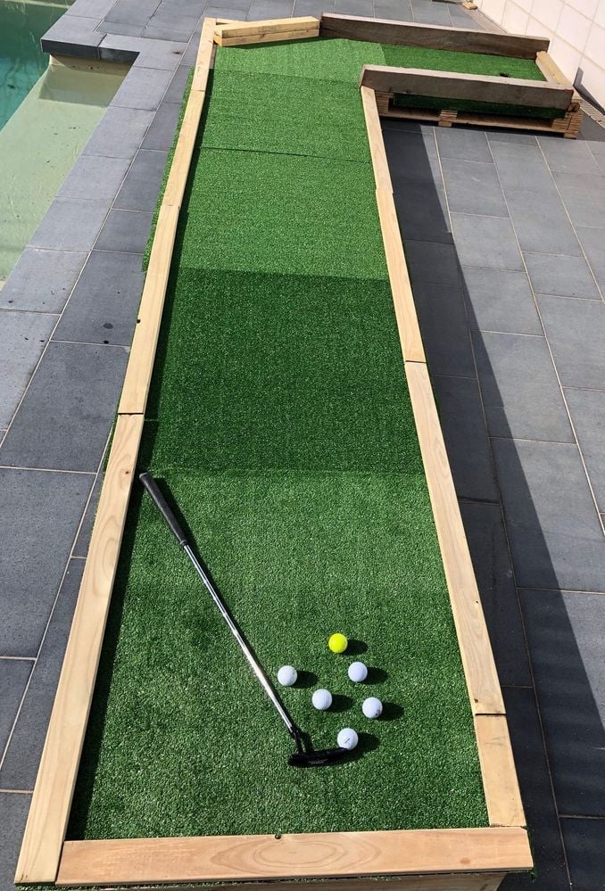

Bunnings Workshop member Fergus shared how to build a simple backyard mini-golf hole using recycled pallets.
