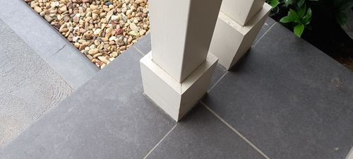

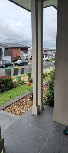

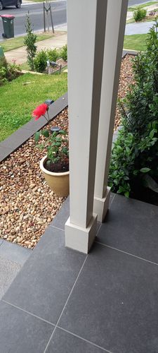

I bought the house recently. The out door pillar of my house doesnt look attaractive. I think it is made of some kind of metal. How can I change it into something attractive, preferrably brick?

For a beautiful quick change, I suggest having a look at this discussion - Hamptons-style verandah posts by @emmajames. You can easily disguise your steel posts and turn them into Hampton-style-looking pillars. However, if you have your heart set on brick, I suggest measuring the area around it to make sure that there is enough space at the front and side for the brick to sit on.
One more way to disguise your steel pillars is by covering them with timber - Transforming dated brick pillars to modern by @DKG. The process of installation would be the same and that is you would need to build a frame around your steel pillars and attach the timber across them giving it a new look.
