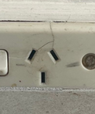

Hi all! I have just moved into a place with these annoying skirting GPOs. None of my power boards will plug in due to the proximity to the floor. Any ideas?

What an amazing situation. It looks like the floor is rising similar to our current flooding. Is that concrete with lino covering?
No wonder you can't get a plug into it - the 'floor' is nearly at the height of the earth pin. To my eyes I can't see that adapter working because of the distance indicated...

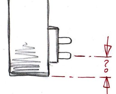

Have you tried a cord that exists on the rear of the plug, @sarahlo? Something like this Arlec 3m White Extension Lead? @Noyade has depicted the issue most adaptors will face as their chassis extends a substantial distance downward below the earth pin. In the image below, I've indicated how a rear entry plug is of a smaller size. Some extension leads use quite soft plastic for the plug, and you might just squeeze it in.

Looking even closer at your photo - it would appear the submerged power point casing is cracked above the active and neutral pin holes.
With this and being so close to the floor and therefore an electrical hazard, would it not be advisable to inform the landlord or real estate of its existence?

Those particular socket-outlets aren't even meant to be installed there.
They are a work-top type socket for above benches.
The current wiring regulations (AS/NZS 3000) prohibit socket outlets within 300 mm of a floor surface and of course, as anyone can see,
there is no way in hell you can plug anything into them.
My guess is, the floor has been resurfaced and lo and behold, they had to cut the floor in around the sockets.
This is really poor and I would be talking to the last building owner, as these sockets are not electrically compliant the way they are installed
and any outlets like this need to be relocated to at least 300mm above the finished floor level.
