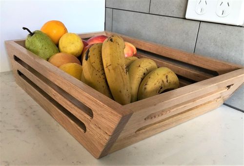

I made this timber fruit tray using Hardwood Multi -Use panel (1200x300x 17mm, price $35.00 from Bunnings) instead of using single pieces of hardwood, which would have had to be glued into panels. This saves build time and cost of materials.
I finished the tray with three coat of clear waterbased varnish, also from Bunnings

What a fantastic design and lovely finish, @JoeAzza. I really like the splayed sides and the routed detailing. How long did it take you to construct?

the tray didn’t brake long to make, approximately 4hrs
it took long to think about the idea of how to build it.
no nails or screws were used just glue and biscuit joints

This looks awesome @JoeAzza , those routed sections on the sides look mint, did you have much trouble doing them?
Thank you @Remarka6le , not too difficult , I have a router table, I used a 12mm spiral carbide router bit, just took small depth cuts.
