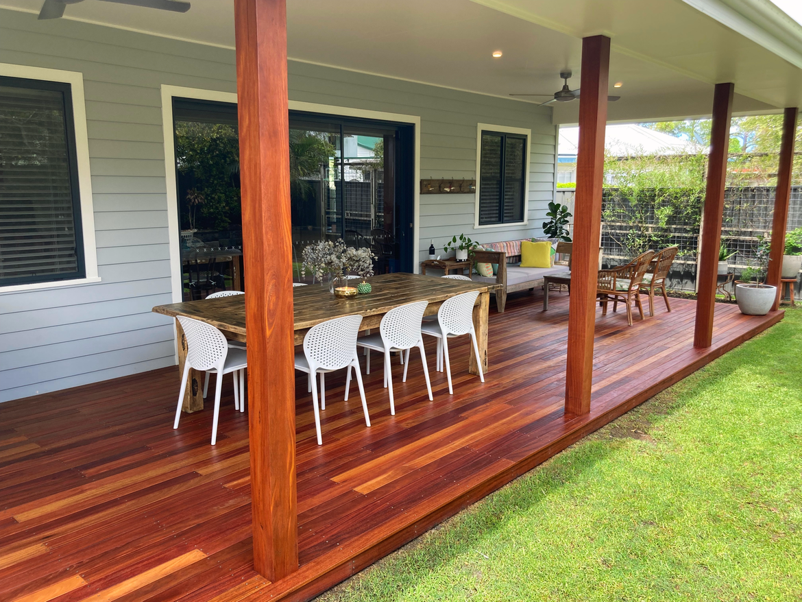

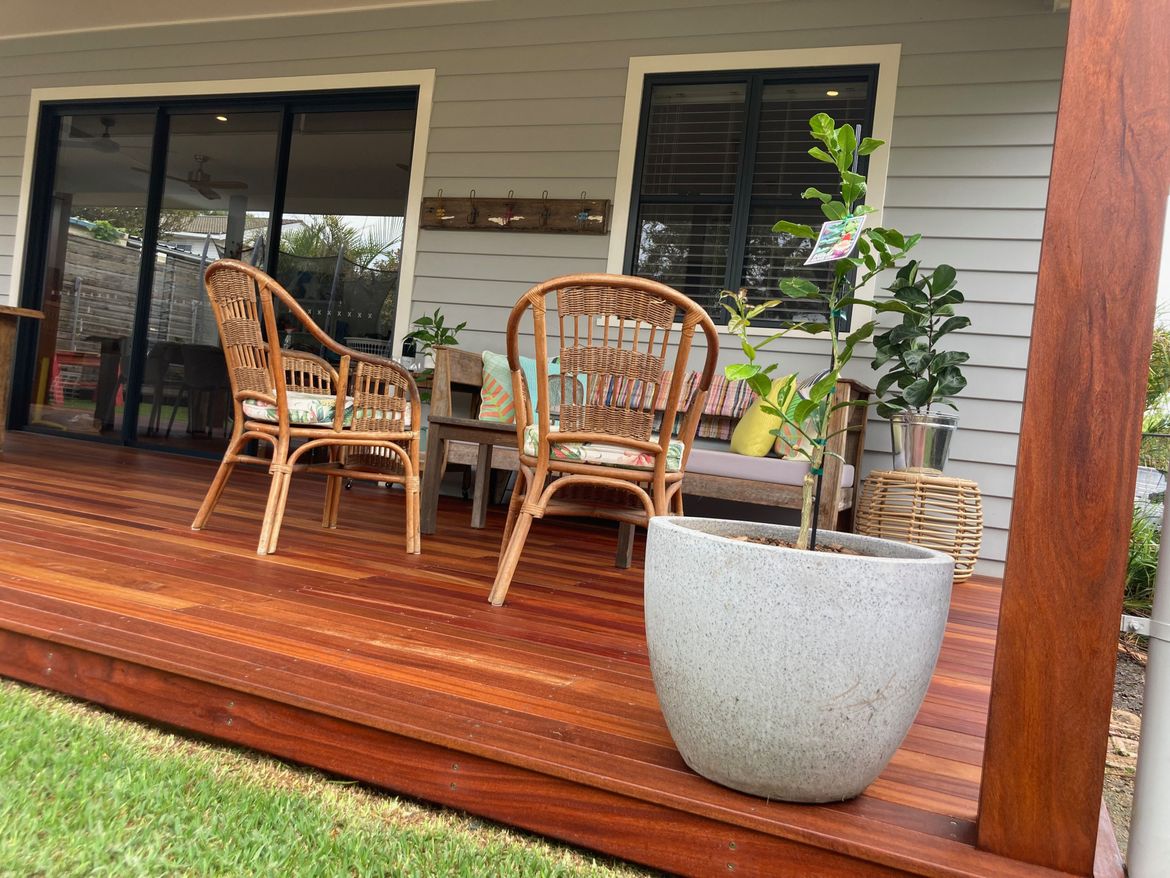

A low-level hardwood deck under a verandah is finished with a clear oil for a rich, natural look.
The project

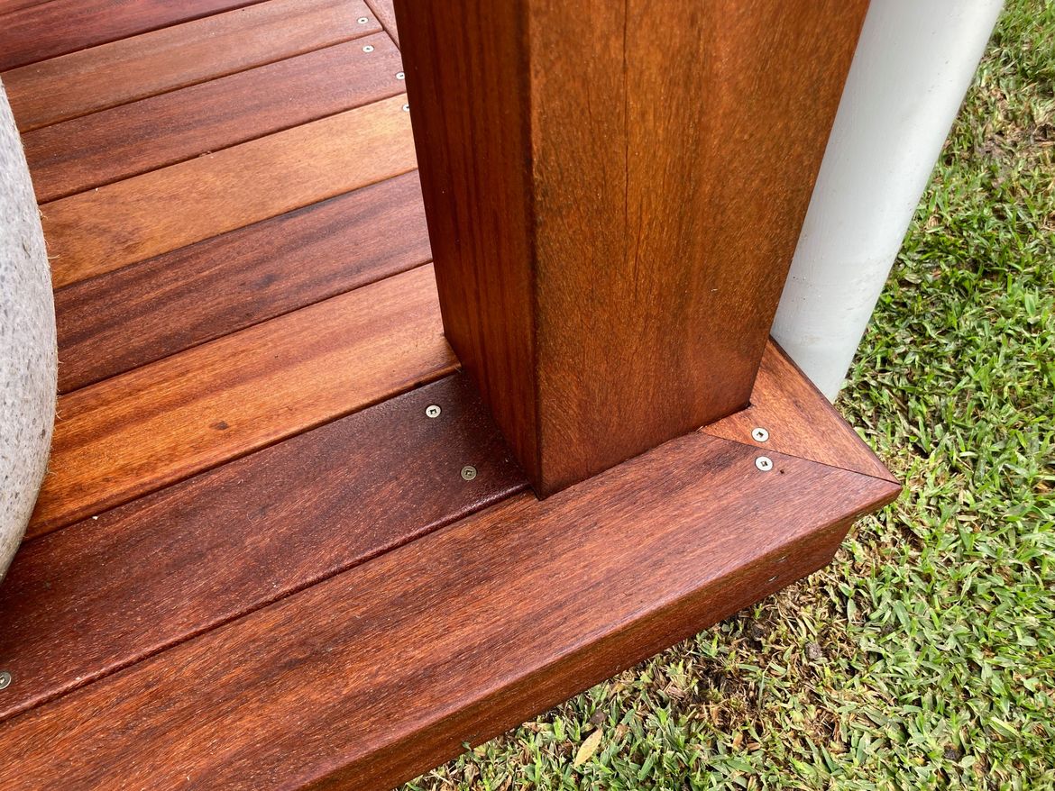

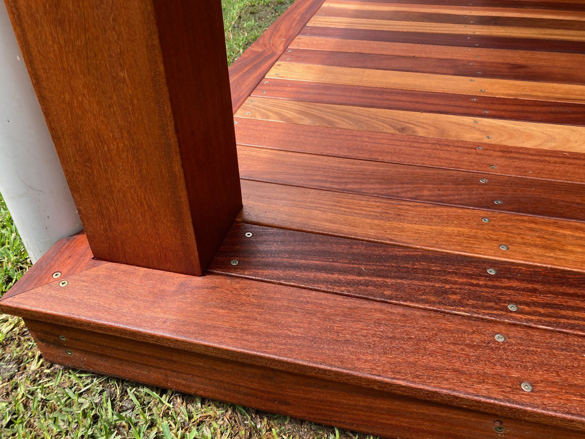

The decking boards and the posts are a timber called Tonka or Brazilian Teak. I absolutely love the stuff.
It's the only hardwood l know of that doesn't leach tannins. That's one of the reasons l've used it – it also holds up the carport, which is over exposed concrete, and l didn't want tannins leaching all over that surface.

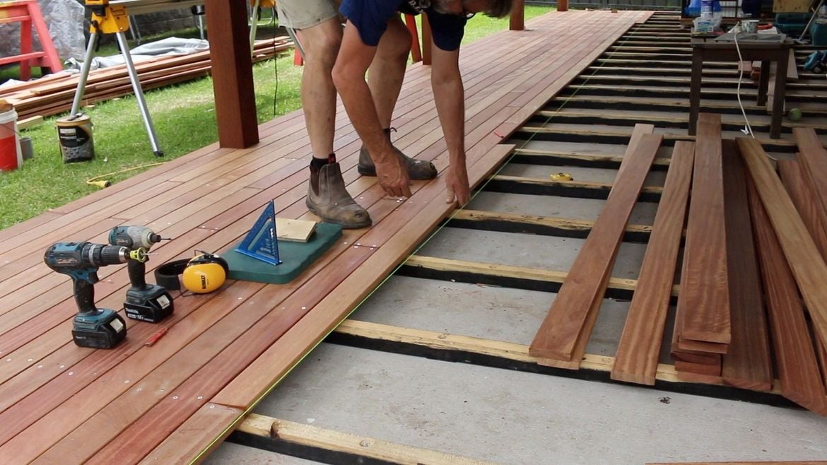

The only drawback with Tonka is that it is extremely heavy and hard, which makes working with it a little challenging at times. But the end result is well worth it.

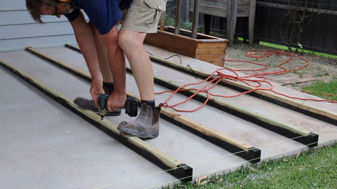

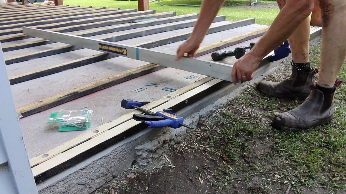

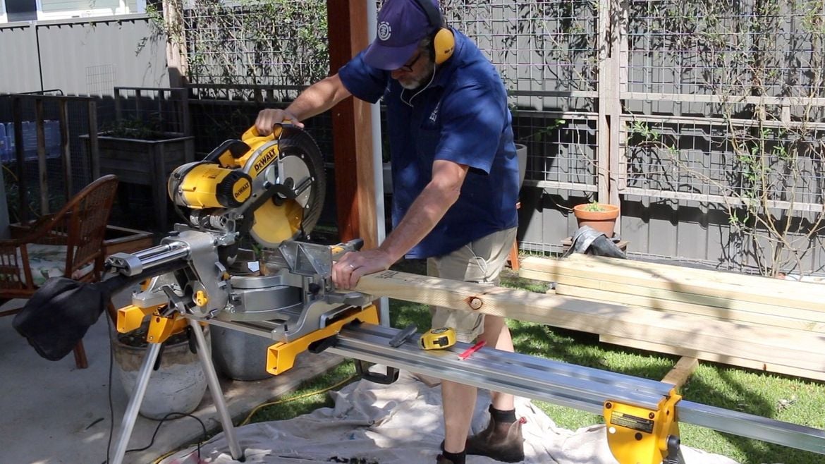

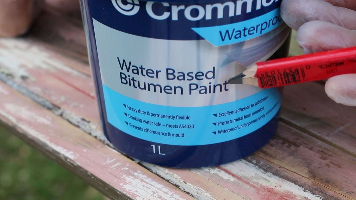

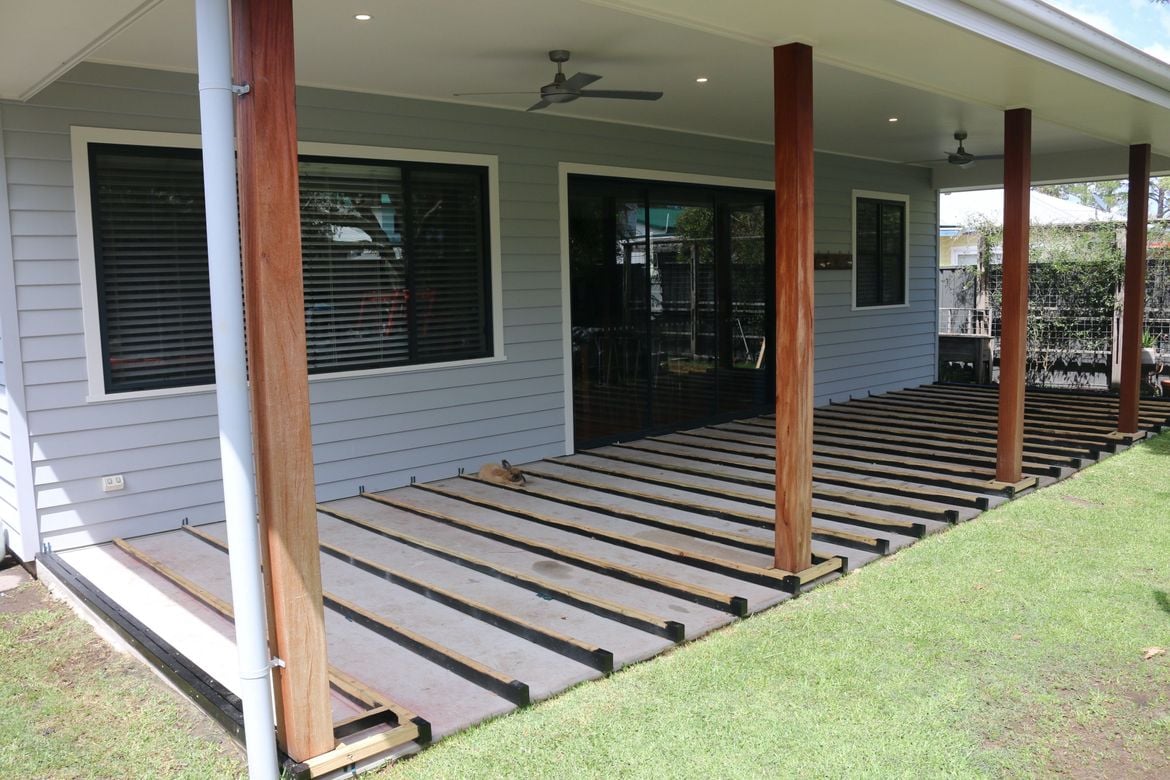

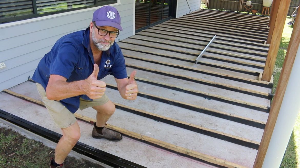

The subframe was 90mm x 45mm MGP10 treated Pine, which l cut down and coated with bitumen paint to help protect it from moisture. These were attached to the concrete with concrete anchor bolts.

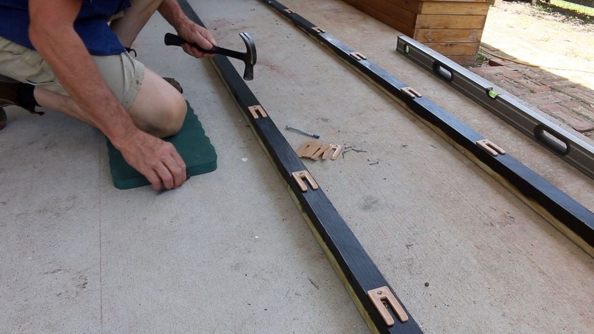

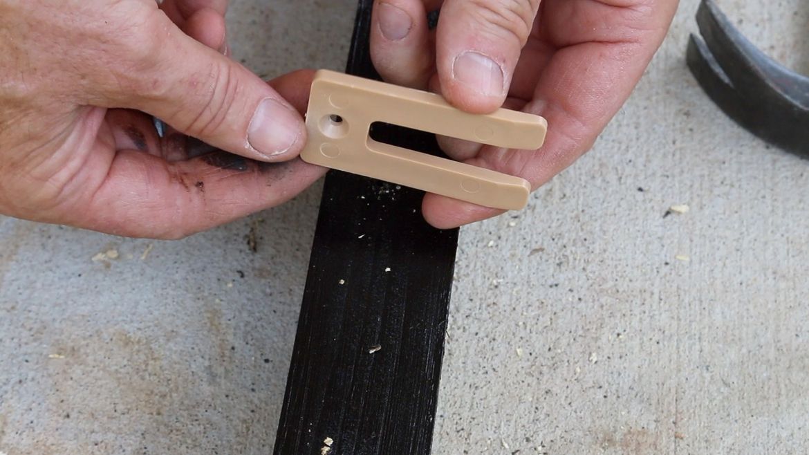

Under the treated Pine subframe l attached 5mm plastic window packers spaced at about 350mm to keep the joists up off the concrete.
I used Cutek Extreme clear oil for the finish – no tint was added. The only issue with the clear is that it will fade and you will need to repeat every 12 months if you want to retain that colour.
