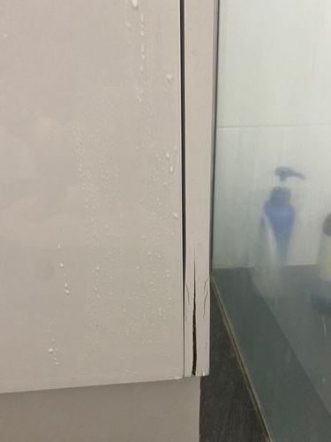

I just noticed this crack in our plastic look bathroom vanity. Any suggestions on fixing it/repairing as best we can?

Thanks for sharing your question about fixing your bathroom vanity. The best advice link that @KatieC provided is a great way to repair your damaged vanity. I suggest having a look at the Craftright 300mm 2 Piece Quick Action Clamp to grip the timber back together. My only other recommendation is to use a hair dryer to make sure that the gap between the timber is totally dry.

Thanks so much for your help. We followed your advice,
including hair drying it first. Unfortunately it looks like some of the cracks have gotten bigger. We haven’t been using the bathroom in this time to reduce moisture in the room. Any other suggestions?
It appears compressing the lower section has forced the expansion of the area directly above it. If the glue is now dry on the lower section, you can attempt to insert the glue into the upper portion and move your clamps up. I'd expect a similar result and suggest placing a clamp on either side of the runner. Place your clamps so their entire plastic foot is on the timber. You've got them partially off the front face there.
Once the timber particles swell and dry out, it would be quite difficult to compress them back into position. Not utilising the room and drying the timber out before applying glue and clamping could exacerbate the issue. You might be better off starting to use the room again, allowing the fibres to moisten and then attempting the glue up again.
Can I please ask how old this cabinet is and if you purchased it from us? If you have good ventilation, you shouldn't expect to see this type of damage on cabinetry designed for a bathroom unless it is particularly old and worn.
Hi @poppylee198 , further to @MitchellMc 's advice, if it is not a viable option to replace the cabinet or the damaged panel, then I would consider opening up the crack a little with a screwdriver tip so that you can remove some of the swollen inner chips with a knife or multitool plunge blade if you have one. When it looks like it will compress flat again, you need to put a short length of straight timber on both sides of the crack, such that you can clamp the full length of the crack at once. You will need 2 clamps for that.
The reason for worsening the crack is that the clamp at the bottom has forced the timber to bend over the swollen inner chips which has levered the top end outwards and opened up the crack. That's why you need to use a timber strip on both sides so that the sides get pushed in evenly along the whole length of the crack. I hope that makes sense.
