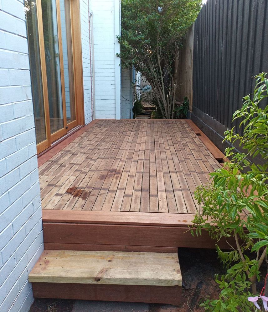

The deck is 4600mm x 2270mm, and the height ranges from 250mm to 400mm because the ground is on a slope.

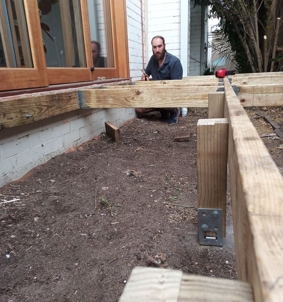

I used three rows of supports. The first was a ledger I DynaBolted to the brick wall of the house. The second was a ledger I DynaBolted to the concrete footing along the fence line.
For the middle row I DynaBolted stirrups for posts to the existing concrete footpath pavers.
Given the existing brick and concrete footings I didn't need to pour any additional concrete. I was quite relieved by that. I didn't feel like digging holes and messing about with concrete.

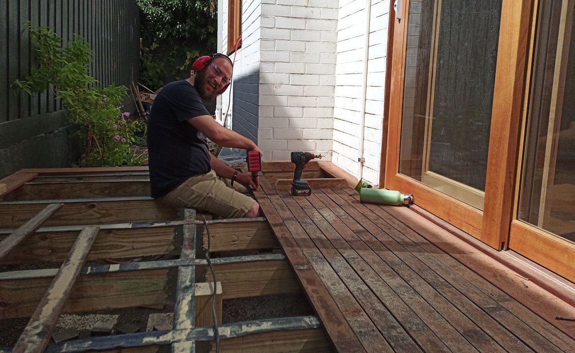

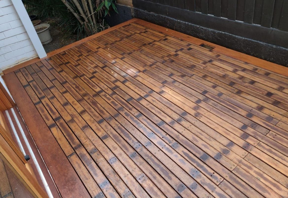

I used new 120mm Merbau for the trims and reclaimed Merbau for the main deck space.
Before starting I laid down some plastic and covered it with stones to stop weeds. I also planted climbers under the deck on the fence line. I put holes in the deck for them to grow out of and spread across the fence.

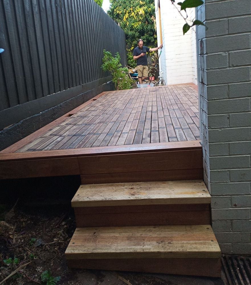

The steps took a bit of figuring out but they turned out great.
Buying stringers for the steps was going to be expensive and I fancied learning how to make them. One side was on a sideways slope, so each stringer needed to be different. I made them out of treated Pine.
