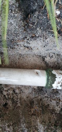

Hi. I need help in fixing a puncture on one of my retic tubes. Any advice is highly appreciated. Thanking you in advance.

I must be doing something wrong. I have gone round the damaged pipe 6 to 7 rounds and left it overnight. When I turned on my retic, water was bursting out from the same hole.

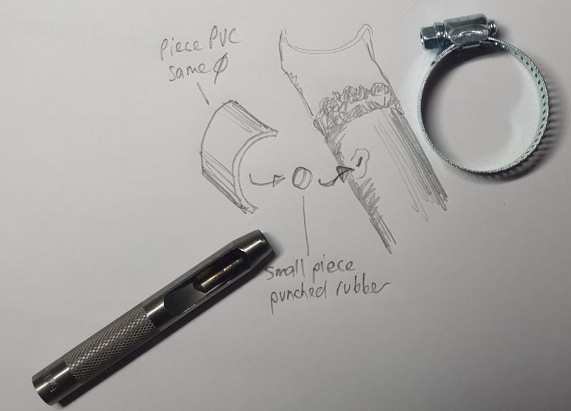

Now, I'm just an amateur plumber and student of hydrodynamics, but I have had some success with this method in occluding pin-holes in water mains pressure pipe.
However I do admit there is a lot of trial and error in punching out the 'perfect' piece of rubber in thickness and diameter. Bunnings have an excellent source/variety of rubber for sale.
Once you have the perfect piece of rubber you can adhere it to the hole with silicone or maybe a piece of that tape @EricL has suggested and then cover it with a cut partial piece of PVC pipe shown below - and then strongly clamp....but not too strongly.
Just another suggestion/method

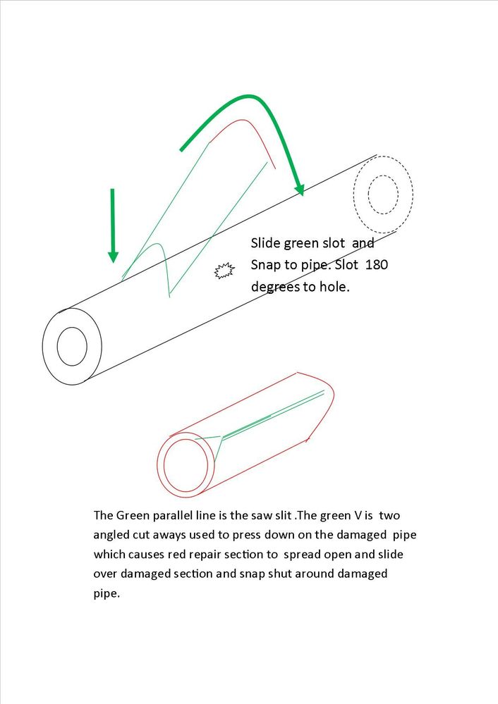

Hi @Izzy78 and @Noyade
I didnt want to mention this initially I though the tape solution was going to nail the problem if it is stretched like @EricL said and it still might.
I slap on a thick coat of pvc plumers glue to and around to pipe with the hole.
i use a 100 to 150mmm bigger if hole bigger section of the original pipe and cut a thin slot usually with a hand saw length ways. Then cut off two little angled .tabs to make a V shape used to press on the pipe to be repaired as the v is pressed down the slot opens up expending open the repair pipe and swallows the damaged pipe closing with a snap
I open the pipe with the slot just enough to push it over the damaged pipe turning the slot opposite position to the hole and letting the whole repaired section snap around the old pipe with the slot 180 degrees away from the hole.
I have used this several times in low pressure pipes especially if hole is on the top or side. If a Bunnings is not near by for repair coulpling. Please note the repair section of pipe is no longer 100% round but slightly elongated and the glue must be thick enough to fill a slight void.
Quick PVC pipe repair low pressure systems.
