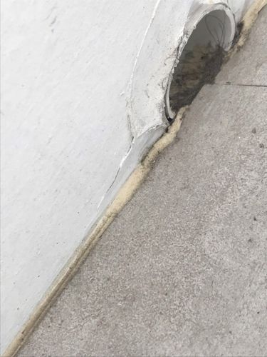

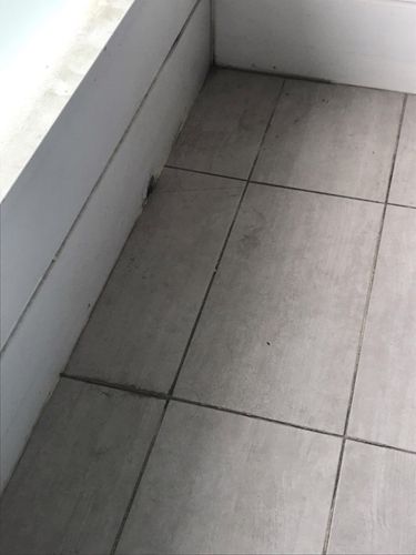

Please can you provide advise and products to use for Balcony waterproofing? The grout or membrane seems to be leaking.;

Hello @JustinMcAbbe
I suggest using CPC 220ml Shower Plug Sealant, it's designed for interior and exterior use, I've used this in my shower a long time ago and it is still working very well. Please keep in mind that this is an overall waterproofing agent and can be applied both on the tile and grout. It's important the area be cleaned and washed very well, all cracked and broken grout must be removed and repaired. Once the area is fully prepared then you can apply the sealant.

Also, do you have any advice on removing the grout and putting new grout, some of the grout looks powdery
Hi @JustinMcAbbe,
To remove powdery or otherwise damaged grout, you will need to use a grout saw , or a multitool that includes a diamond grout saw blade for larger areas.
Here are the steps for removing grout:
To install new grout, follow these steps:
Here are a couple of helpful step-by-step guides that will assist: How to remove grout and How to grout tiles.
