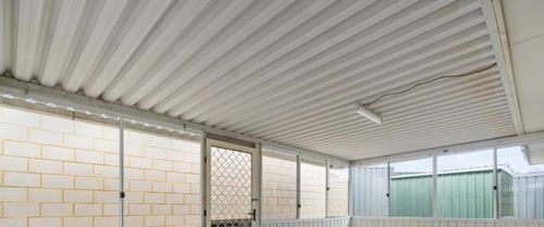

This enclosed patio/sunroom gets warm during the day with heat from the roof, so I’m looking for the best way to insulate it with a foil backed insulation/foil board without any drilling - ideally something like this so the ceiling appears white.
I’m looking at using a high heat double sided tape or silicone to mount it to avoid leak risks with drilling, however, most instructions I’ve found refer to shed roofs with purlins and recommend creating air space, which I don’t think would work with adhesive mounting.
Does anyone have tips on how best to insulate this? Thanks
