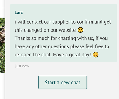

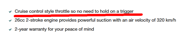

When I got home I re-read the reviews and one person said the only way they could get this started was to squeeze the trigger fully THEN pull the cord. I couldn't see this in the instruction book. If it had a Ryobi style cruise control you could set this up but despite the web page saying it has one - I couldn't see it?
Nor could Larz...
