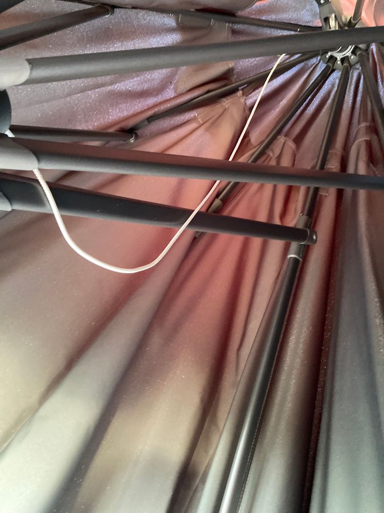

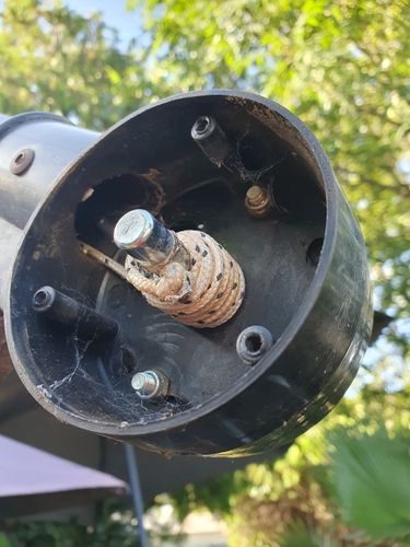

Any chance the rope is slipping "over" as you wind = which means as you continue to wind in the same direction the canopy reverses direction?
But it doesn't seem possible as the cover has a concave female connection? Well, mine does.
However my rope isn't the original - this is orthopaedic rope used for fractured femur traction.
1/2 Down or 1/2 Up!CordFully up but not quite!
3rd photo is upside down!

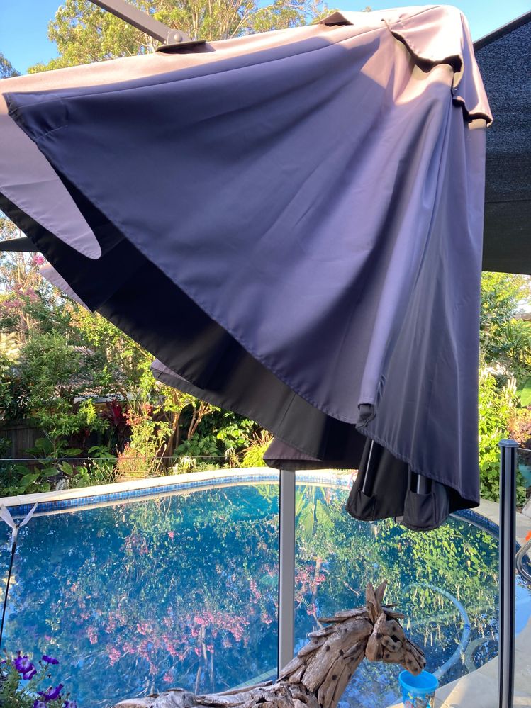

Thank you for posting those photos of your outdoor umbrella. Have you tried to pull the rope while turning the winder? Perhaps if you turn the winder in reverse while pulling the rope it might loosen up whatever is tangling it. It looks like it has a secondary arm, does it slide up and down the main post or is it fixed in place? Can I bother you for a photo of the winding arm with the entire umbrella included?
At this point in time, I can only suggest trying to loosen up the rope. When the winder becomes free it should let you fold the umbrella down.

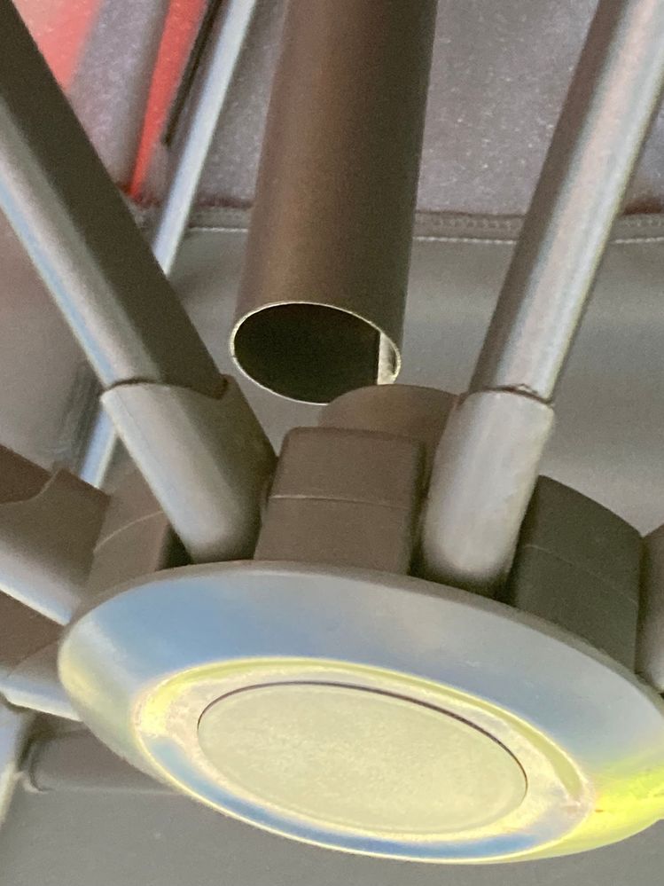

Thanks for your effort guys its fixed!
I wound it to its full extent It was about 2cm short of going into the top female pipe but would not wind any further! I then wound it down till it stopped closing!
Then I gathered the umbrella to close it by hand at the same time my wife moved the winding mechanism 1 hole down! I let go of the umbrella and it wound right down! Dont know how but it worked!!!!
