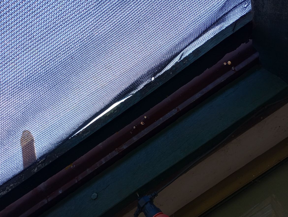

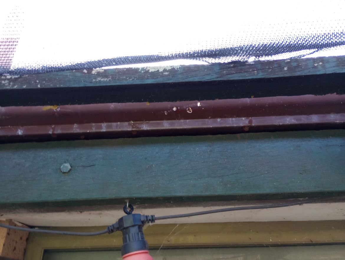

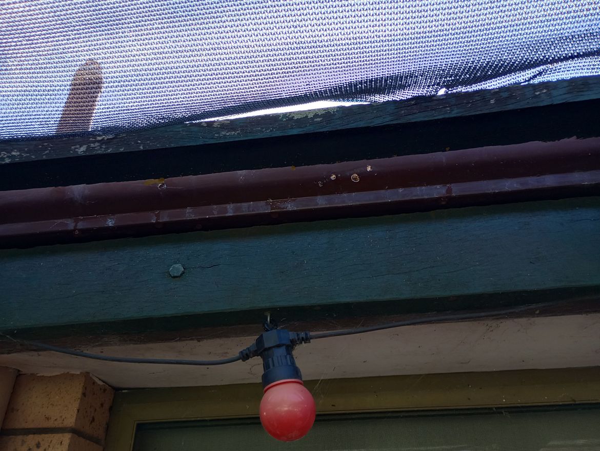

In Autumn 2015 we replaced all my gutters around my house with marine grade aluminum gutters. Today I noticed white corrosion marks on the outside of the gutter and when i touched them (well pressed hard on them with my finger) they turned into round 0.22 bullet sized holes. These gutters were meant to last 25 years and outlive me but they are not yet 8 years old. I'll post some pics tomorrow when it daylight and easier to do so. From my evening inspection it (hopefully) seems confined to a section of just less than 3 meters (or just 0.5 of a meter greater than the spare guttering I have on hand).
Does anyone have idea of the cause? I clean the gutters each year before winter with my Karcher pressure washer and it's drain cleaning attachment so I think my gutters are well cared for. The only two things that set this section of gutter apart are that a) its below my roof mounted evaporative air conditioner and collects it's runoff about 10 meters upstream (the runoff from the overflow is now leaking out my holey gutters) and b) it's almost immediately below but about half a meter downstream not upstream of a square of lead flashing that surround the soil vent pipe for the kitchen sink drain. A bit of "googling"suggest that run off from lead flashing may cause galvanic corrosion of both aluminum and colorbond gutters (see https://gartalk.garlandco.com/2012/09/19/understanding-galvanic-corrosion-and-how-to-avoid-it-in-metal-roofing/ ), So is this the likely cause?
