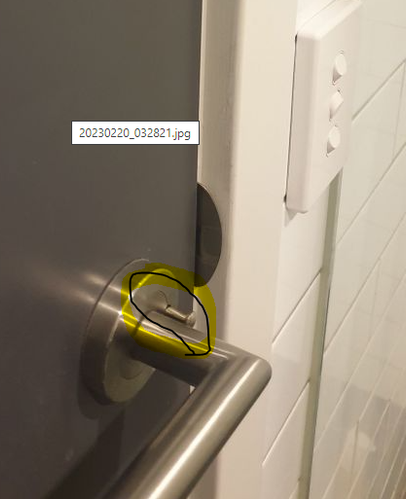

This is a photo of the door, the timber frame is not in line/flat with the door

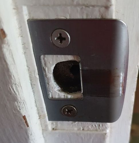

@Quachy I just had a look at your image with the handle, showing a pin on it, it looks like it's a privacy passage set, try pushing the pin in to see if it works, if not, try pushing the pin when the door is in the open position, if it locks whilst the door is open , there may be a problem with the stricker plate on the door jamb, the latch may not be locating in to the door jamb, an easy fix is to remove the stricker plate and file the slot a little bit longer or wider to allow the latch to fully engage.

I'm with @JoeAzza - get that plate sorted out pronto, then most likely the lock will work fine. I'd be disappointed if I had to drill/screw into the door and frame if a little chiseling, repositioning and filing of the plate will quickly solve the problem. I've had to do it a lot with old frames and new latches. Good luck!

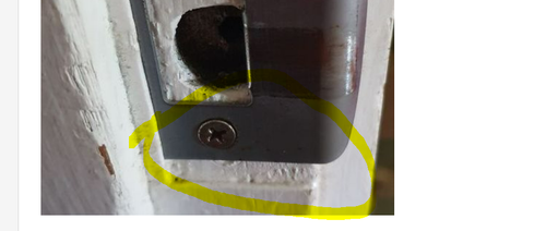

HI @Noyade,thanks a lot for the suggestion, did as you suggested and it's worked a gem! Got a chisel and made the hole for the latch a bit deeper. Can I ask something else - related
How do you get that groove flat to move the plate down?
Hi @Quachy,
You'd do that with a chisel, but removing the striker plate first would be best. You need to use the chisel to cut a straight line into and across the side of the frame at the height you'd like to lower the striker plate. You can then come in from above and knock that section of timber out with the chisel. Repeat this process until you have the desired depth. If you move the striker plate down, you'll also need to move the hole for the latch down.
