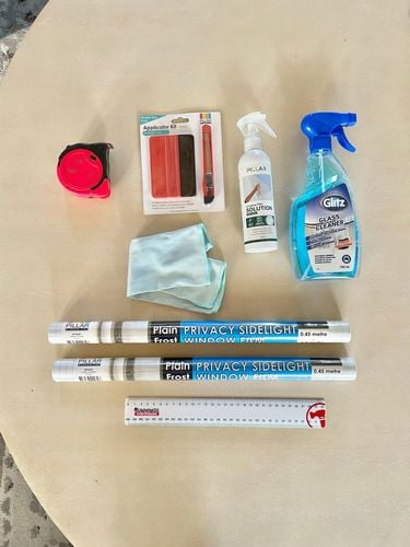

Materials used (everything from Bunnings):• Glass cleaner• Window microfibre cloth• Pillar Products “plain frost” window film• Tape measure• Scissors (to cut film to size)• Window film solution• Applicator set (scraper and knife)• Ruler.

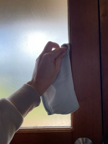

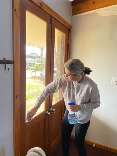

Clean windows thoroughly.

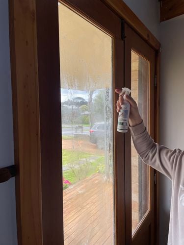

Spray window film solution on the window.

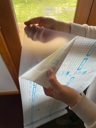

Peel a little backing off starting from the top end of the film.
Step 6

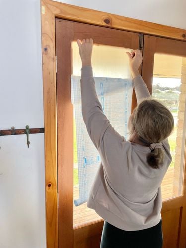

Place film onto the window, starting at the top.
Step 7

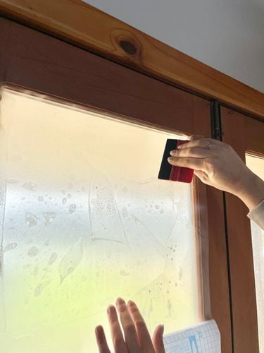

Smooth out the film using the window film applicator (scraper). Peel the rest of the backing off as you work your way down.

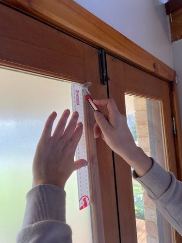

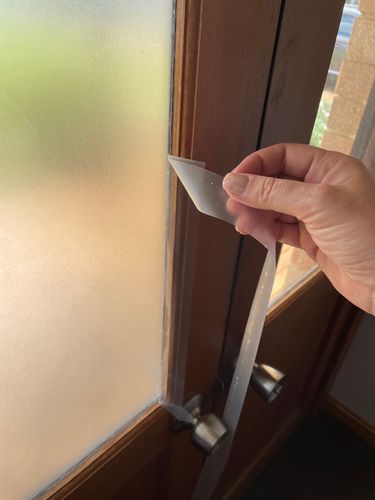

Using a ruler as a straight edge guide, cut the excess film with a blade/knife. Leave a couple of millimetres gap between the edge of the film and the window frame to allow the window film solution to run out.

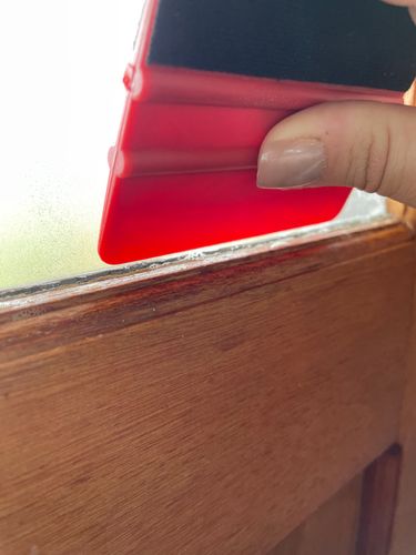

Use the window film applicator again to scrape any excess solution out towards the edges.
Step 10
Dab a cloth along the edges to soak up all the excess solution.

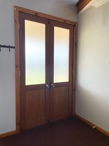

This project was quite simple to do. The trick is to take your time and make sure the windows are really clean prior to applying the film. The slightest bit of dirt will make the surface rough and will often lead to an uneven finish and trapped air bubbles.
The frosted film has made a huge difference, these windows can no longer be seen through during both the day and night so we were very happy with the result.

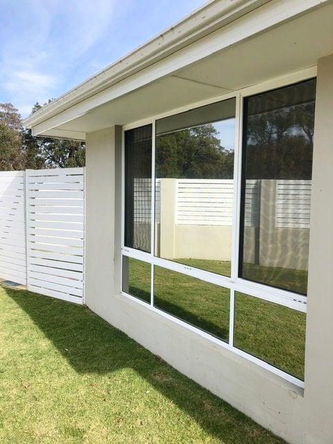

Jess (@prettyliving) also tinted her windows using mirror-tinted window film in order to add privacy and remove sun glare.
