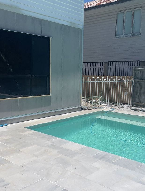

We aimed to install a new fence along the back wall, extend the exterior wood fence along the side and build a gate, add landscaping, and paint the house which surrounds the pool, which is part of the new extension.

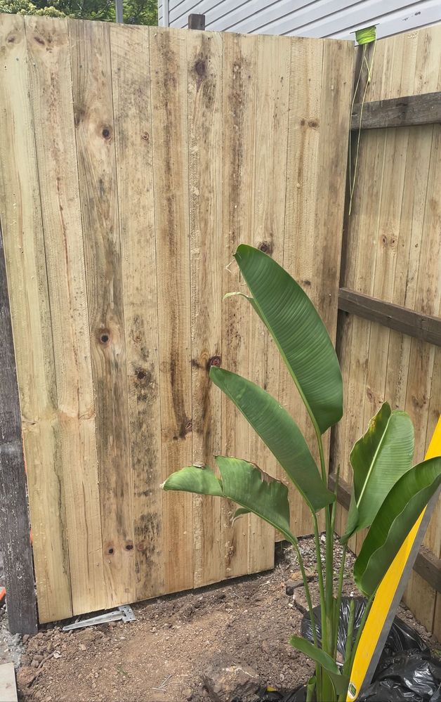

The original wooden fence was joined with chain link fence. To remain budget-friendly, we kept the fence to the side of the pool. It was looking a little ordinary but was in good condition. To ensure compliance, we needed to extend the fence and add a return from the new fence to the house.
We ran a string line to ensure the new fence was in line with the existing fence and bolted the new timber posts to the existing chain link fence posts, as these had been concreted in place previously. We installed three fence rails overlapping the existing wooden post. We set the stringline on the top of the fence pickets to ensure they remain at the same height of the existing fence.
We installed the fence pickets using a coil nailer with galvanised ring shank nails (two nails at each rail - each picket had six nails). We raised each picket to touch the string line, using a level at the side of each picket to ensure it was straight.

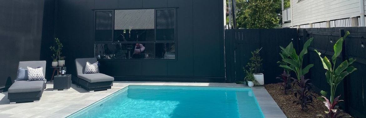

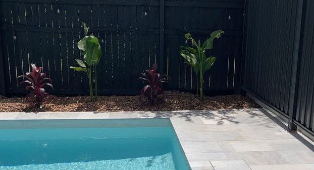

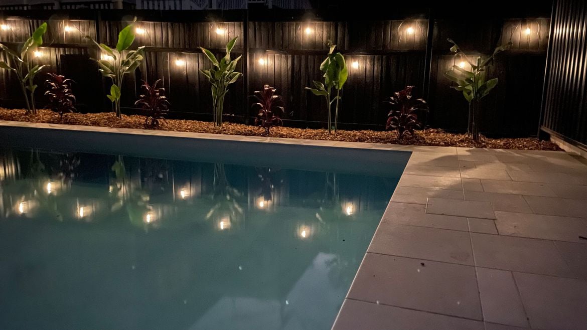

We have a 10m x 1.2m garden strip that gets full sun for most of the day. We wanted to add a low maintenance garden that didn’t shed into the pool (we have enough cleaning with three kids and three dogs). Privacy was also paramount as our neighbour's deck overlooks our pool area. For that reason, we chose to plant Heliconia Rauliniana. They grow up to 4.5m tall and thicken at the base without taking over. To stick to our budget, we chose to purchase young heliconias. They more mature they are, the more expensive they are, so we saved a lot of money by deciding to be patient and let them grow.
Due to the size they will grow, they needed to be spaced a minimum of 1.5m apart and approximately 0.75m from the fence. Usually, I’m a relatively haphazard planter but as this area is a focal point, I wanted to be precise to avoid any gaps.
After mapping out the garden and dividing the space, we could space them 1.6m apart to ensure consistency across the garden. Using a tape measure, I measured from centre to centre of the heliconias and measured from the tile to the centre of the plant to ensure it was centre of the garden. (I chose not to measure from the fence in case there was a variation).
I then planted Cordylines slightly in front and centre of the line of heliconias, to allow the heliconias more space to grow and add a pop of colour.

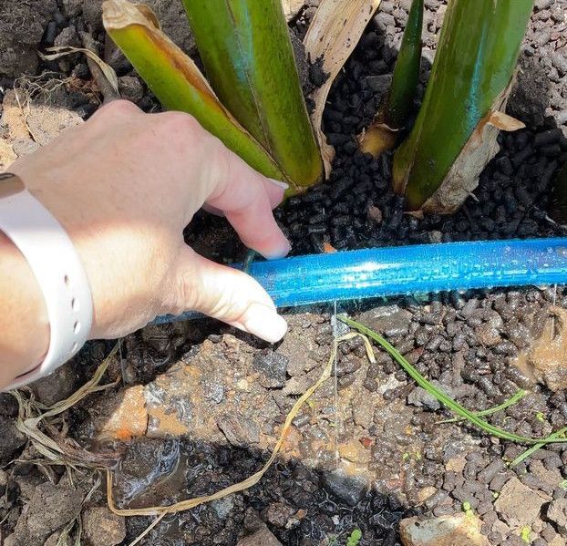

Although I love to garden, I have a relatively brown thumb, so I needed to add irrigation to keep the garden alive. We used a soaker hose and ran it the length of the garden. One end connects to the garden hose, it’s a straightforward system. The soaker hose holes are on one side of the hose, so we used landscaping pegs to secure the hose in place with the holes facing down.

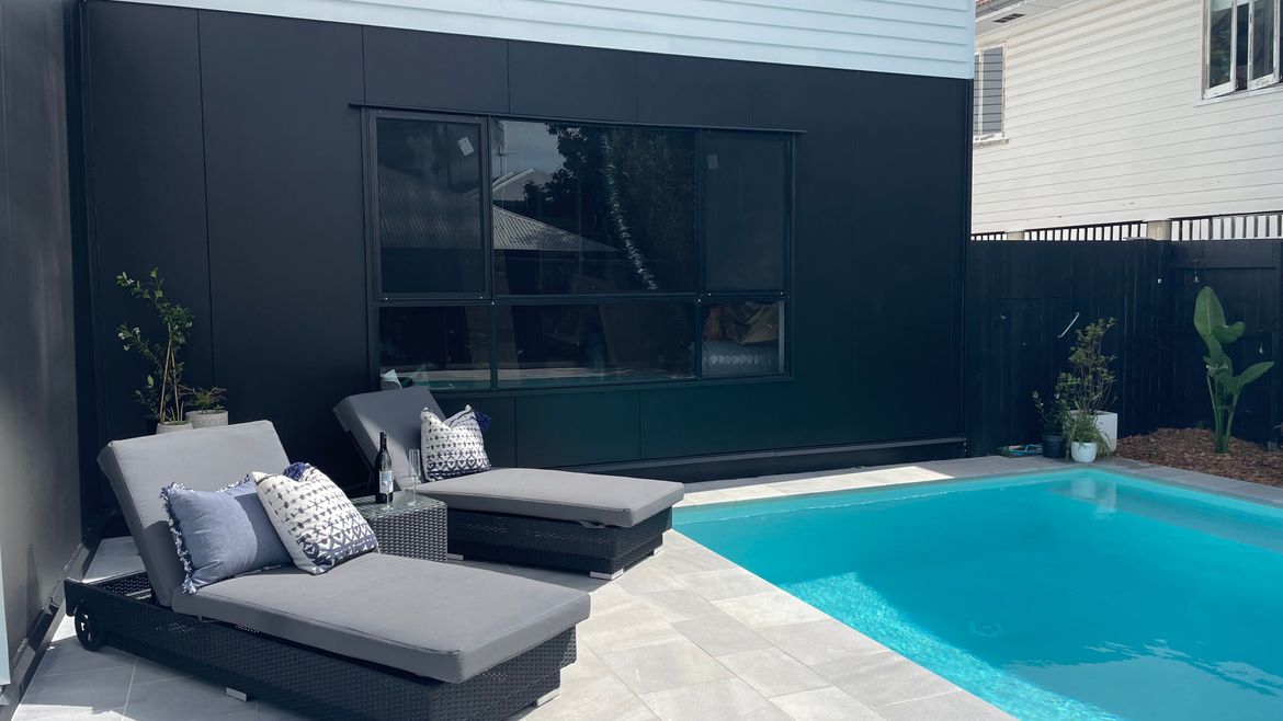

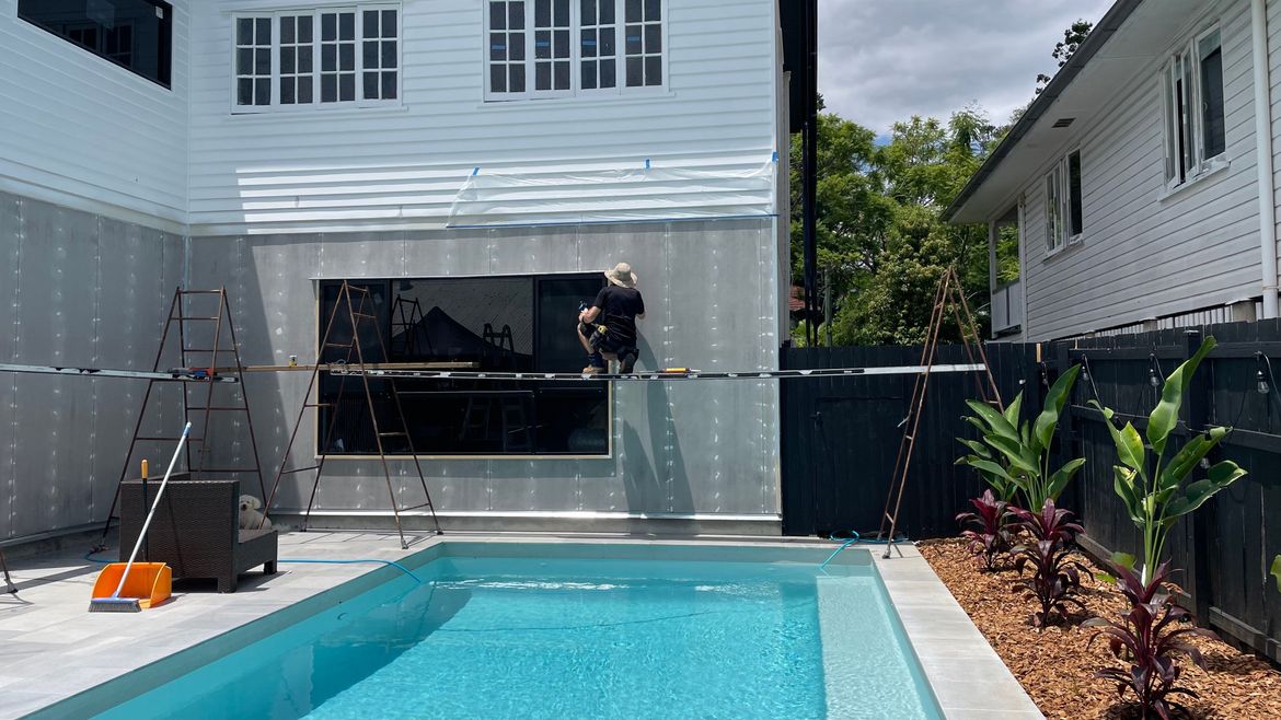

The final step in this pool area makeover was paint. Initially, we couldn’t decide what colour to paint the house. The original Queenslander, the top floor, we decided to paint with Dulux Vivid White.
We could have played it safe and painted the whole house white to make it look and feel larger. However, I wanted the ground floor to effectively disappear, allowing the Queenslander to take centre stage. So, we chose to paint the ground floor with Dulux Weathershield Night Sky Low Sheen. We painted the fence, the fascia and gutters the same colour.
Here's a part of what it looks like at night.
