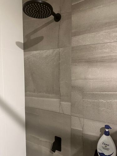

Hoping to get some advice on what the options are for me to change my shower head from a single fixed head to a combination.
What I have

Hi @Bomber25,
To convert your current setup to something similar to the image, your best bet would be to use a Havana Short Twin System 3F - Matte Black. There's no real need for all the extra pipework down lower. That will give you the rainhead and the handset options. You could even install it yourself by simply unscrewing the current shower head and screwing the new unit on. You'd then use your current temperature controller for the new unit. You could also use a Revolution Showers WELS 3 Star 9L/min Matte Black Self Clean Twin Shower, but you will need to drill into the wall.
If you like the Havana short system, then I'd recommend you go with it, as once you get it home, it will only take 20mins to install if you haven't replaced a shower head before.
