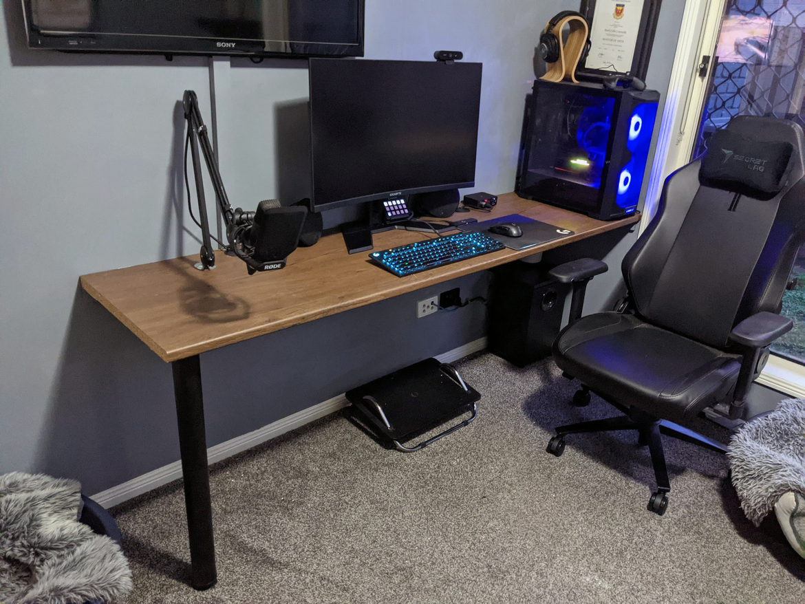

Eighty percent of my job is at home, so having an organised desk that you can be comfortable in front of is important. I also find myself eating lunch at my desk quite a lot and that was an issue with my previous monitor because my legs got in the way of pushing the keyboard forward when I wasn't using it. Cheap stands (quality and cost) can go for as little as $30, while the better looking ones are in the $200+ range. I was looking for something that was both cost efficient and complemented my workspace and habits well, so I decided to make my own.
This is my old desk workplace.

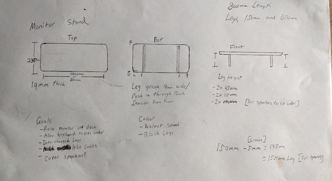

I made a rough sketch of what I wanted to do.
As the legs were only going to be 19mm thick, I cut three rough heights, just so I could see what the stand looked like, so I had 2x 95mm, two x 115mm and two x 165mm.

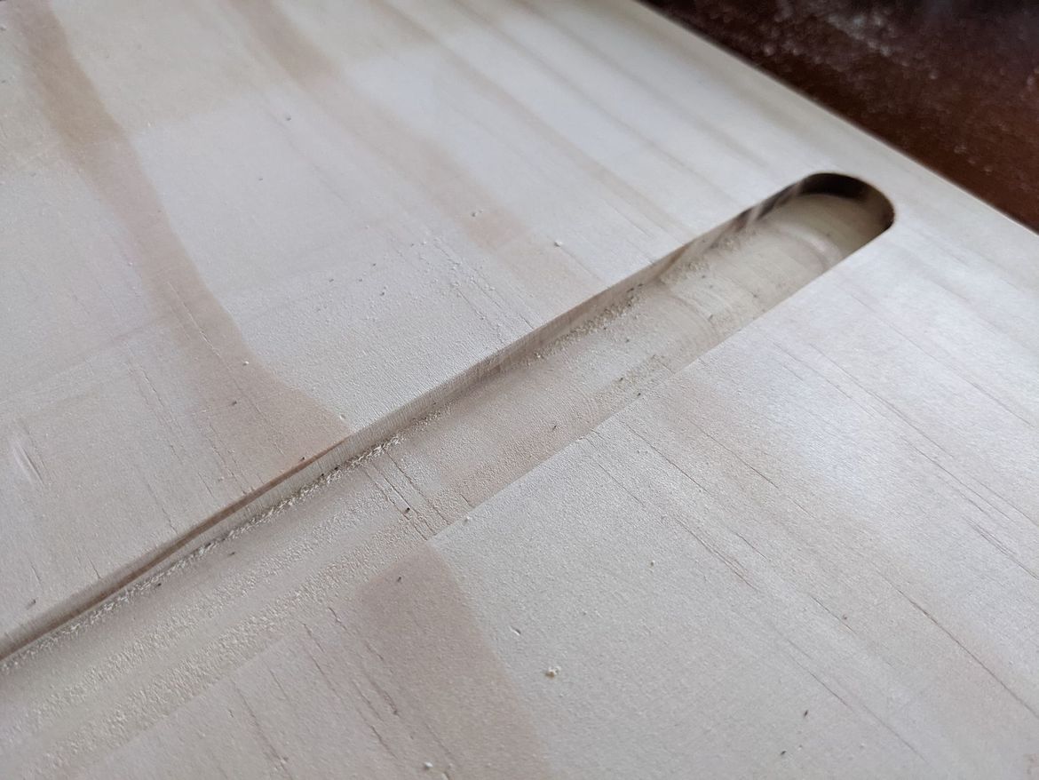

I switched over to the 19mm straight bit and created two straight 220mm lines at 5mm deep. These lines were at the 150mm and 650mm of the stand. They stop just before the front, so the legs look "hidden" under the stand and allow the nice, rounded finish of the front to be uninterrupted. The cut straight at the back allows for your legs to simply slide in.
Be sure to measure the distance between the centre of the bit you are using and the router edge. Use an offcut and clamp it down in a straight line along where you want to route to ensure you have a perfectly straight line.
After both were completed, I gave them a light sand to make it smooth.

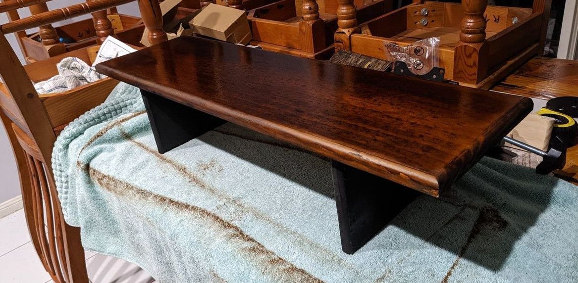

I put the round over bit in and gave all the legs a front sided double round over edge so that they would fit snug in the groove. After this, I cut the ends of each leg so that each were exactly 220mm long (the length of the groove). Each leg was then sanded for a smooth finish.
With each leg fitting flush and snug in the grooves, I gave them each a coat of black spray paint. I then got to work staining the top piece with the Walnut Stain and Finish. It took me four coats, lightly sanding between each coat, and letting it dry for six hours at a time before I got the desired colour.

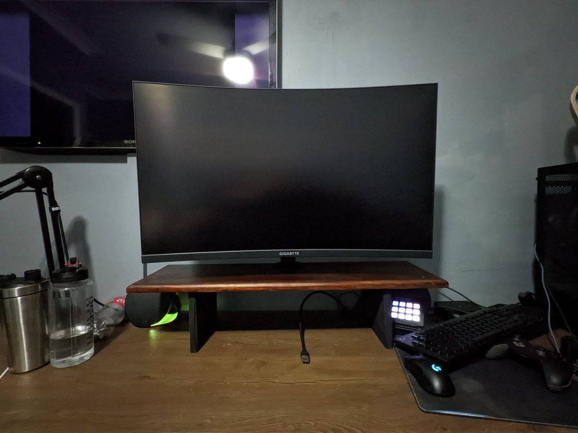

With everything together, it was now just seeing which legs I wanted to use. My original plan with the 165mm legs were for the speakers to go under the wings, but this proved to be way too high. See below.
Eventually, I ended with the 95mm legs and placed the speakers behind the monitor on the stand itself.

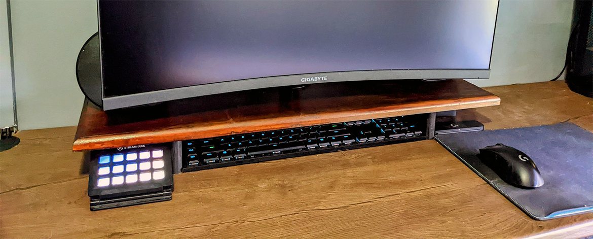

The 95mm legs ended up being perfect. The leg spacing is just the right size to fit my keyboard under. It also had the added benefit of covering up a lot more cables than I realised, so the project was a resounding success.

Also, I can now place my keyboard all the way back and eat my dinner at my desk. It was an interesting project to take on. I was certainly happy that I didn't use any screws either and the thing is solid. Huge success.
