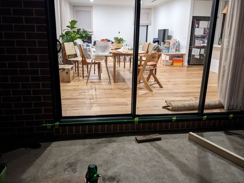

I'm about to commence a low level deck at my home. It's a concrete base with a ~180mm height clearance.
Was just about to commence, but I seem to be over thinking alot of aspects.
The deck will be 3.7m X 4.7m. I was initially having a ledger on both the sliding door side and wall side. Either bolted using ankascrews, dynabolts or even plugs with screws? I'm not sure what size but thought m8 X 90mm would be suffice? Thoughts? Alternatively I can not connect the ledgers directly to the house and just use L brackets bolted to the ground?
After the ledgers are installed I'll be using 90x45 joist to run inline with the ledger. I'll probably grab a few joist hanger brackets to connect the joist and ledger together for extra strength.

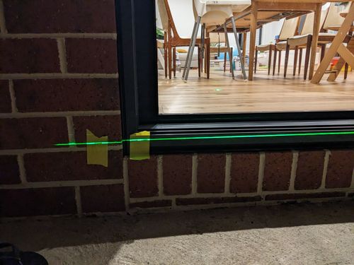

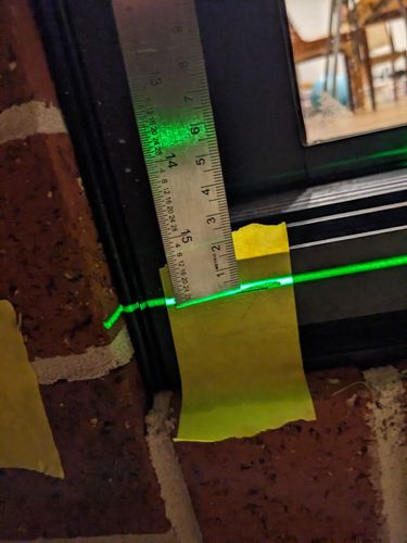

Secondly the sliding door seems to drop slightly at the opening. When I marked out the deck (using a laser level), it seems to drop 12mm over ~3m. As I want to build the deck inline with the sliding door if I make it perfectly flat it will be obvious as it's a monument rail frame that would be visible on one side and slowly disappear to nothing. Intention to have 2-3 mm of the rail sticking up above the finished floor height of the merbau. Can probably be seen and understood easier in the images.
