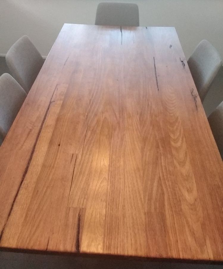

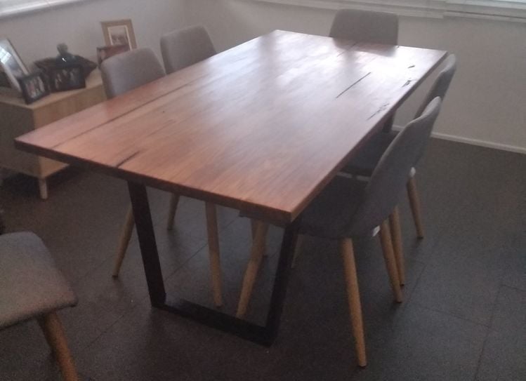

Being in need of a dining table and not a fan of flat pack, I made a new one using a Hardwood Laminated Panel and Rapidmesh Furniture Legs.
I cut the panel back from 2400mm to 1800mm and then rounded all the edges with a router. Initially, I just rounded the corners on the long edges with a hand plane and tried to sand the ends, but then I opted for the router on all the edges to get a better pencil-round finish.
To stain it, I used Bondall Walnut Monocel Stain and Varnish. I chose walnut to counter the lightness of the colour of the panel I had, and it helps to hide the joints in the panel. I used an applicator pad to avoid brush strokes, and the stain and varnish helped me achieve a more uniform colour.
