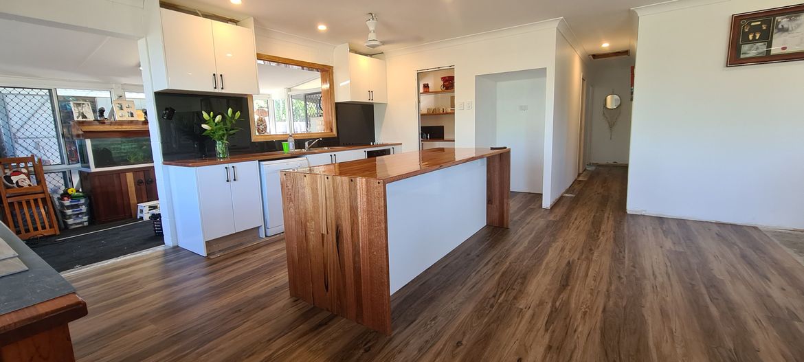

We installed a Kaboodle kitchen in egg white colour. The benchtops were made from solid timber panels. The splashback was an onyx-colored acrylic which added a nice highlighting colour touch. The same concept was used for the butler's pantry as well. Downlights were installed and the old oyster lights removed.
The whole project has given a complete facelift to their home. The guys that helped with the Kaboodle design were awesome, as is the online app that you can use yourself for designs. With the help of all the local Bunnings staff this project was made easier, but the labour involved was an absolute killer.

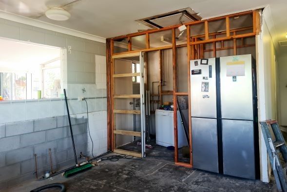

This is the original kitchen.

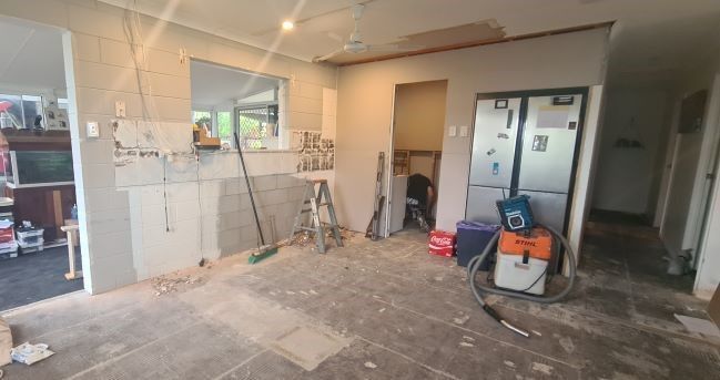

Firstly, the old kitchen had to go, and the adjoining laundry wall had to go, too, as did the entire laundry, which was moved outside.
All the floor tiles had to come up and the concrete floor had to be patched. My son and his wife enjoyed removing all the old floor tiles and then scraping all the old tile glue off the floor. They were impressed to say the least.

Then we put in the framework.

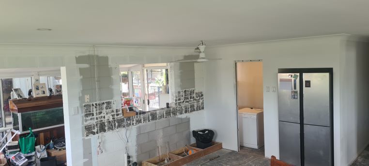

Then the plasterboard.

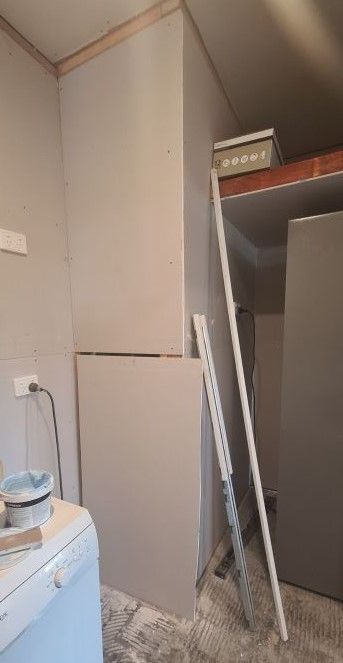

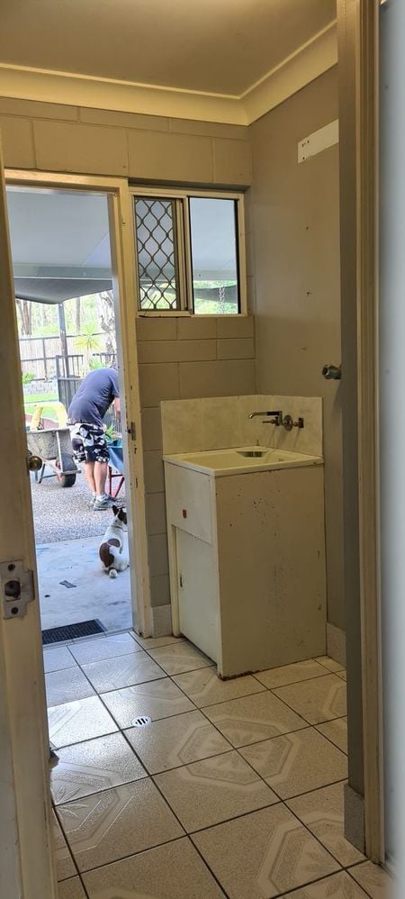

This is the original laundry. The laundry became a butler's pantry, and the linen press that was facing into the old laundry got turned around and now faces into the adjoining bathroom. Part of the old laundry formed a nook for the fridge, which really needed a home as it was sitting in no man's land, and a large bulk storage area was created above it in the pantry, which also included some open storage shelves.
We put the plasterboard in the old laundry area.
Then painted the kitchen.

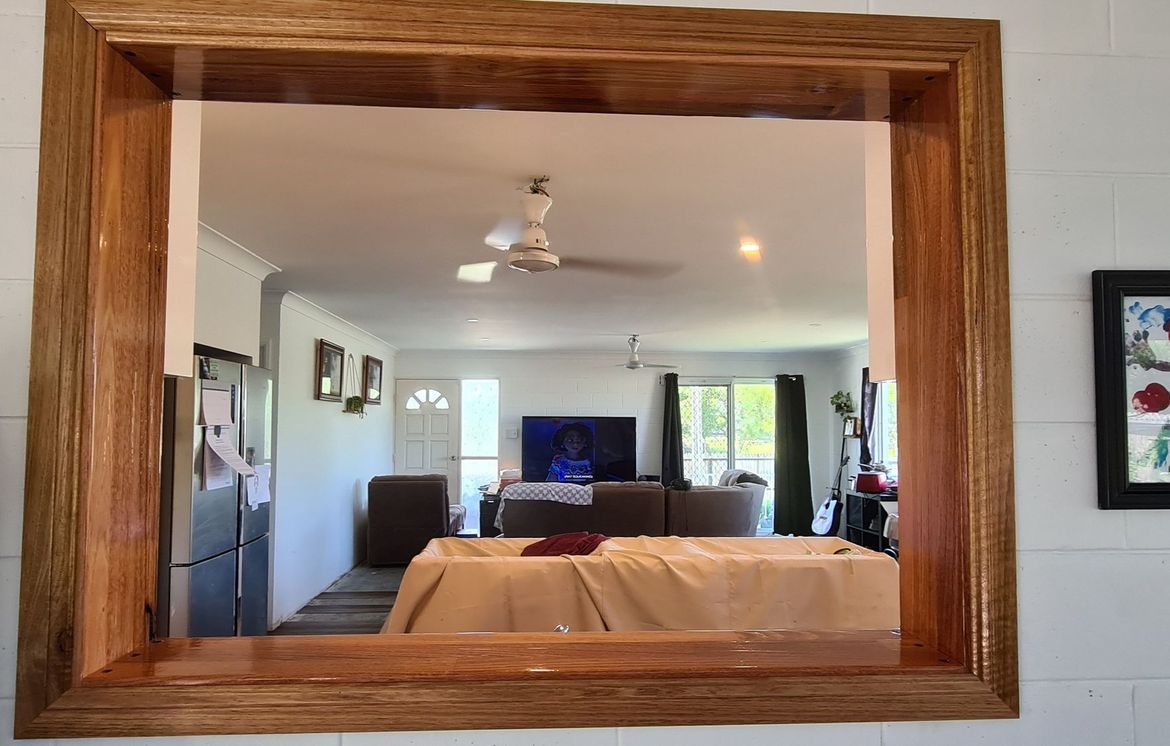

The window in the old kitchen was removed and a new opening created.

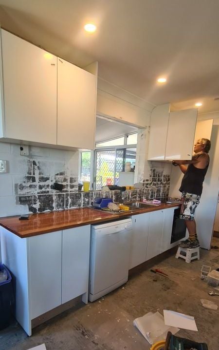

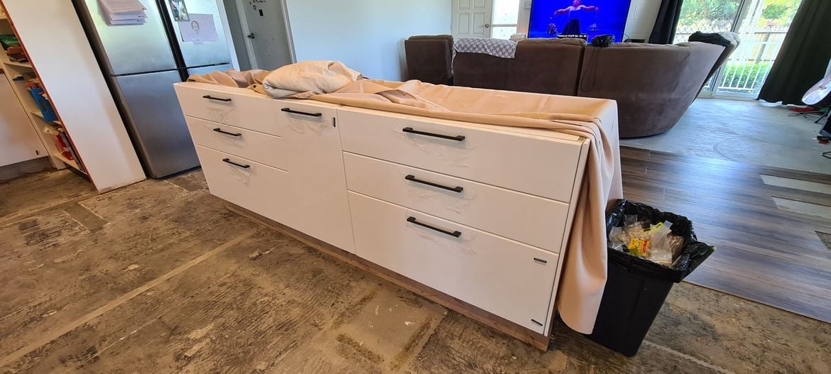

Then the cabinets were installed. We chose black handles for the drawers.

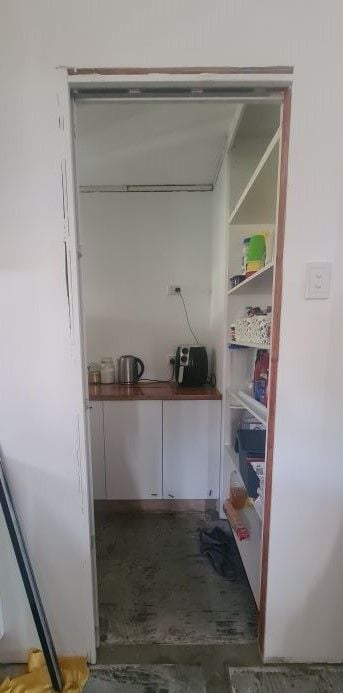

This is the butler's pantry in what was the laundry.

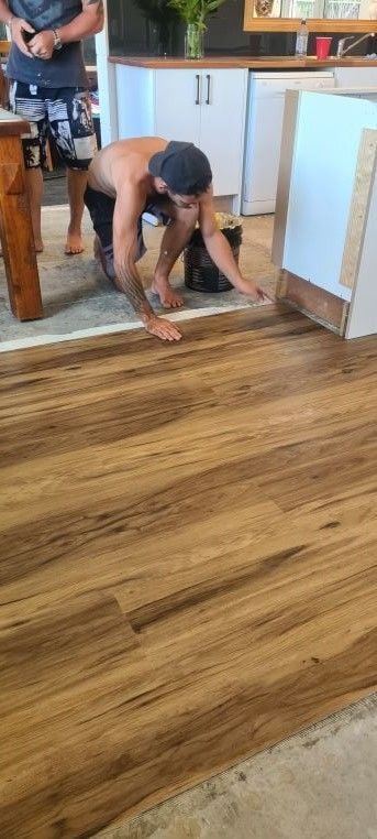

The new flooring was a kind of spotted gum vinyl tile which was also glued down.
