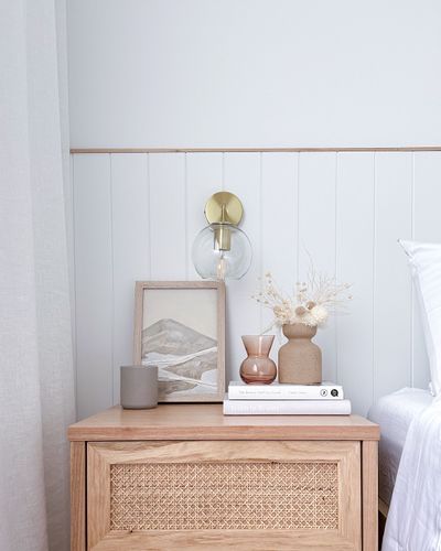

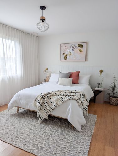

Now the fun part! Installing the panels. And to my surprise this was super easy. You just apply Selleys Hold up to the back of the panels and once it is in place I tacked a couple of nails into the studs to hold it while the glue set. To hide the nail holes I just used a bit of putty.
Step 5
I then did a final coat of paint and installed the 3x timber dowels on top to finish it off. In one of the photos you'll see there is no dowel, but the room looks so much more complete with the timber strip to break up the white wall!
