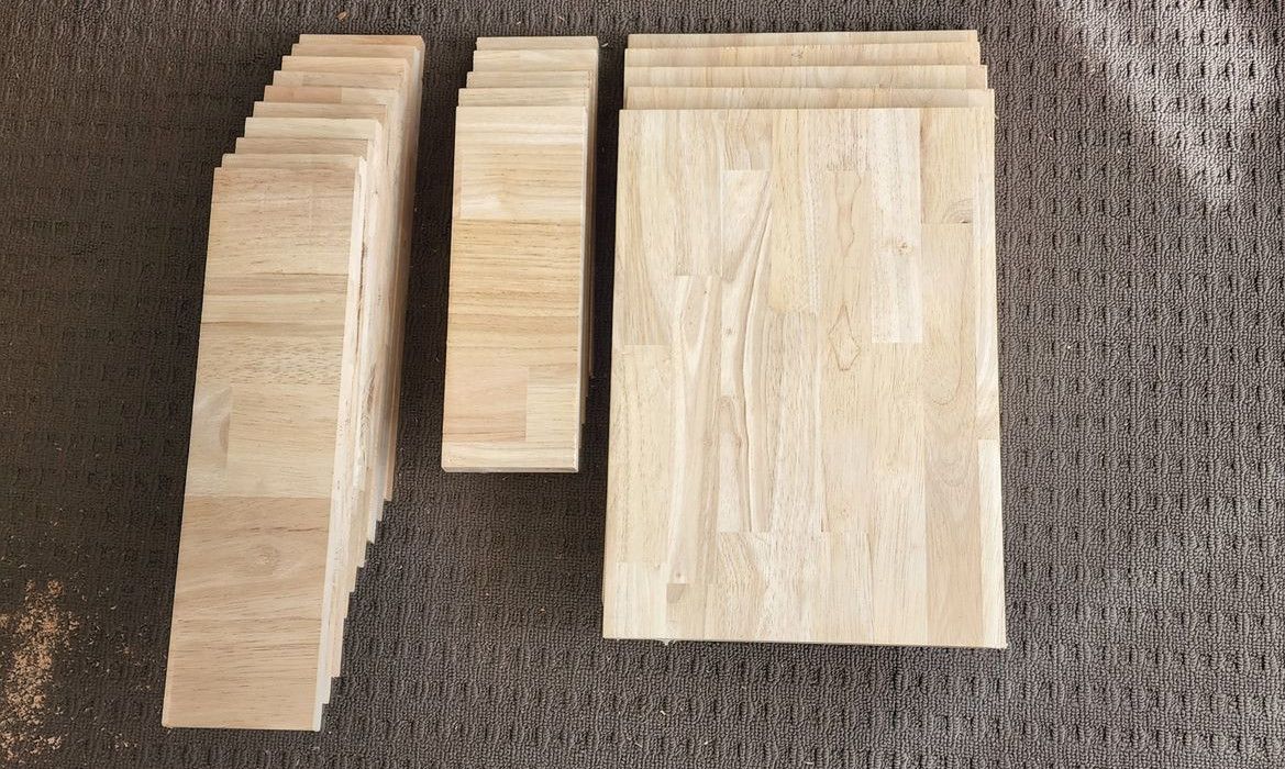

Once all the dimensions and cuts on the panels were identified, it was off to Bunnings to get everything and get the panels cut to size.

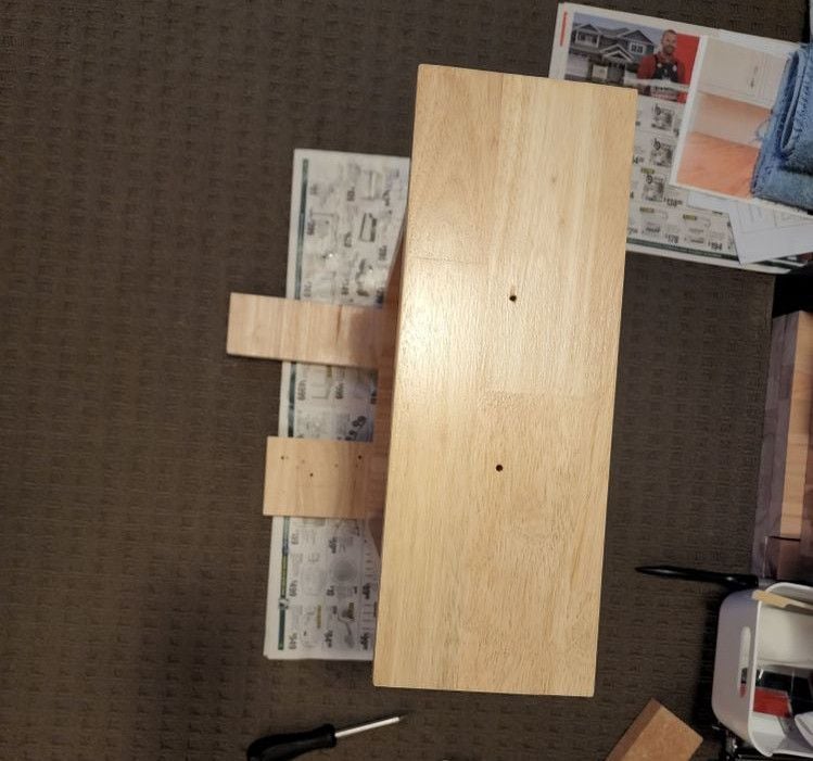

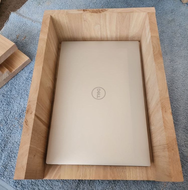

I started off first with making the drawers (without the front face), as per the above dimensions. I used long screws to screw the three sides onto the drawer base. Then I size checked with a 15.6" laptop for reference, with a little room to spare.

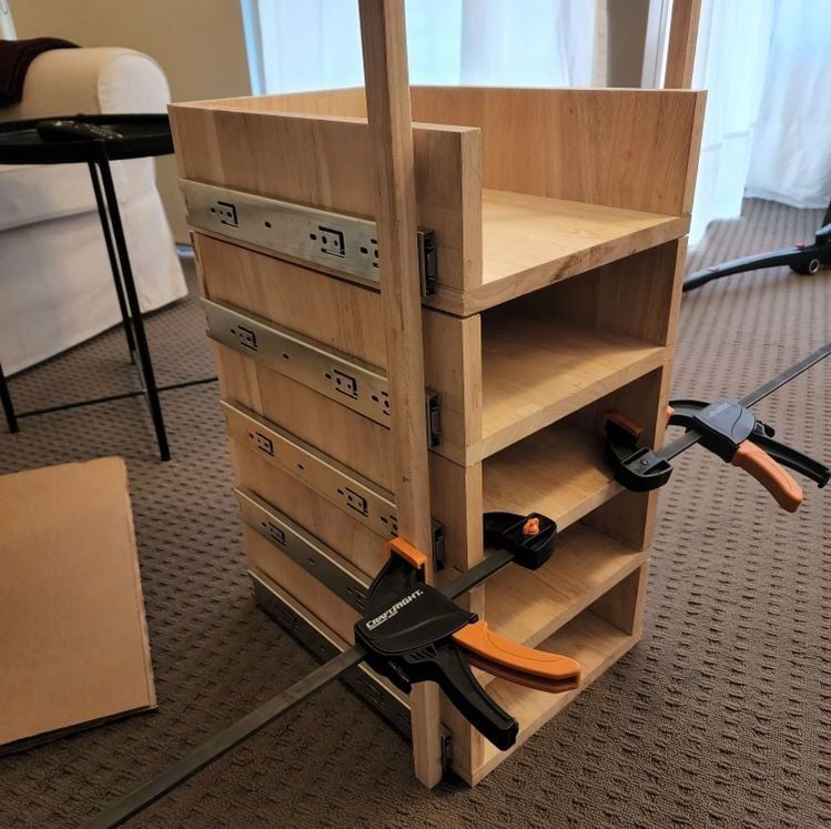

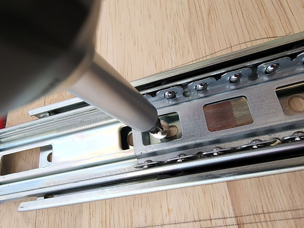

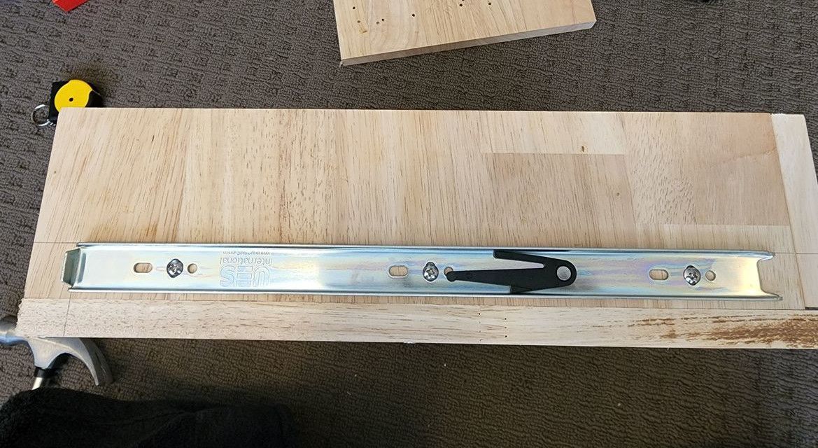

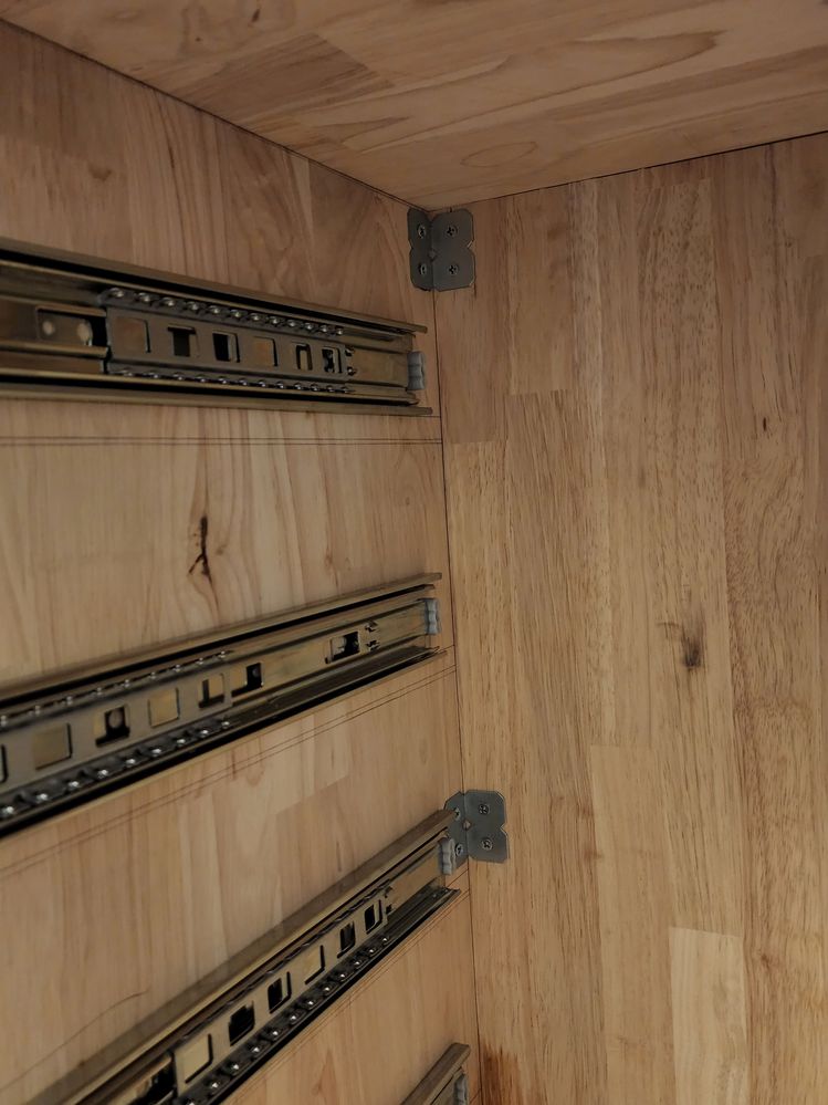

Mounting the drawer slides was a bit tricky. I mounted the drawer slides slightly below the centreline, vertically centred. This would allow the slides to run smoothly without fouling the drawers below.
Fitted the slides.
Once all the drawers were built and slides fixed, I used the off-cut pieces to measure and fix the dimensions of the cabinet.

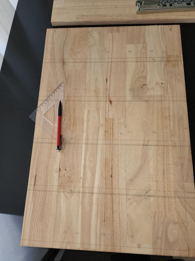

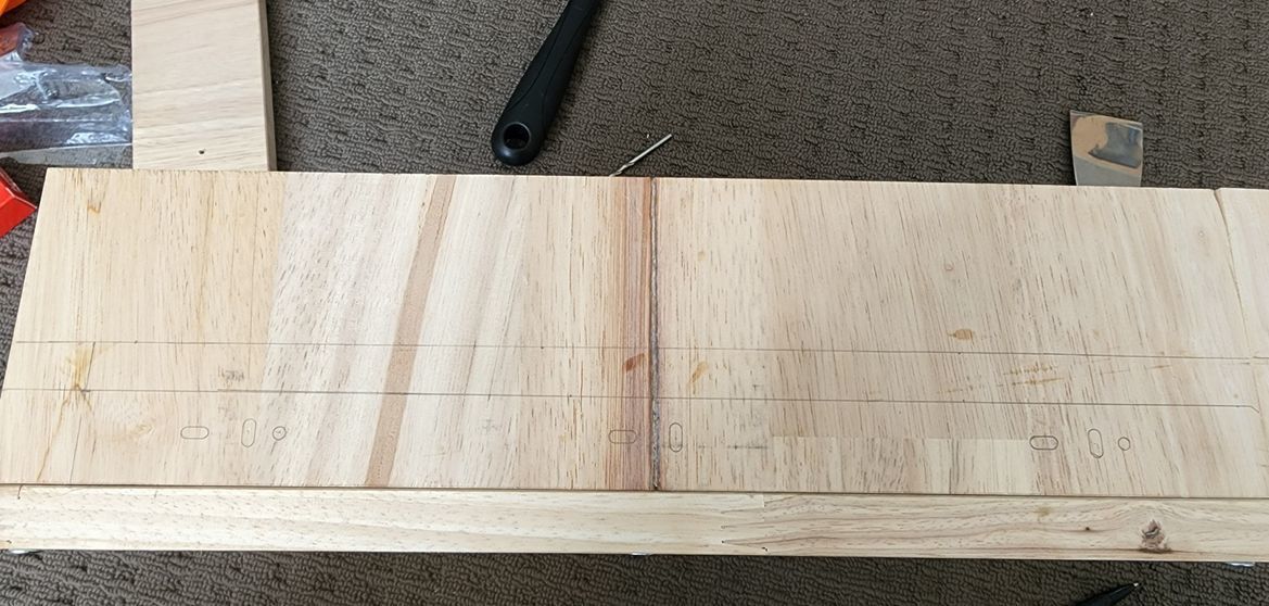

A lot of lines and markings to mount the drawer slides...

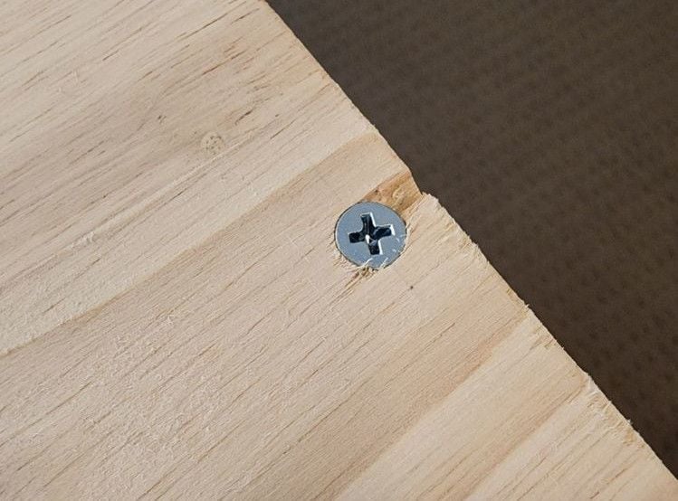

I discovered that rubber wood is a wood that splinters easily, so had to lower the drill speed. I had a couple of minor splinters like this, which were patched up with wood putty.

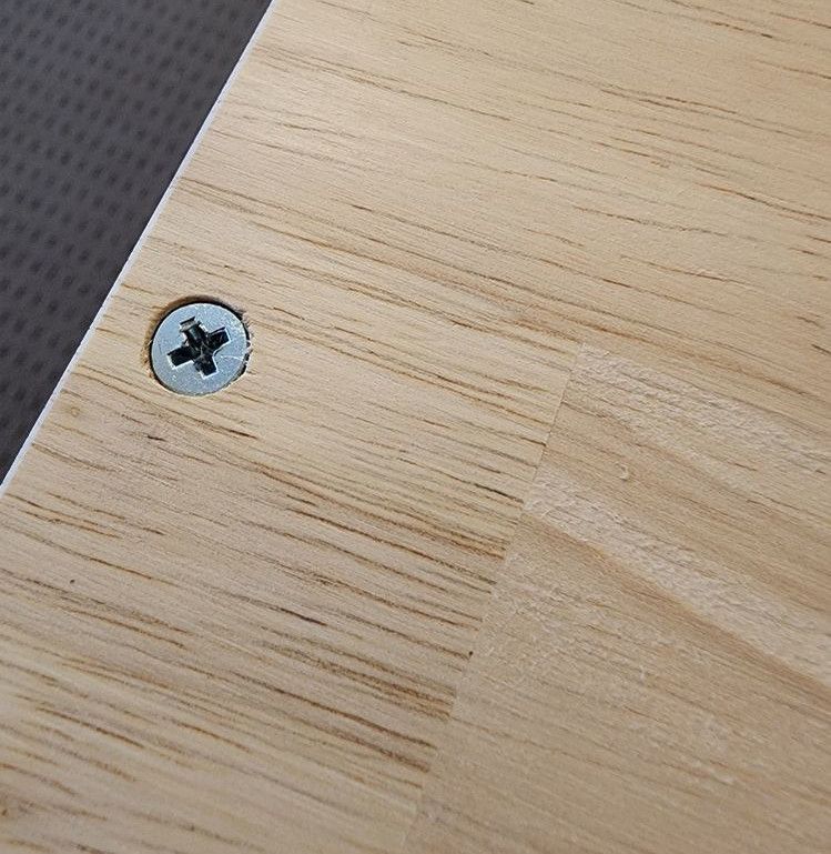

I counter sunk all screw holes with an 8mm drill bit, and then pilot holes of 3.5mm were drilled for 10G screws.

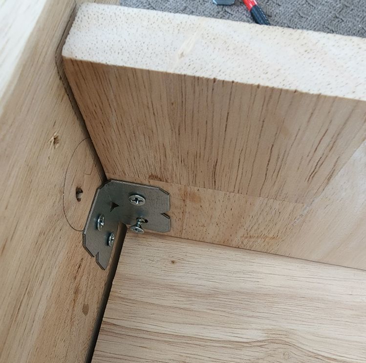

In addition to the screws, I used the Carinya Galvanised Angle Brackets (8 pack) on the inside of the cabinet for reinforcement.
Using the corner brackets on the insides of the drawers to mount the drawer face was a bad idea though - there was not enough space to get the drill driver to drive the screws in. It also impinged on the internal drawer space, so I switched to mounting the corner brackets on the outer side of the drawer. That was so much easier. All the excess drilling holes were later patched up with wood putty.

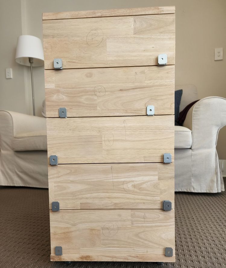

I used the Carinya Galvanised Angle Brackets as spacers to determine the mounting positions of the drawer faces.

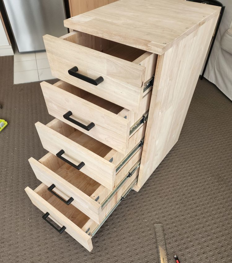

Once drawer faces were mounted to the drawers, a quick check (and adjustment) of the slides to ensure each drawer moves smoothly and doesn't foul with the other drawers. Handles were then attached to the drawer faces.
All the maths, planning, adjustments and accurate-to-the-millimetre calculations later, all drawers moved smoothly and closed flush.

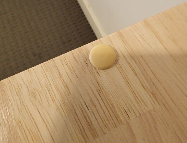

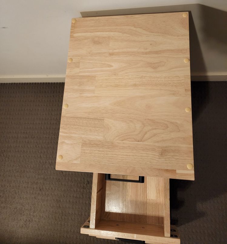

Now for the finishing touches. I removed the drawers, slides, and handles and filled gaps/excess drilling holes with Timbermate Pine Wood Filler and then sandpapered all surfaces with 80 grit sandpaper, then 120 grit and finally 240 grit sandpapers to get a smooth, almost silky finish.
I used Cabot's 1L Satin Water Based Cabothane Clear Polyurethane Timber Varnish - three coats were recommended, but I ended up putting on five coats because I wanted to finish off the can.
I used screw caps to cover the screw heads. Finally, mounted five Move It 30mm 20kg Grey Swivel Plate Castor wheels on the bottom of the cabinet.
All done. The Cabot's Satin Clear Coat gives a nice subtle sheen.
It weighs around 44kg unladen and has five castor wheels that can take 20kg each, so I'm confident this little thing can carry a fair bit.
