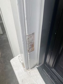

Anyone knows what Kinds of filler can I use to fill those holes before painting? Thanks.
I would say you have two options:
1. Cut a small piece of wood to fit as best you can, glue it into the slot. Tape will hold it in while the glue dries and then use a wood filler and sand it back.
2. For larger gaps you can use a product like builders bog https://www.bunnings.com.au/turbo-175ml-builders-bog-flexipack_p1670144?store=6431&gbraid=0AAAAADtbEB_-kue0ecRxUmWrNV9I_0Rbu&gclid=EAIaIQobChMIh9DVmeCz_wIVVJnCCh0DEQEWEAQYAiABEgI--PD_BwE&gclsrc=aw.ds
Hi @KevinPlant
Thanks for sharing your question about filling the holes in your timber frame before painting. It's great that you've received excellent advice from @Bomber25. I totally agree with the recommendations of using a thin piece of timber and gluing it to the gaps that are deeper before you apply UNi-PRO 500g Multi Purpose Interior Filler. Using Turbo 175ml Builders Bog Flexipack is also an excellent option to fill in the deep gaps.
My number one tip when using Builders Bog is to make sure not to add too much activator. Excessive use of the activator will immediately harden the bog giving you no time to adjust and flatten the fill.
Here is a handy step-by-step guide: How to patch plaster (the techniques used are applicable to your project)
