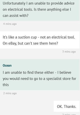

Googling gives me a sort of suction cup device...
I looked on Bunnings - but no luck with searches or Live Chat.
