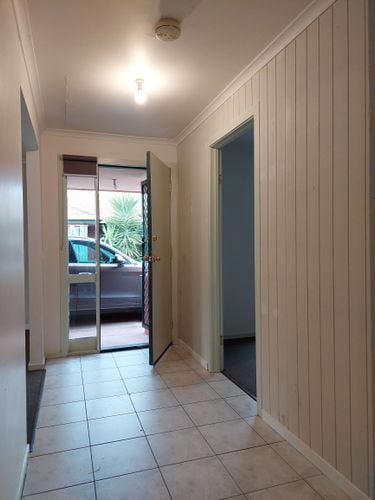

Our entry area always felt like it had great potential as a nice warm welcoming entry into our home. We decided to incorporate:
- VJ 100mm panels to modernise the space and wrap them around the door frame to frame the main bedroom door as well. This also meant updating the skirting.
- Lighter vinyl flooring to warm up the space. We laid these on existing tiles which worked out well.

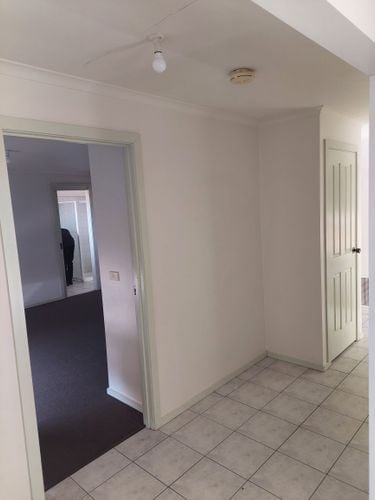

First we measured up.

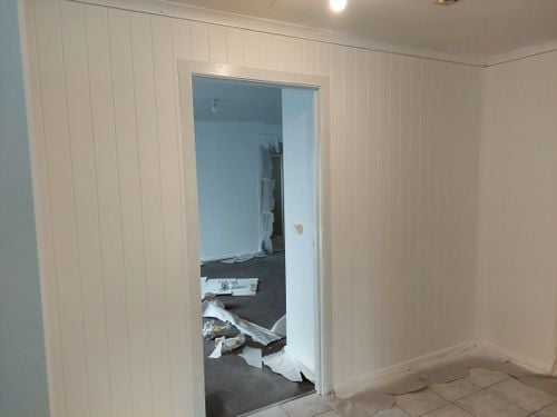

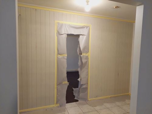

Here the panels are nailed onto the wall with new trims installed.
Before painting.

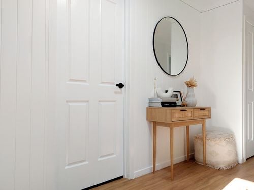

After painting.
The vinyl flooring install.

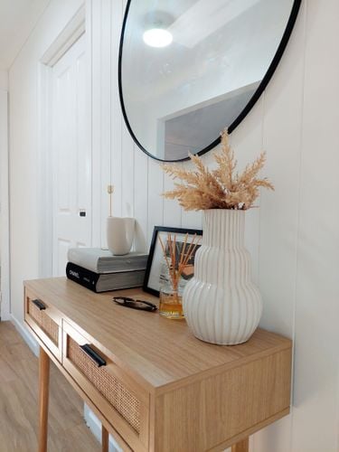

The Vivid White paint definitely allows for any light, however little, to bounce around. We were fortunate that the door faces east so the morning sun floods the entry pretty well.
