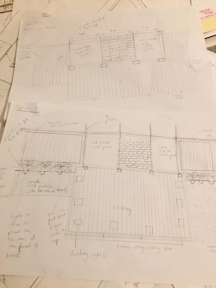

1. Plan, Design & Draft Drawings
* Completed draft designs and measurements of the project for approval and permission requirements.

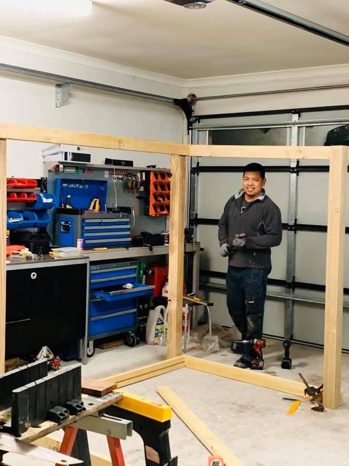

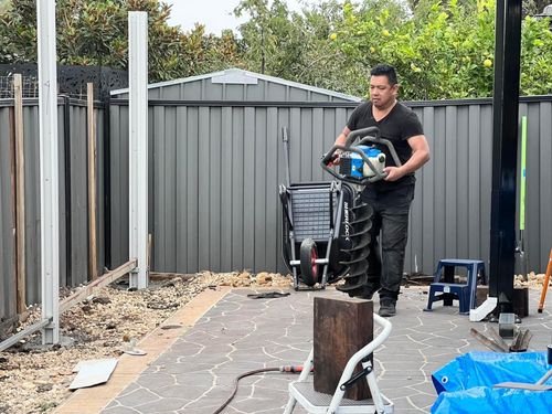

* Dug required depth for posts and frames.
* Used concrete to secure posts and frames.
* Completed posts and frames.

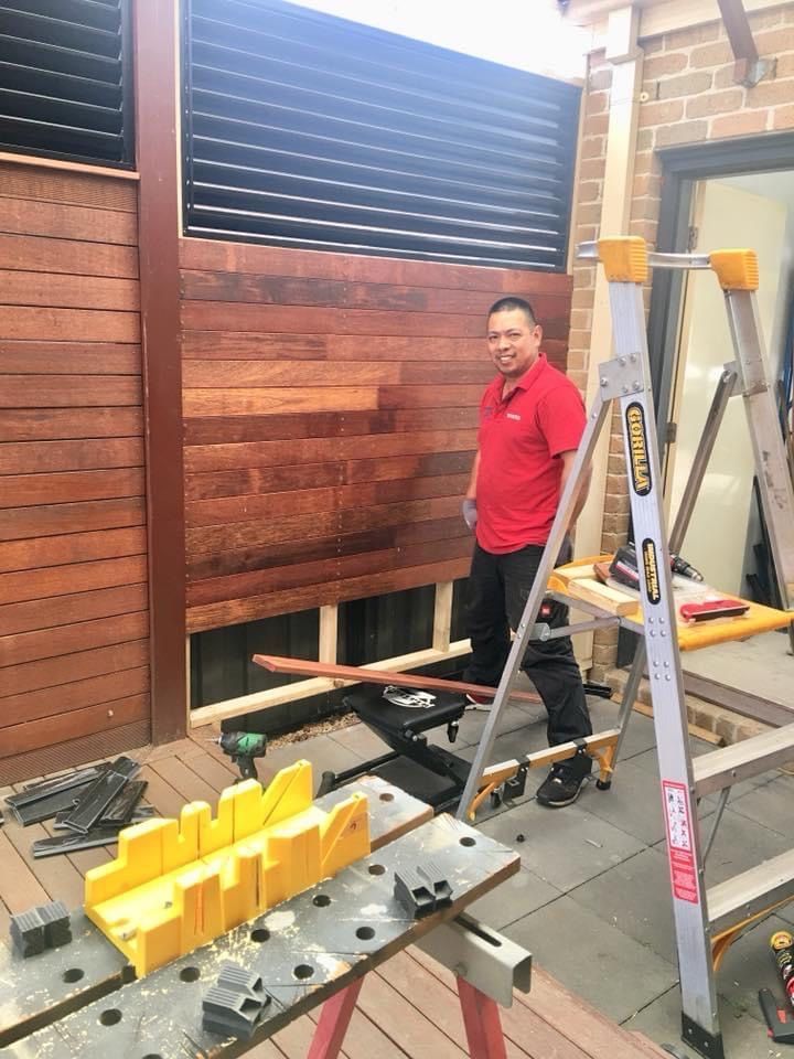

3. Roofing & DIY Aluminium Shutters
* We decided to close off the side yard so it's also accessible in the rain.
* Skylite Roofing & DIY Black Aluminium Shutters cut to required measurements, built, assembled and installed.

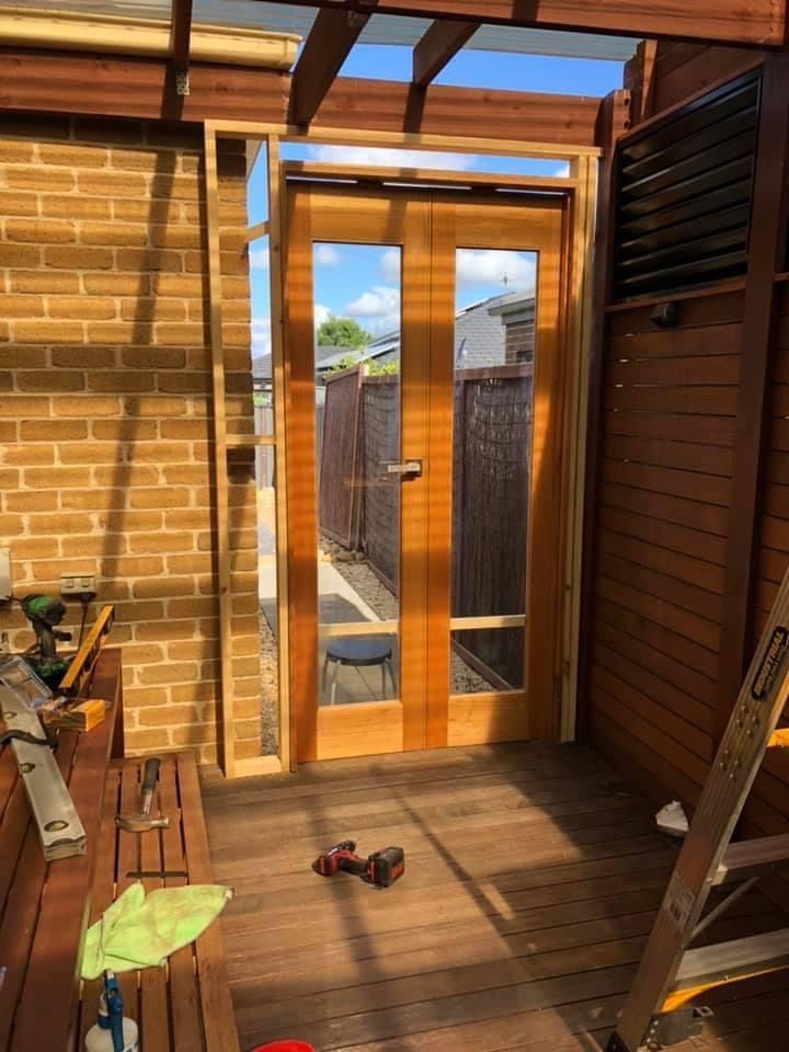

4. Door
* We bought the door second hand from Gumtree to close off the side yard for safety purposes and block wind.
* Built frame around the door so that the door can fit as required with no spaces.

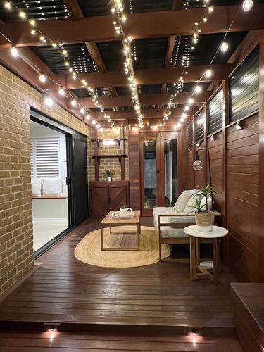

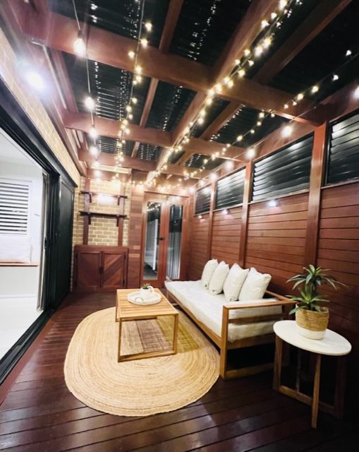

8. Lights
* Added more lights to brighten the area at night and so the space can also look more warmer and inviting.
* Fairy lights (heavy duty) also added to the extended deck area.
Step 9

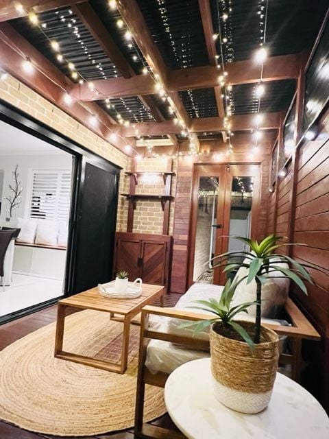

9. Decor
* Assembled all the decor and laid out jute rug.

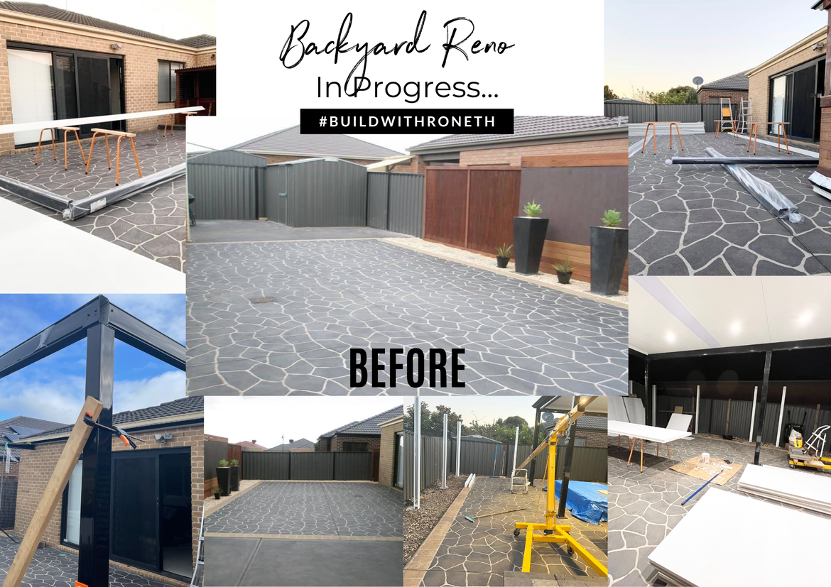

10. Before & After Pics
* Progress to completion.
