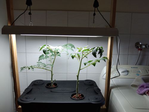

Step 1
At the moment the tomato plants are just sitting in water
The instructions on the fertilizer packet suggest leaving them in plain water for 1 week..Then for the next 2 or 3 weeks they will sit in a water solution with 50% addition of fertilizer..
Then at the beginning of the fourth week a full strength water / fertilizer mix can be put into the tank.

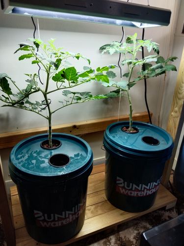

Step 3
I've now transplanted the plants in to larger containers..Bunnings of course. Ideal for the job.
Evidently tomato need a lot of nutrient constantly to keep up with their growing needs.
Stage 3

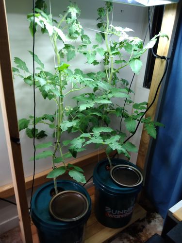

Step 4
The tomatoes are now showing some upward growth.
These tomatoes are called an indeterminate type and can grow up to 1.8M. tall.
Stage 4

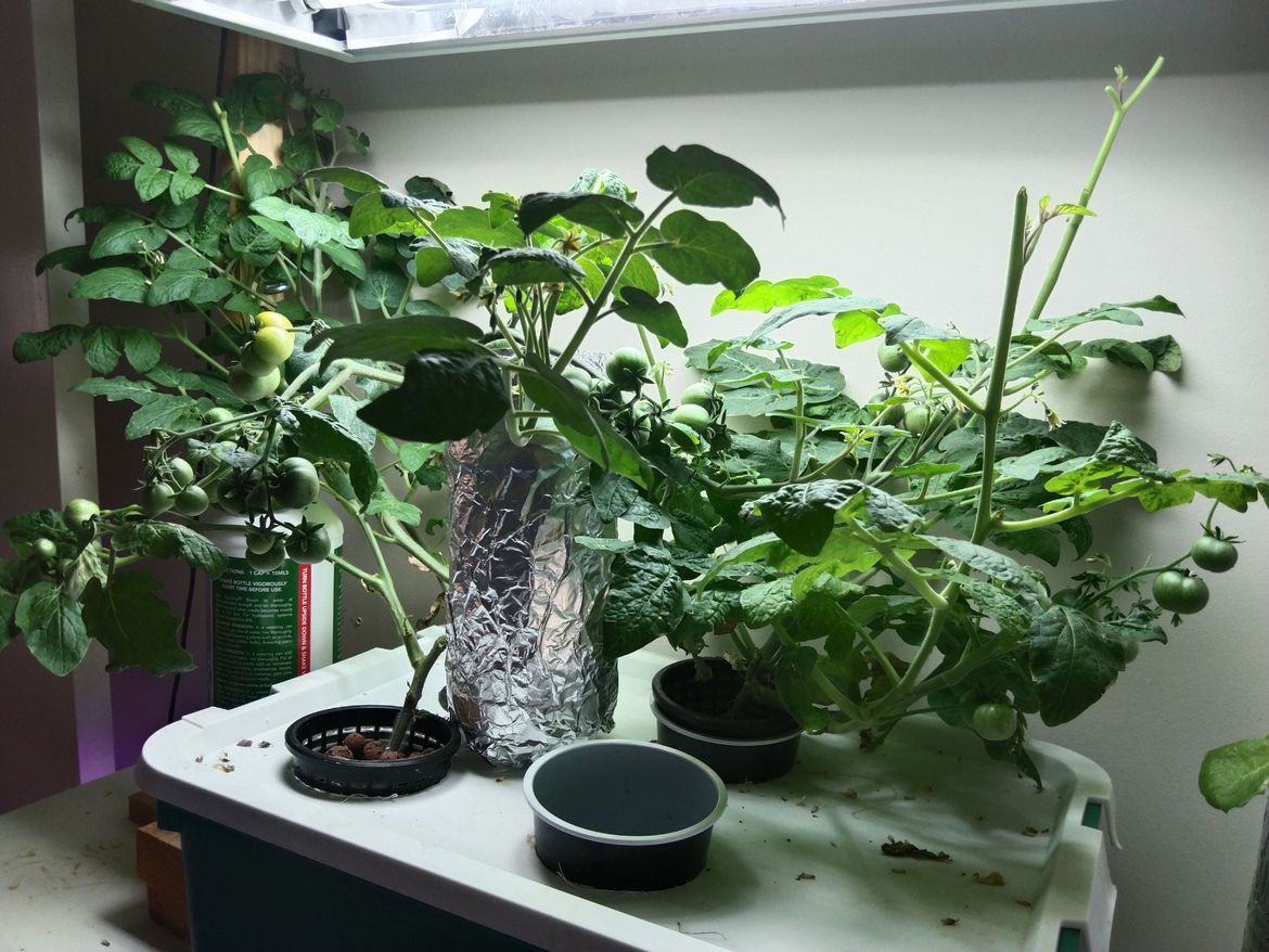

Step 5
In the meantime I've started to grow some capsicums.
They are initially started under red / blue LED grow lights.
These plants took a long time to grow, so I won't be showing any further updates.

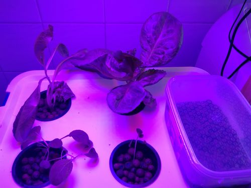

Step 6
Next on the list are some cucumbers.
Stage 6
As you can see from the photo..the seeds can be propagated in just some cotton wool.
For the other plants I used Rockwool cubes placed in a small humid crib type container.

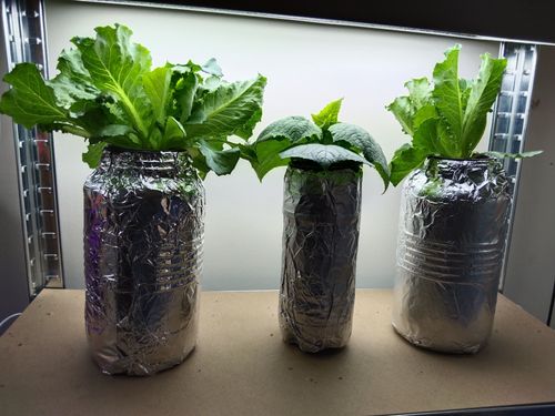

The next stage of the vegetable production was to grow some lettuce.
Stage 8
The containers to the left and right are the Mason jars..They are glass jars..normally with wide mouths and screw-on lids.
They are clear glass ( the reason for the al-foil covering) which would normally allow light to enter into the roots.
This would then cause the roots to go brown and eventually die.
The container in the centre is a cut down plastic coke bottle. It does the same job and is a lot cheaper.
