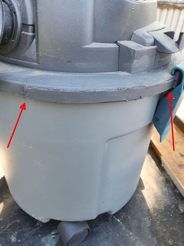

Ugly but Strong.
This is polyurethane glue. Plastic to plastic.
A cheap shop/vac fell over and shattered the very thin plastic lid rim. I cut a strip of plastic from a newsagent magazine holder and glued it in place with clothes pegs to hold the position. The glue expands as it dries and this is trimmed off with a utility knife. Sprayed with matt black.
Not pretty - but very strong. The area is now stronger than the original.
Just an example as to how good this glue is. Bunnings supply it.
