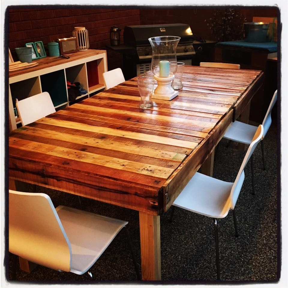

You can get full instructions for building this table here - How to build a pallet timber table
Hi Rob, do you have instructions for this table.?

@Pat1 I tend to make things up as I go along - quite literally! For the table I had four pallets - two of them I took apart completely. I inserted the strips of wood from the pallet taken apart into the gaps on the other pallets to make the table tops solid. Some planing was needed. The fact that all of the wood was slightly different shades added to the overall effect. I sanded for smoothness, but left on paint marks where possible. The rest of the table was just about strengthening underneath and joining the two pallets. I then added 6 legs which was wood from Bunnings and secured with brackets.

Great job on the table @Peggers it came up awesome. Well done.

love thismy hubby made one painted the bottom blue and i love this but will be doing some sanding on the top to rough, love yours

Lovely job with repurposed wood, very inspiring, Dave880

Brilliant can you please mention what colour stain you use?

This is so nice, you would never say it was pallets.
