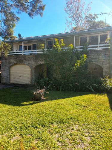

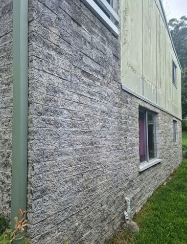

Wanted to freshen up the curb appeal of the house on a budget. I also loved the stones through the bricks so didn't want to cover with thick paint.
Please see steps 5, 6 & 7 for more before & after photos.

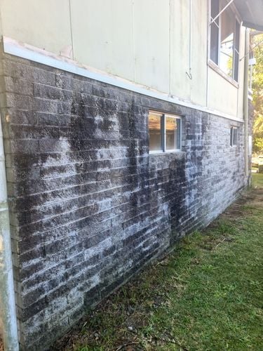

First i used 30 seconds outdoor cleaner and gurney although I didn't get great results.
Step 2
I then used a mixture of of half chlorine & half water, left it for 20 minutes before gurney the bricks clean.

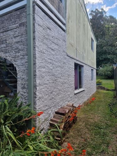

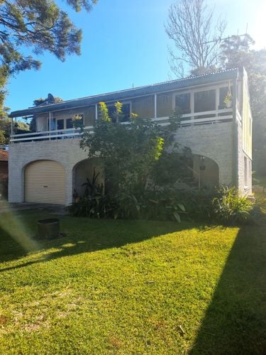

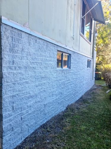

I then used 1 part hydrated lime and 4 parts water and painted it on with a fence brush.
Step 4
I allowed it to dry and cure over 48hours.
