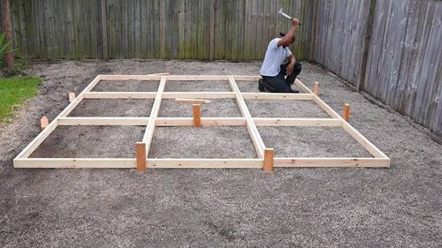

I am doing a little patio with some concrete pavers. Pavers will be bigger than what is available off the shelf.
I'll be building the frame work for it. Similar to the attached photo.
Now in terms getting it perfectly square if the timber has a bow to it I can straighten that with the frame and screws. But if it has a crook then there is potential that my pavers wont have a flat surface
and have a concave or convex shape as when putting the concrete down I will use the frame work to screed.
Besides visually checking for crook timber, is there a reliable material or alternative suggestion?
