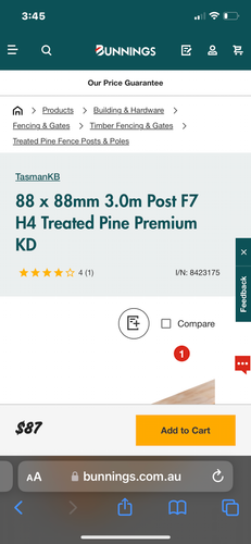

Hi Mitchell,
would you recommend the below posts? also what would you use for rails? cheers
That would work, @Ryan1980. It is a milled smooth post, and you won't find rails that are not rougher header. It would be used if you were going to pair it with 90 x 42mm 3.6m F7 H3 Treated Pine Primed LOSP and paint the fence. Typically, you'd pair 90 x 90mm 3.0m Post F7 H4 Treated Pine Premium KD with 90 x 45mm H3 for the rails.
