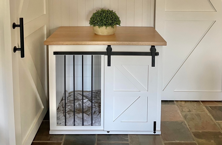

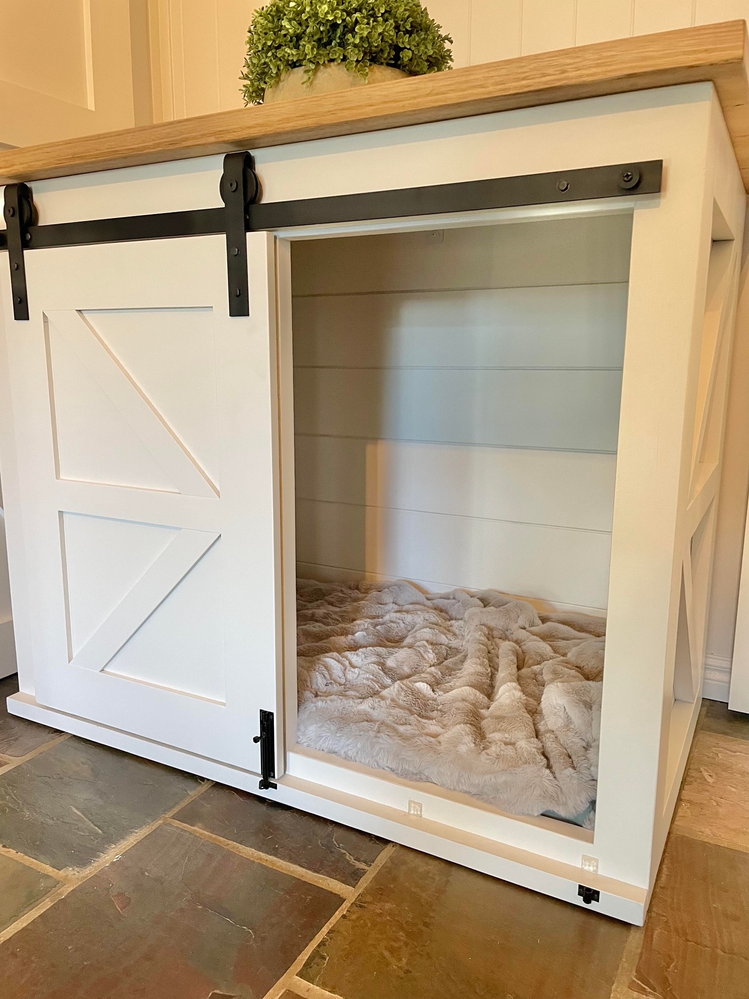

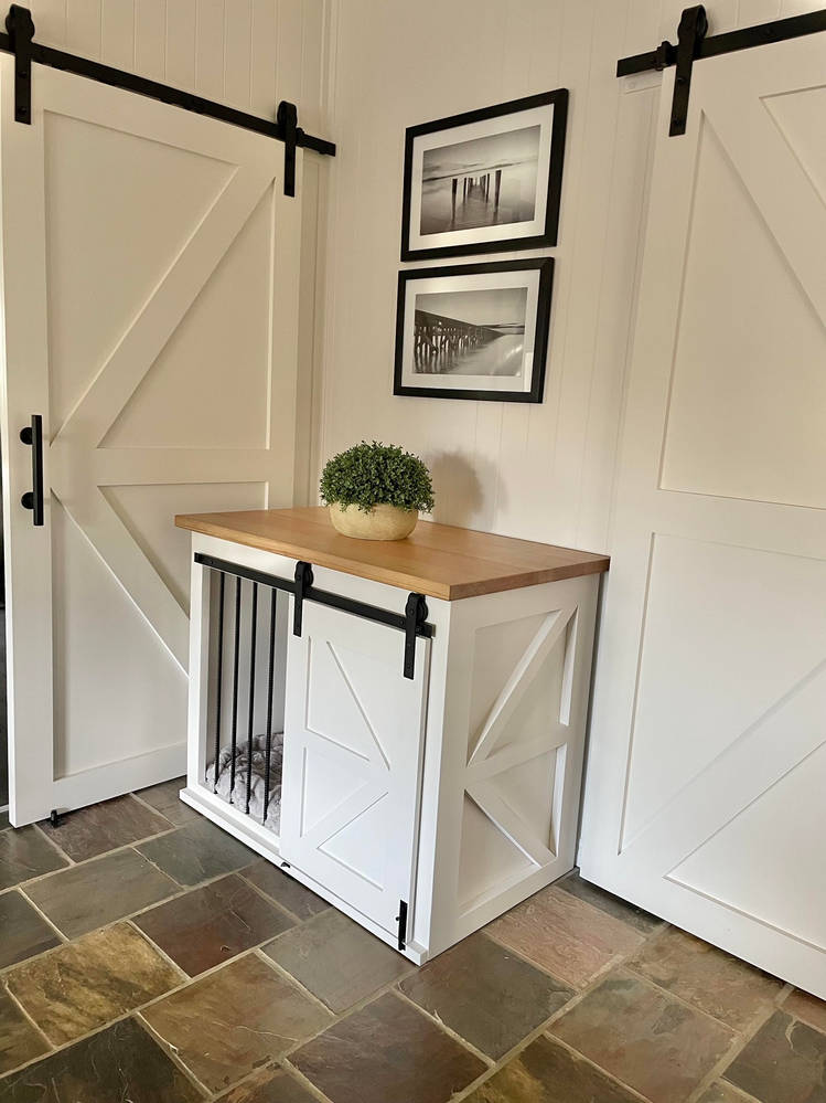

This is my latest project - a dog crate buffet cabinet with a sliding mini barn door. This is used as a safe place for pets to sleep.
The cabinet was constructed from recycled materials such as Pine, reinforced steel bars and the hardwood benchtop. I managed to find a set of cabinet size rail track which was a perfect size for this job.
Installing the reinforced bars was not as difficult as it looks. I was able to insert them after the painting was finished. I drilled the holes at the top deeper than the bottom so when I went to slide the bar up, it cleared the bottom beam, then I could slide the bars back down into the bottom holes.

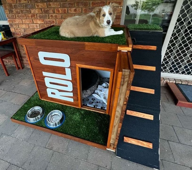

Workshop member patorodriguez built this dog kennel with ramp and rooftop so his dog could climb atop his new home.

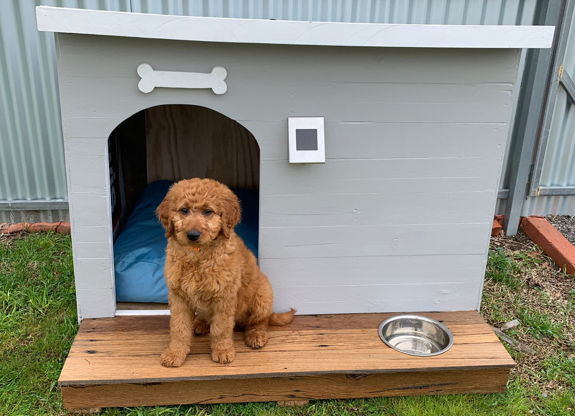

Community member Amy used different varieties of timber offcuts to build her dog kennel with solar light.
