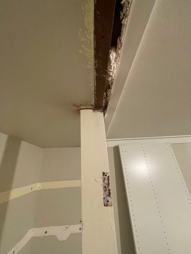

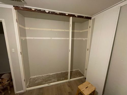

Just wondering if anyone can tell me whether the central part of this wardrobe frame is a supporting structure? It is attached to the beam running horizontally across the top - which also extends into the roof cavity.

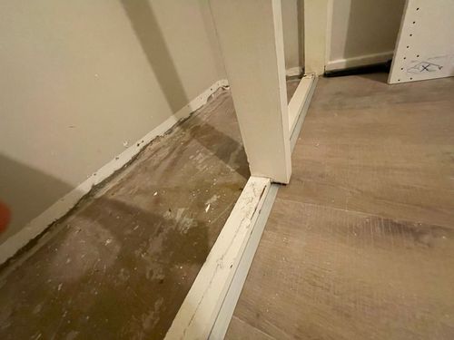

As per @Jason - but to my eyes it looks like a built in cupboard was created after the house was built. That remaining piece supported the right hand door of the cupboard and assisting in the closure of the far right door. Looking even closer - the base has been undercut to fit the floating floor.

Going through your photos reminds me of one of the first rooms I "updated" in my house. I had an alcove off the side of a bedroom but for me I had a header board across the alcove. That supports stuff in the roof so I didnt touch it. With yours I am not sure. Have you looked at it from up in the roof? Usually you can see the structure of walls reflected in the relief side. To be safe Id suggest to get a carpenter at least to have a look.

With the baseboard be prepared for it to be the bottom plate of the wall, with all the stud slots chiseled into it. (I had to remove mine and then find a matching timber piece and pack it up so it would be level.

Thank you so much for all your advice, @EricL, @Dave-1 , @Noyade, @Jason. I managed to get a bit more access into the gap and discovered that the vertical beam is not actually attached to anything in the roof space, and the two other vertical beams are supporting the horizontal one. I’ve gone ahead and removed the central beam with no issue. Thanks again for your help, I appreciate it!
