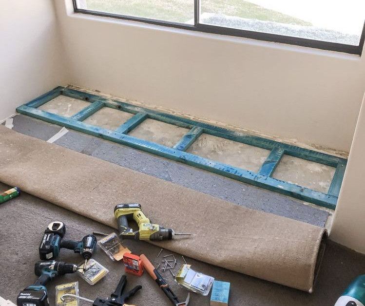

The first job was to pull back the existing carpet and remove the grippers and flooring from the area, ahead of the framing.
The framing served a dual purpose. We needed to create a stable base to attach the carcasses to, but also needed to elevate them off the floor slightly. We used the blue treated Pine for this, which you can buy by the lineal metre. Our concrete subfloor was a bit brittle in places, so we plugged, screwed, and used Liquid Nails to secure in place.

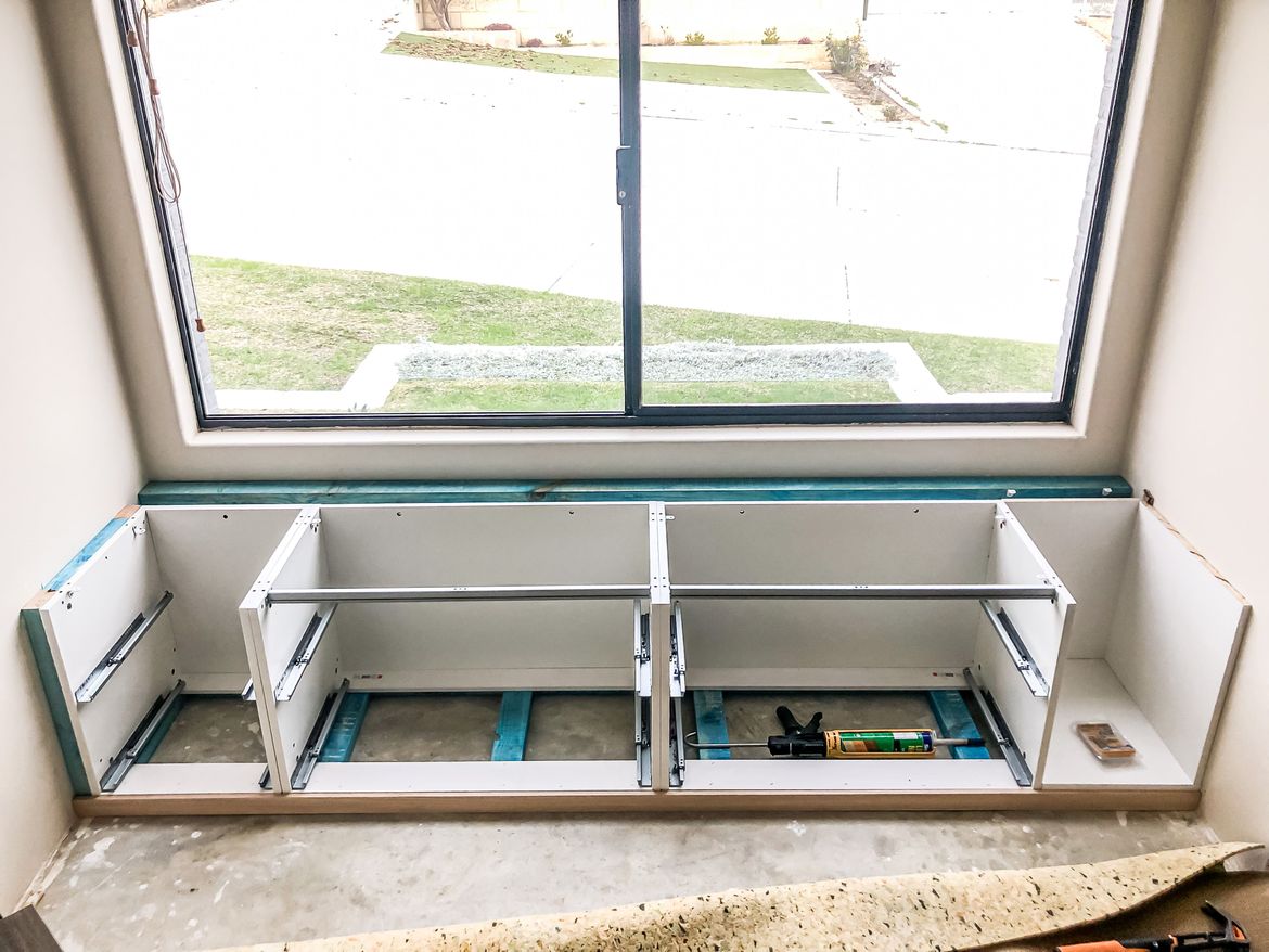

The drawers were then built and placed on the framing before screwing down. We didn't have quite enough room, sadly, for another small set of end drawers, so we decided to make a shelf space for storage. The other three sides (one side being the drawer end) were framed out using white Melamine shelving which we cut to size.
We set the framing away from the wall to allow another piece of the timber to sit securely on top of the drawers at the back. This was done to allow us to have a stable structure to attach the timber top onto. We added some pine framing down the left-hand side of the bench seat to make sure that we had adequate room to open and close the drawers. We also used a small piece of timber along the bottom to hide the framing.
