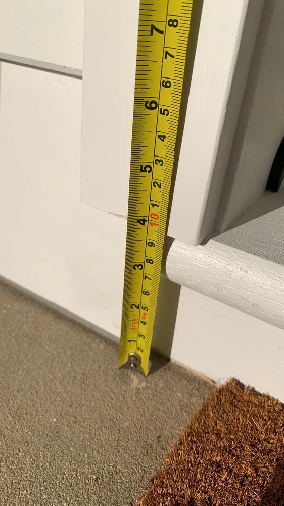

I’m trying to get my head around building a low-level timber deck over a concrete slab with minimal clearance.
The details:
The timber board would be Fijian Mahogany, 140x21mm.
The clearance between concrete slab and top of the door threshold is 95mm.
The clearance between concrete slab and bottom of the door threshold is only 65mm.
I’m thinking the following;
I cut into the door threshold and use 70x45mm joists (70mm joist + 21mm board = 91mm).
The finished floor level would then be only 4mm below the top of the threshold. I’m guessing this might be a terrible idea with a door facing west…
OR
I cut into the door threshold just enough to fit a 90x45mm joist on its face (45mm joist + 21mm board = 66mm).
Would this be enough space for ventilation between slab and the timber board to last, let’s say 10+ years?
What would you do?
Perhaps composite decking would be more suitable but I would prefer timber both because of look and to keep the cost down.
