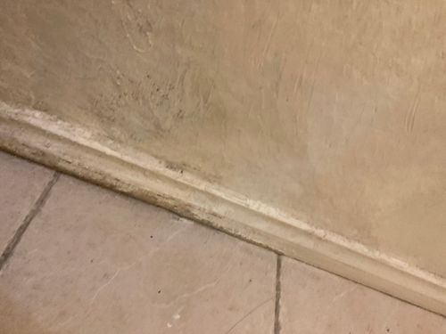

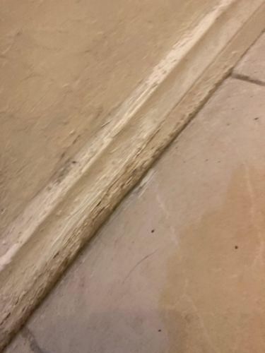

Hello,
please any tips on fixing this rough textured wall and skirting?

Do you know what your walls are made of? It certainly looks like some rough repairs were made in the past. If members had a little more information about your walls they might be in a better position to suggest next steps. It could be that new plasterboard sheeting and replacing the skirting boards might be the best option rather than trying to repair.
Let me tag some very helpful members in @Brad, @Renowayoflife, @Jewelleryrescue and @Remarka6le to share their thoughts on how they would go about tackling this project.

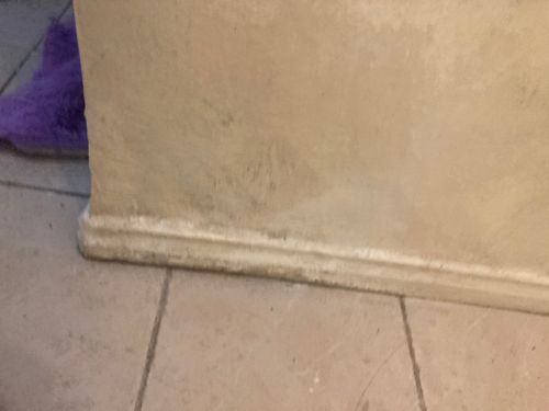

Hey @PatGirl1 , when you say "fix", are you looking to simply paint over a patch of discolouration? Looks like the skirting strip might be lifting up off the tiled floor as well?
It's a bit hard to tell by the photos, but there is possibly some moisture coming through from behind the wall? And possibly a previous owner/tenant used one type of paint to cover both wall and skirting strip. Some types of skirting are MDF, which won't hold up well in wet areas like bathroom and kitchens.
Example:https://www.bunnings.com.au/hanwood-2-4m-beige-oak-vinyl-wrap-floating-floor-scotia-trim_p0227383
Send through some more information, the Workshop community will be able to help 😊
Good Morning @PatGirl1
Our floor edges certainly take a beating dont they.

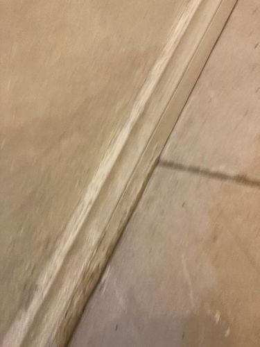

If you just want to smooth out the rough parts of the timber then you could use something along the lines of a timber putty Timbermate wood putty
This could then be sanded to the same shape of the existing skirting boards.

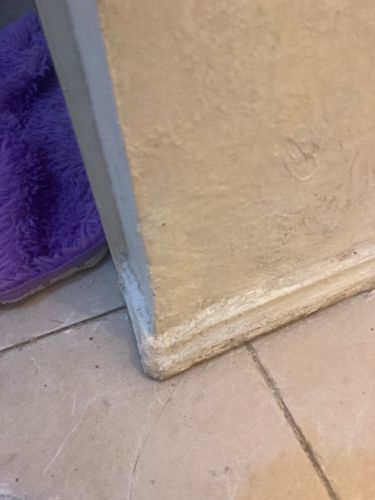

For the corner you could do the same tho I am not sure how sharp a point I would go.
For sanding the existing trim I would hand sand using a sanding cork block and maybe start with 120grit sandpaper. Ive also used the bottom end of a marking pen wrapped in sandpaper to do those fine curves.

It does look like water damage on this side of the monitor. Do you think it is?
No, its not water damage. It’s been painted over a few times.
Morning @PatGirl1
Do you know where the water damage came from and have you fixed it?
If you know the water damage has been fixed Id be tempted to remove the timber skirt and either strip it back from the existing painted surface or replace it.
If you remove it make sure you run a sharp knife edge along the top where the trim touches the wall to cut the paint so when you lever off the skirting board you dont take more paint/paper with you. It may sound scary to do but really is one of the eaiset jobs to do. (I was surpprised when I did mine)
Once you have sliced the paint, try to put down between the skirting board and the plaster a paint scrapper at least 50mm wide. Then once that is down you can slip a flat head screwdriver down between the metal plate and the timber to lever thetimber away gently. This way you are least likely to damage the plaster wall with the levering force needed. You will see the nails that hold the skirting to the wall and if you are going to install a new piece of skirting Id suggest to mark the wall with pencil where the nails go into so you know where to nail the new piece or old piece if you redo it afterwards.
You could still sand the chanel like I suggested and leave in situ if you are happy with the water issue being where it is.

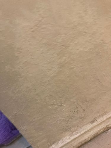

Due to the multiple coats of paint and the rough texture that has developed, you'll likely need to sand the surface back to achieve smoother results. I recommend you start with 180-grit sandpaper and move down to 120-grit if needed. A sanding float will help you achieve a smooth and even surface. Once you've removed the majority of the texture from the wall, it can be skim coated with plaster before priming and painting.
For the skirting, you'll likely need to spend some time hand-sanding. If you can't achieve sufficient results, I suggest considering replacing the length with a new skirting.
Before you begin, please verify that the wallboard does not contain asbestos and wear appropriate PPE, including a face mask and safety goggles.
Great Thanks Mitchell. However, if the sandpaper, plaster priming and painting does not fix the equal balance and smoothness of the wall, could I fix it with a filler product or something similar?
Hi Simon, thanks for your great observations of my repair job. It’s actually a toilet room’s wall. Yes, the wall has lost its colour of paint, smoothness and balance of a straight wall. There maybe a moisture problem and the skirting has arisen. What type of skirting should I buy for moisture problems please? And what are your ideas to fix the unlevelness of the wall? Isn’t plaster a very thick texture? Is there another product that is like a finer filler to fix the problem?

Also,please do you think it’s better to staple, glue or nail a skirting because this skirting has no nails. What products do I need ?

There will be timber behind the plaster somewhere, it can be hard to find without a stud finder (yes I have dozens of holes in my plaster hidden by the "new" skirting board 🙂
So for your first question
-The wall looks like its been made to be "textured" so it may take a lot of effort to smooth out via sanding but that would probarly be the best outcome way. Second best outcome way would be to use plaster compound and then smooth it over and then sand but that would be a LOT more work. I have done this with joins ect before and that generates a lot of plaster dust from the effort. Either way should work.
Second question
- Nail the new skirting board with 45mm bullet head nails. When you remove the old skirting board you should see either a base plate underneath or the actuall stud walls. The Skirting board I would use is timber Primed mouldings (Skirting Boards) There are so many to choose from. I would suggest to go with something that is rectangular (on the end shape) as the corners will be easier.
Hello @PatGirl1
I agree with @Dave-1's suggestion to find the studs first so that you can fix the skirting board to the wall. I also recommend using an adhesive such as Selleys 420g Liquid Nails Fast Grab Strong Adhesive to anchor the skirting board to the wall itself. The nails used on it is there to hold the skirting board in place until the adhesive cures.
It will be necessary to over drive the nails so that they sink into the skirting board. In order to cover the nail heads on the skirting board, I suggest using UNi-PRO 500g Multi Purpose Interior Filler. Once the filler cures you can sand it flush with surface to get a flawless finish.
