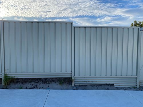

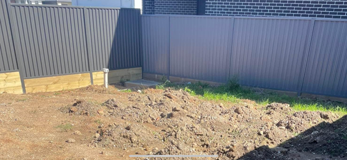

I would like to know how I can replace the plinth under the fence with concrete slabs to stop sand coming through from the other side. I have included picture of my current fence and the fence I would like it to look.

Thanks for sharing your question about replacing your fence plinth with concrete slabs. You'll notice on the second picture that you posted that the plinth or sleepers are actually installed inside the fence post of the Colorbond fence. Technically it can be duplicated but that means that the entire fence must be taken apart in order for the sleepers to be slipped into place.
Another reason that they used timber is because it can easily be cut down to size. Concrete on the other hand is difficult to cut down. If you still wish to place the concrete sleepers in front of the opening, it will be necessary to use Steel H Posts in front of the Colorbond posts in combination with the Ridgi 1.5m x 150 x 50mm Smooth Grey Concrete Reinforced Sleeper.
One other option is to dig the sand out from the other side of the fence and place the sleepers outside and then burying them back into the sand to prevent it from being removed.

Hi @NeedDIY , looking at the pictures, I first thought that the return section (other section to that filled by sleepers) had limestone blocks under it, but is it actually filled with cement slabs on end?
I have done that with a picket fence to stop weeds coming through from a laneway.
It took a lot of digging due to the size of the slabs, so if that is what your query refers to, then I recommend buying 1/2 slabs, especially since you are only holding back sand. Using a trenching shovel, dig a little deeper than the slab needs and lean each slab into the trench, placing the end ones in each section first, so you can slide them into the channel uprights. Then place a brick under the slab to push it up into the fence's lower channel. (You will need to dig a bit wider on your side of the trench to get the brick in.) Then fill the small gaps between each slab with mortar and backfill the trench. Maybe even paint the slabs to match or contrast with the fence first. (Limestone colour?)

The other side of the fence is my neighbor's property which is at higher ground level than mine hence the original plinth was put in place. The height varies along the 60m driveway with the highest at 30cm. The gap between the fence and the driveway would be too narrow to put a garden bed and I was planning to lay pebbles along the fence for minimal maintenance. My neighbor is suggesting digging from his side of the fence and putting up form board on both sides so concrete can be poured with a mesh in between to strengthen the slab. This idea would be a slow process as we will be doing up couple of fences at a time by reusing the form boards. Will this work?

I did think of buying pre-made slabs which I saw was on sale 30cm X 30cm and slide in between the channels but my neighbor says it would be heavy to carry the slabs. As the slabs were pre-made at that size it might not fit with my varying height.
