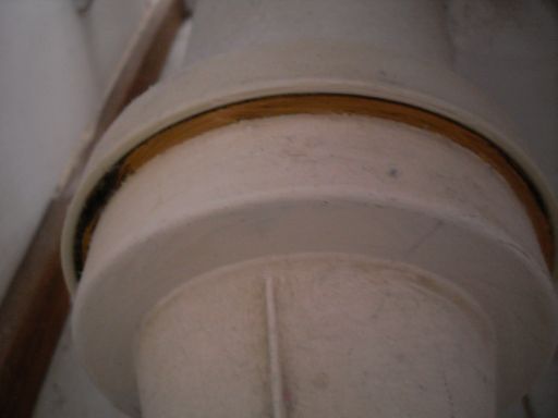

hi i have drip leak from my toilet pvc pipe to the wall
can put sealent or putty over it
see images
Hello @workman
I'm afraid at this point in time, I suggest engaging the services of a registered plumber. Using a wax sealer isn't going to be enough to stop the leak. Generally speaking, the toilet pan must be removed in order to swap out the broken rubber seal with a new one.

cheers but i think this is a wax seal

Unfortunately, the only wax seal that the store has is the Fluidmaster Universal Wax Pan Seal and it does not look the same as the one on your photo. I suggest double checking before purchasing any spare parts.
Hello @workman your toilet design looks similar to ours which developed an ever so slight drip leak, on disassembly it was found the rubber seal couldn't be removed with any finagling because the outlet pipe was too far inserted into the toilet pan (note the uneven gap around the seal), as I didn't want to either remove the pan itself OR replace the PVC outlet pipe I went with plan B
Thoroughly cleaned all porcelain & PVC surfaces completely removing all seal debris, rotated the seal 180° to place the most pristine section of the seal at the base of the joint and then proceeded to reinforce the seal and outer coupling cover with a bead of Monarch's finest silicone sealant (using thier mini caulking gun)... no leaks since.
Whilst you may have more success replacing the seal, if unable to source an appropriate wax seal a mini caulking gun & silicone would help you re-seal that coupling.

hi cheers for your advice on my photo it shows an orange colour
is that wax did you have to scrape that out
Let me tag @DIYGnome to make them aware of your question. If I recall they only mentioned that the porcelain and PVC pipes were thoroughly cleaned before the silicone was applied. There was no mention of the seal being removed. I only suggest that once the area is totally clean make sure that it is dry before you apply the silicone seal.
Hello @workman, yes I completely disassembled the PVC coupling (mine had been previously sealed with silicone) as I had every intention of replacing the rubber seal, the outer PVC coupling ring is an interference fit and will require twisting/pulling force to release, picking away at that hardened wax seal will reduce effort required, it was only on disassembly I discovered the outlet pipe was too far recessed into the Porcelain outlet recess that I changed tact. If you can remove & replace the seal that would be best practice, negating that rotate the seal 180° so as to place the most pristine section of the seal at the base of the joint. The Porcelain & PVC joint will require all debris to be completely removed or the silicone will be compromised and likely leak again.BTW it's worth emptying the cistern and shutting off the refill tap to avoid a potential accidental flush.

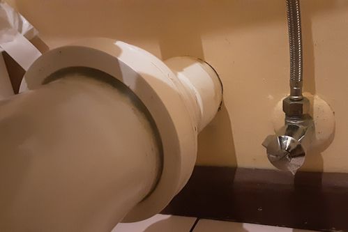

Hi Eric i made a mistake i put silicone left but its not coming from there itscoming from the back right see pixcan i use Fluidmaster Universal Wax Pan Seal to stuff it in there or is it this one see pixotherwise its going to take heaps of silicone to plug itwhat do you think
Hello @workman I am sorry I wasn't clearer, applying silicone to just one side of the coupler ring is only doing half the job, a seal can only be achieved with 100% coverage.
hi Eric you wanted an update silicone applied to both sides seems to be working
