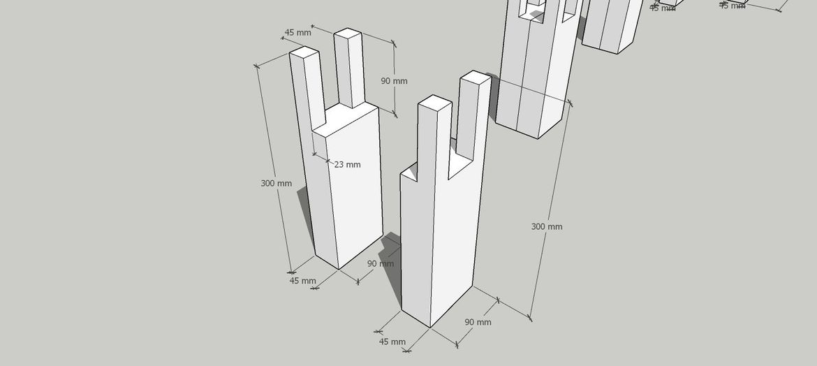

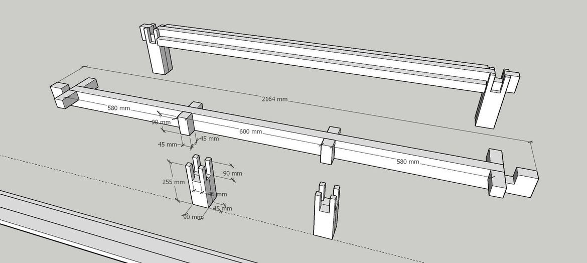

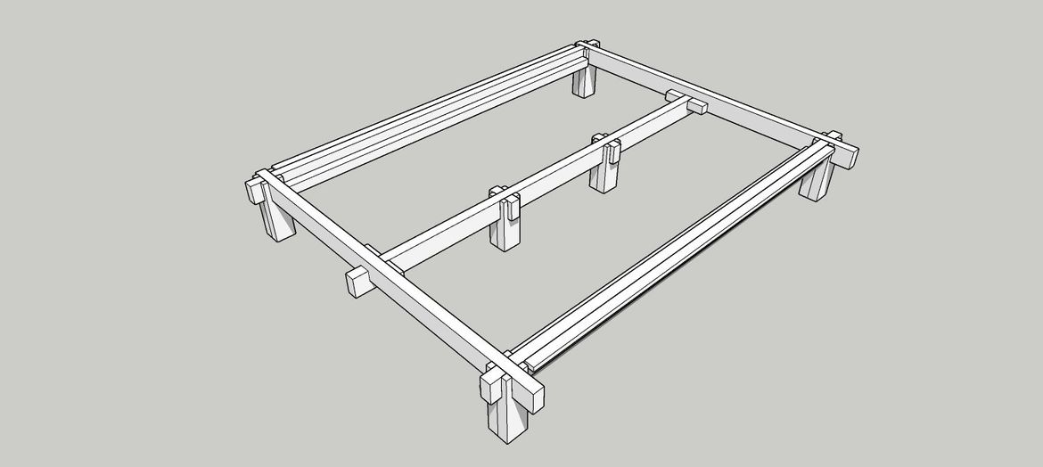

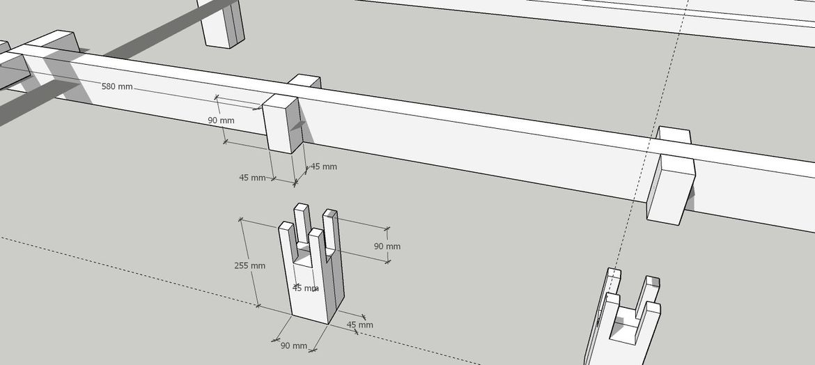

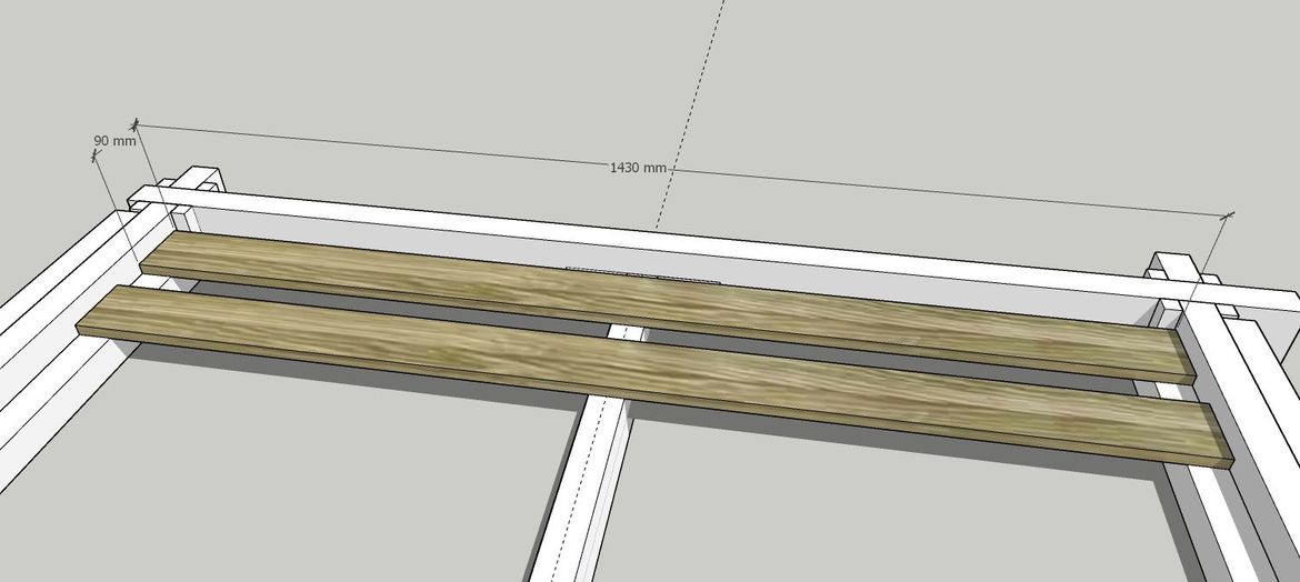

Hello @echopepper18
If you are keen to build the Queen-sized D.I.Y. bed using castle joinery by @prashantpd. Please give me a few days to draw up the plans for you. Once I'm finished, I'll post it here.
Thank you for your patience.
My apologies for the delay in drawing up the plans. The castle joinery is a bit tricky, and I made the measurements to be exact. In real world applications it will be necessary for you to add 2mm for the cut space otherwise the timber once slotted together will lock itself in place and will be extremely difficult to take apart. You'll notice this once you start assembling the corners of the bed frame.
Please note, it is extremely important that you measure your Queen size mattress before you cut your timber. The size I've indicated on the length and width of the frame is based on general measurements found online. Please double check your measurements before committing to cutting the timber lengths.
