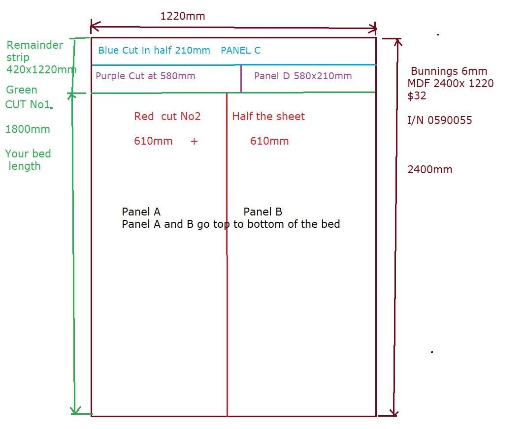

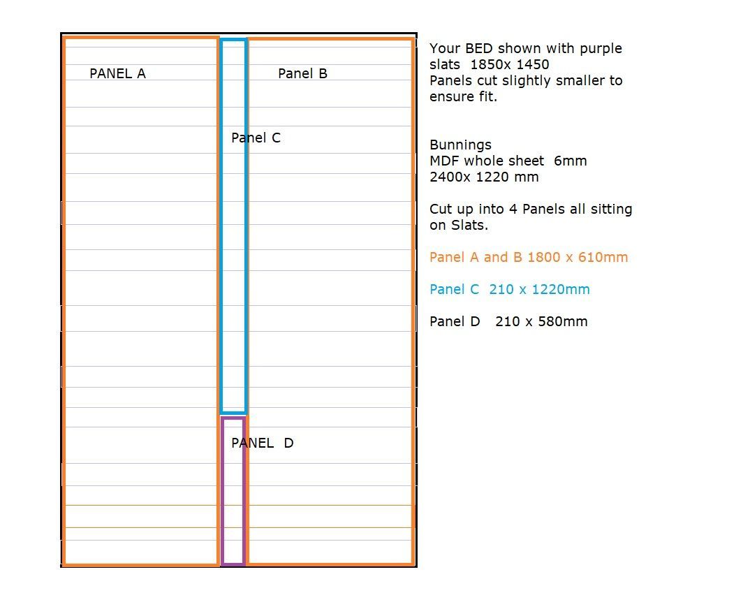

Trying to firm up a queen mattress. Slat base bed. Looking to use a solid timber, probably plywood on slats under mattress. Is waterproof the same as marine? How thick should it be? Slats are 2cm. I measured 185x145cm and allowing for ease of fit, I’m maybe looking around 165 x 125cm. Cutting in half to fit in car = 800mm x 600mm.
appreciate advice thank you.
