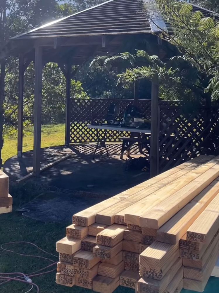

Step 1

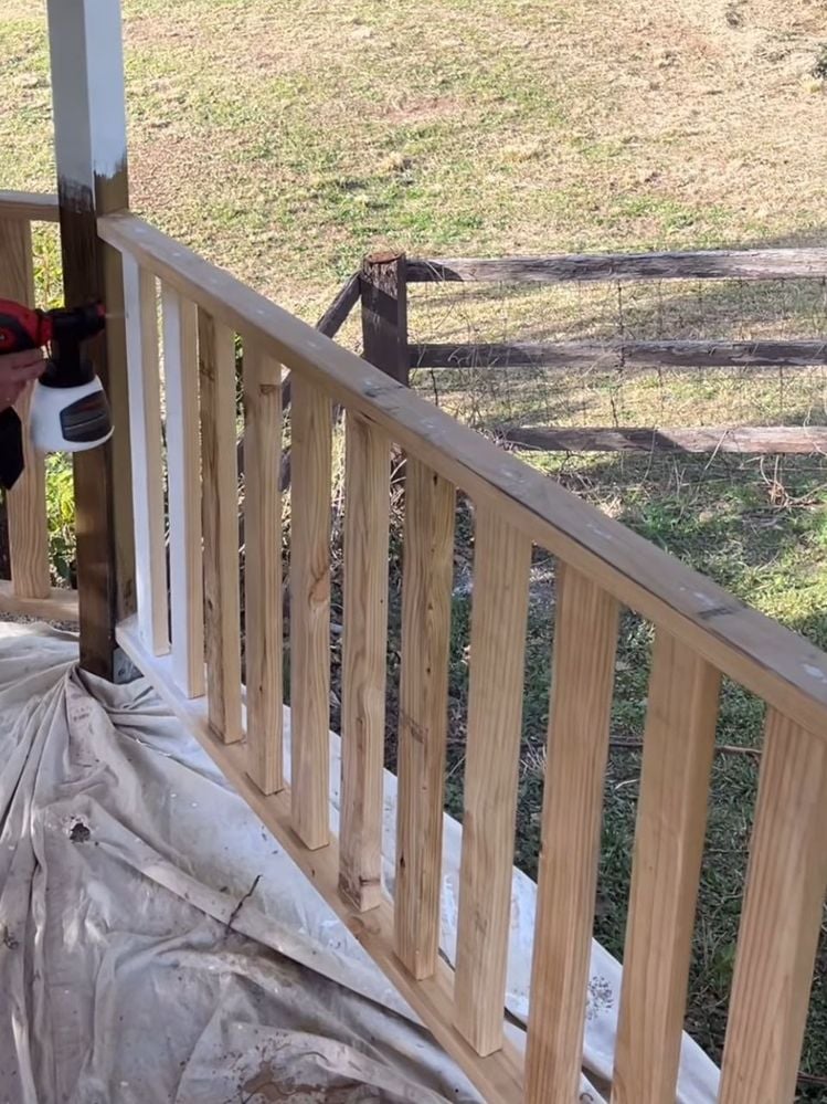

Remove sidings and brace the existing structure. Measure and cut/mitre lengths for top and bottom edges, and individual railings. Keep in mind Australian Standards for minimum heights for child safety.

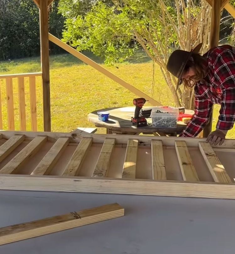

Step 2
Using a nail gun, slowly assemble the rails using packers beneath to make sure they're evenly placed/centred.

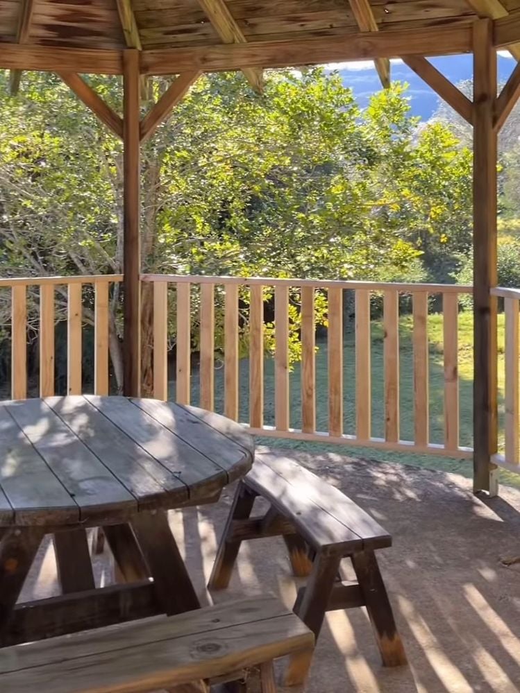

Step 3
Place each railing in its new spot and reinforce the structure at the beams so they're super strong to lean on.

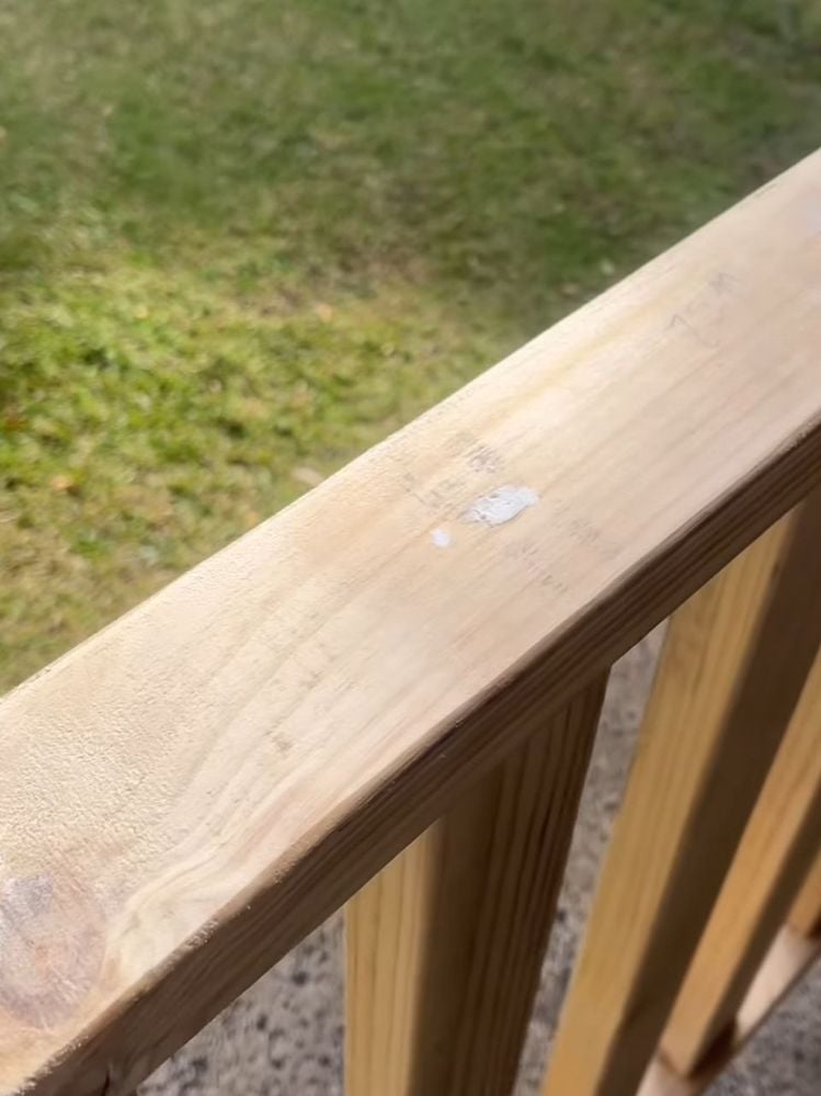

Step 4
Use the Spakfilla on the nail holes, let it dry, sand it back and then dust off before painting.

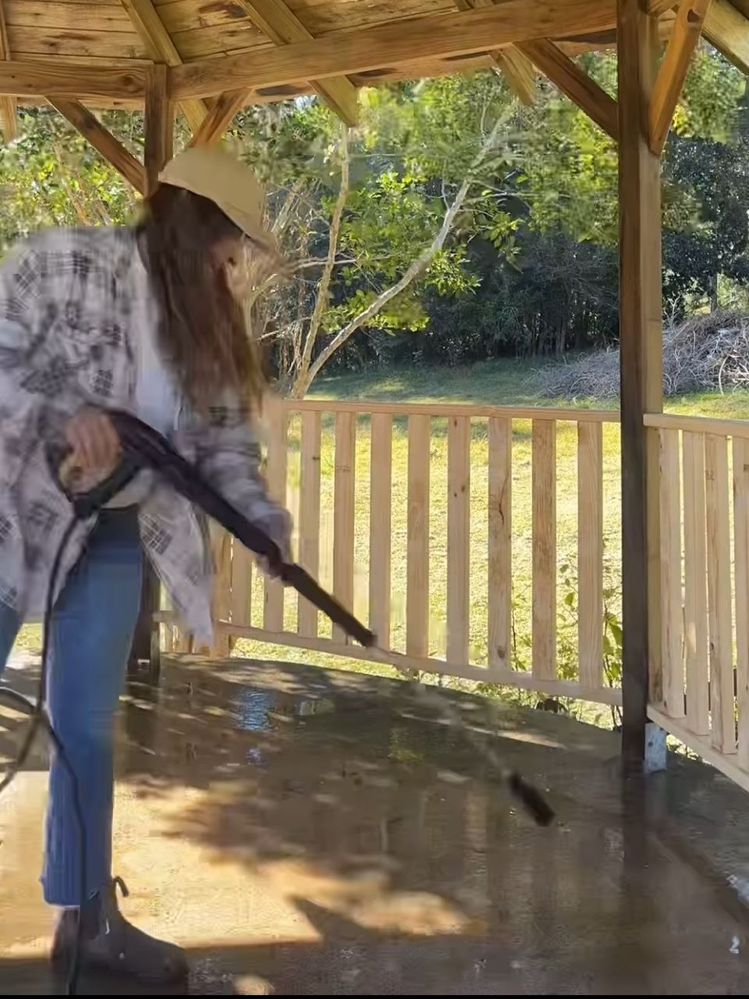

Step 5

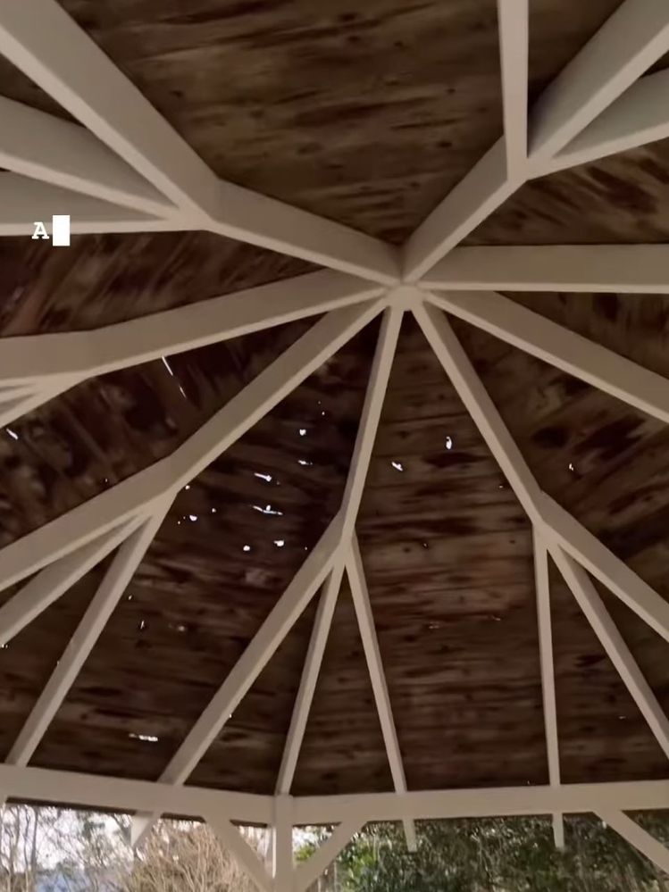

We gave everything a good clean with the water blaster and let it dry for a week before sealing. This ensured the paint was going onto a totally clean surface, free from the grime that had built up over the years.

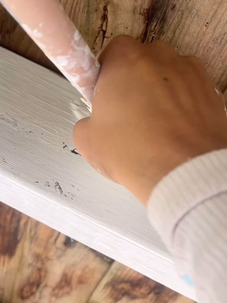

Step 6
We carefully painted the beams on our vaulted ceiling as we wanted the height of our structure to "pop". This took three weekends and requires a steady hand (or a lot of masking).
Step 7
To make light work of the balustrade, we used a spray gun. We wore coveralls and chose a non-windy day to minimise drift. We tried for two to three coats.

Step 9
We used a scaffold to reach the heights of our vaulted ceiling, and a tiny brush to get in between the joins. It was a labour of love.
Step 10
We installed our festoon lights with tack nails and hung them on an angle which really added to the "festive" feeling in the space. It also made the beams glow and made the cables look pretty and not obvious hanging directly in front of the beams.
